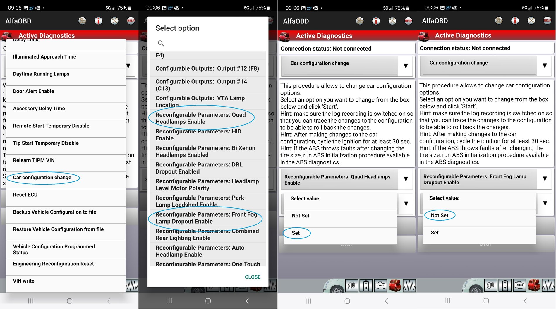

I have recently purchase the Alpha OBD software. I would like to enable the fog lights with the high beam lights.
Is this possible on a 2009 3rd Gen truck?
I searched the software over and over and could not find it.
Any hints on where to look and the proceedure?

I was able to do it on my '06. I will check this evening and let you know if you haven't received another response. Under body computer option somewhere IIRC.

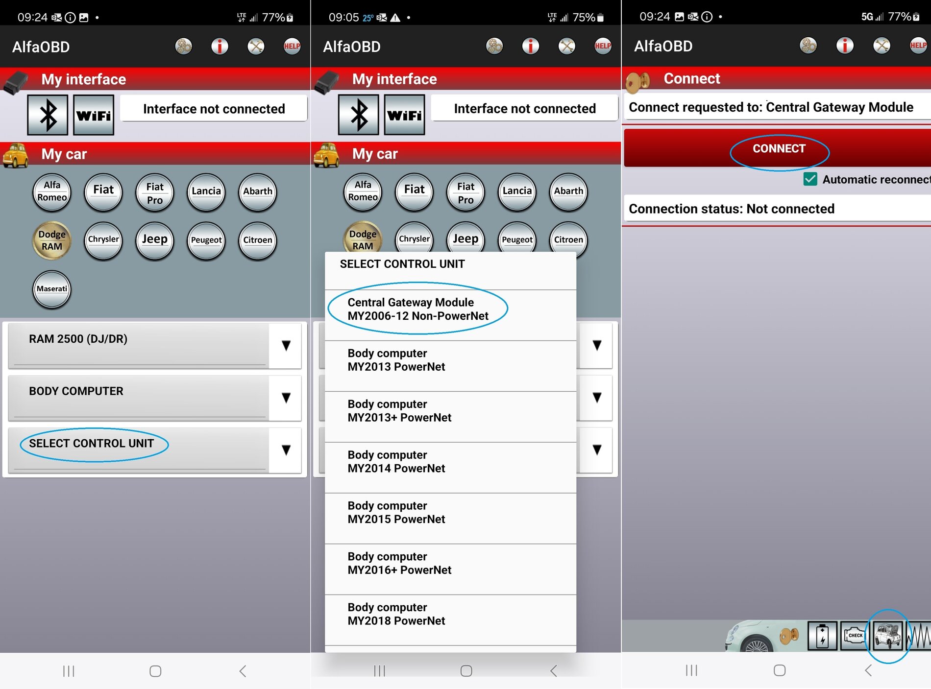

@crispyboy, Select your vehicle, body control and central powernet. Then go to car configuration change, then look for Reconfigurable Parameters: Front Fog Lamp Dropout Enable. You can dry run what you want to do without connecting to the truck. Just make choices on the first page and then touch hood up icon. Post up any issues so that we can help you figure it out. Good luck.

No need to purchase a BRITE BOX since he already has AlfaOBD. High+Low+Fogs without adding anything to the wiring is a big win IMHO!

Here ya go!
By golly it worked!
Thank you so much for the help.
