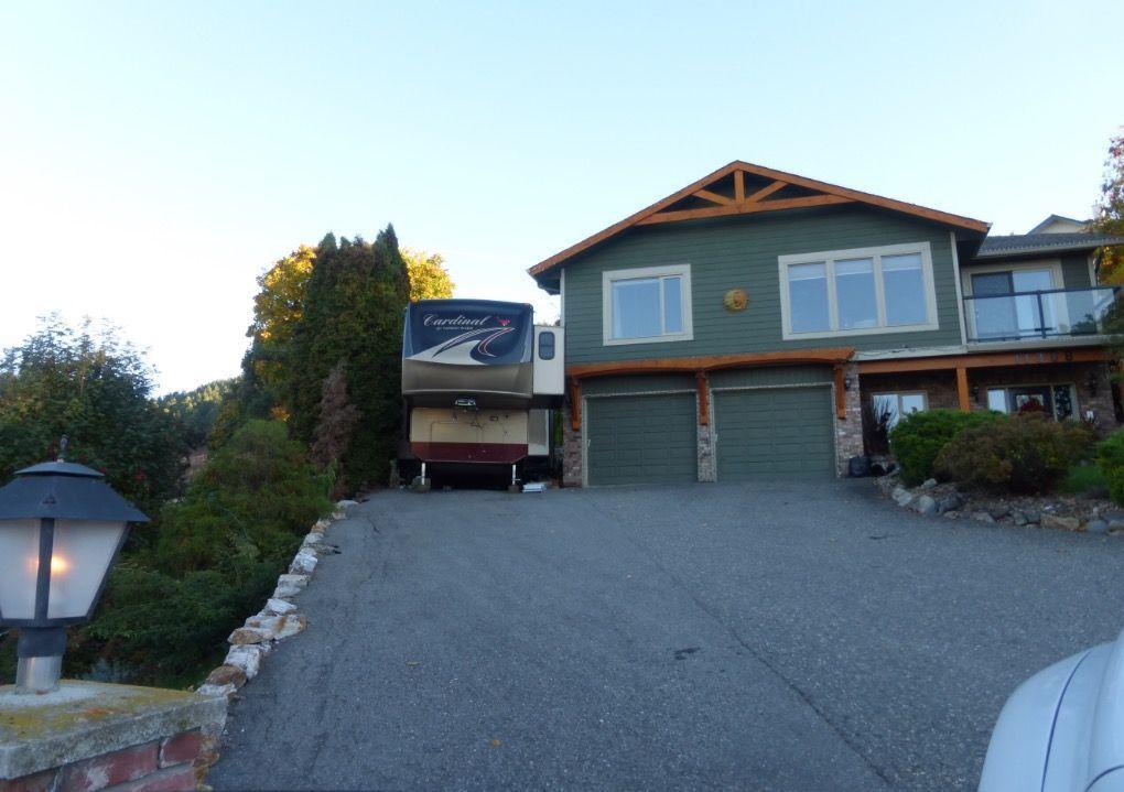

I assume you have a newer truck than the one in your signature? If so, it holds for me on a slight incline, but it needs to be turned on in the EVIC. It also works both in forward and reverse. For example, my driveway is so steep I need to use 4wd to back up my driveway when it rains. It's also so steep when I back down my driveway my hitch draw bar will actually hit the concrete where it levels out. Anyway, in this driveway, even when hooked up to my trailer, the hill assist will hold when I let the foot off the brake.

She's a steep one! I'm keeping it off.
It doesn't stay on, it's only on for a few seconds. I would think you'd love having it for a driveway like that.
