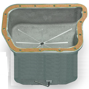

I run the extra 3 gallon pan..... this way I'm all set for a while. Just have to watch for those low curbs.
