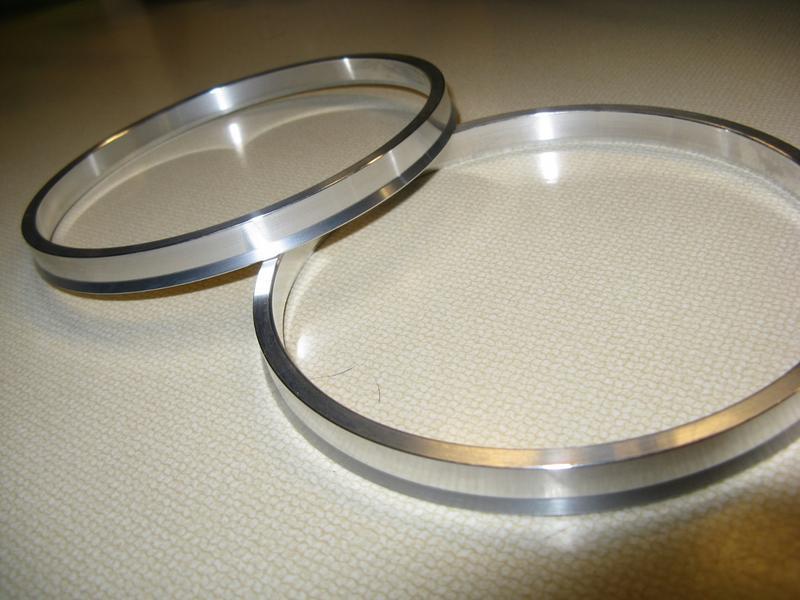

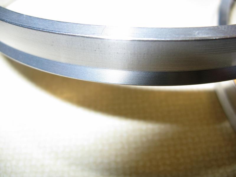

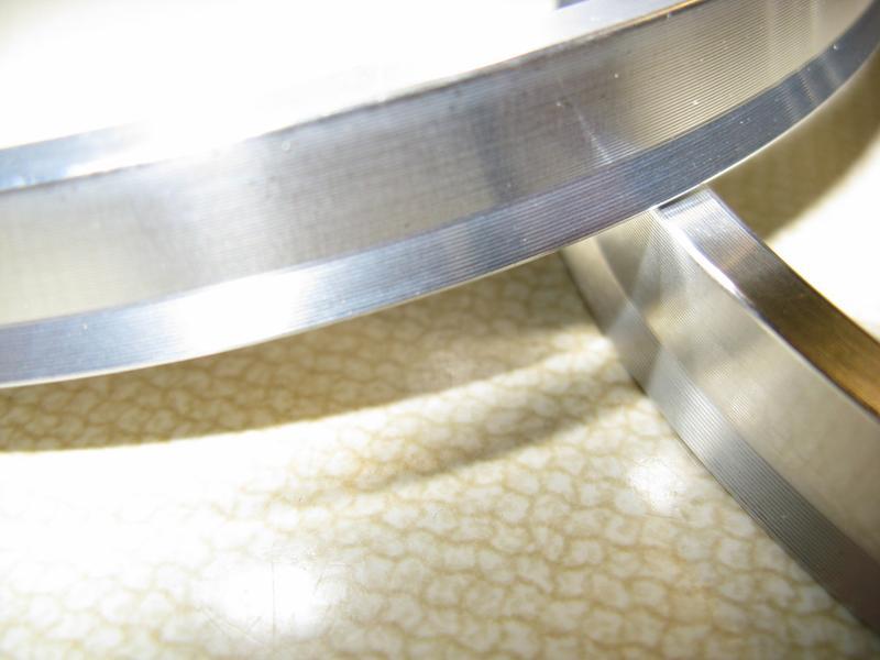

seafish, I DID get the rings but I haven't got them on yet. I am going to exchange the chrome rims for the same pattern but polished. I went with the INSIDE diameter that Motorsport Tech had on their site for the AAM which is the same for the fronts too. I measured the ID of the wheels and sent them that measurement. I also have my Dads old Logan lathe if I need to do any small removal off of the OD of the rings. The guy did a beautiful job!
Those look nice...I'm going to order me some...how long did they take to get em done?
Motorsport Tech listed 121.30 mm for the Dodge AAM hubs, now I just need to measure my Ricksons...
seafish, I happened to get my order right when they were making a "Run" of rings. I think it took a few weeks. I would find someone with an INSIDE micrometer to accurately measure the Ricksons. I would measure each wheel. I can say for SURE that when I had the tire store first mount the tires and wheels, I had a light bumpy ride. When I got home, I jacked one wheel at a time, loosened all of the lugs and very carefully retightened ther torqued the wheels back on. This was done BEFORE I had the rings made. Smooth ride thereafter. I guess what I am saying is that even though the wheel manufacturers say that being hub centered isn't necessary, I think that they are wrong. I believe that the Ricksons are 5.15" ID but don't hold me to that. You want the rings to press fit the wheels and have a SNUG-SLIDE fit on the ID of the wheel to the hub.
