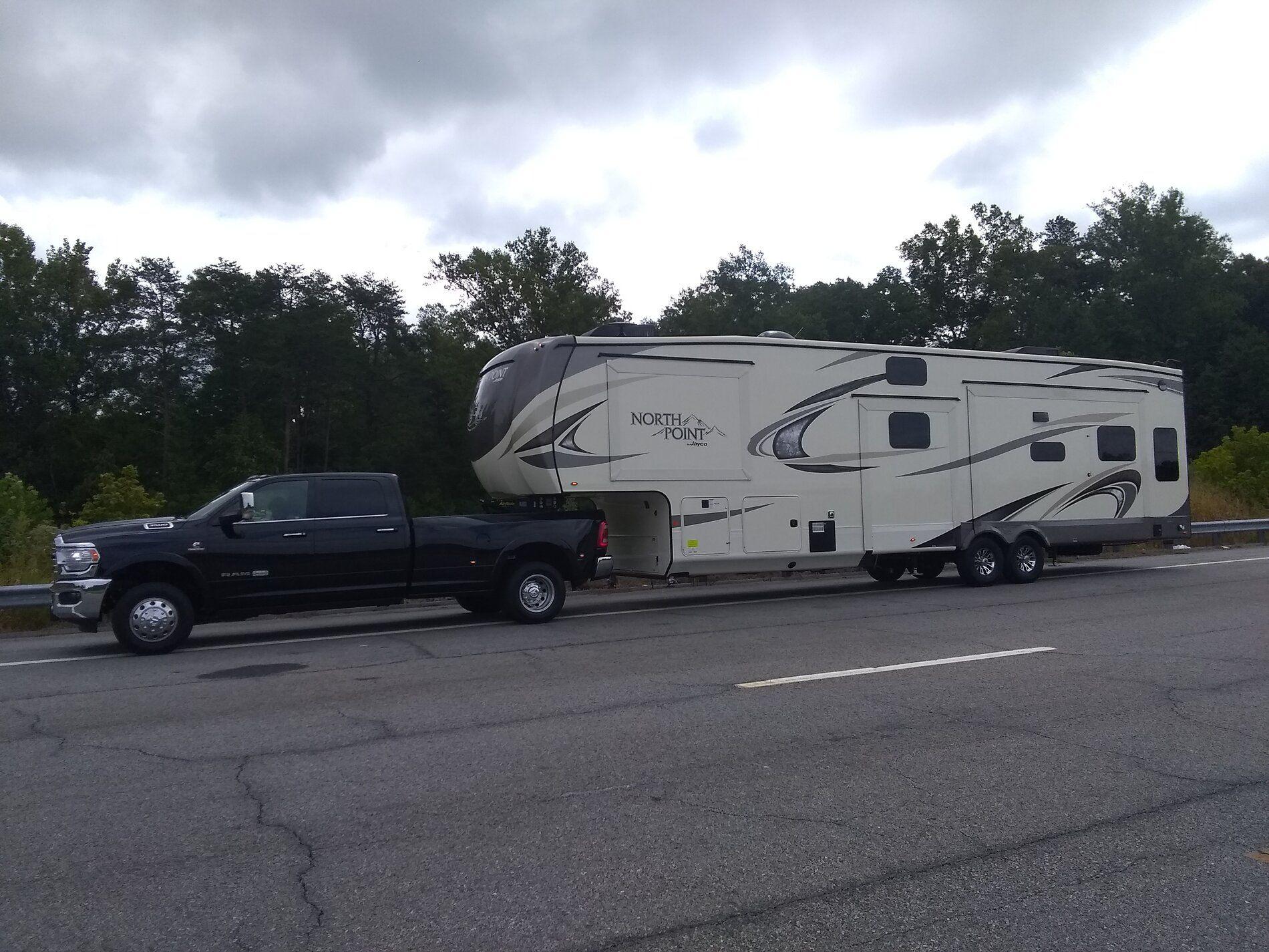

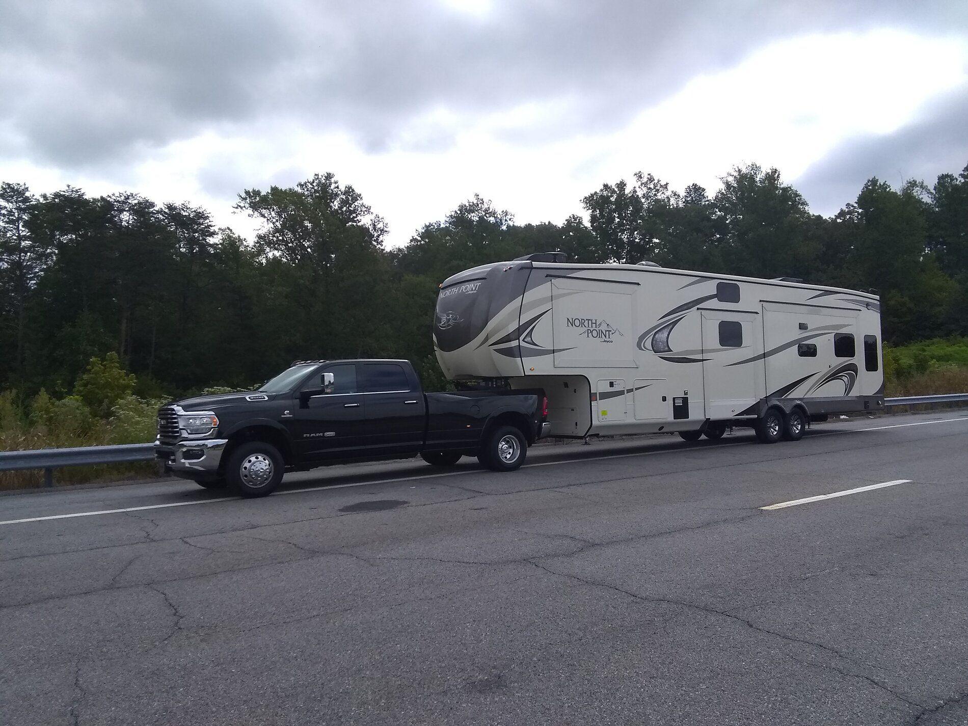

okay guys here you go here is the combination the truck and the trailer in front of my house well down the block from my house at the local weigh scale area that's not being used right now all right guys check it out here's a couple pictures thanks Stuart
