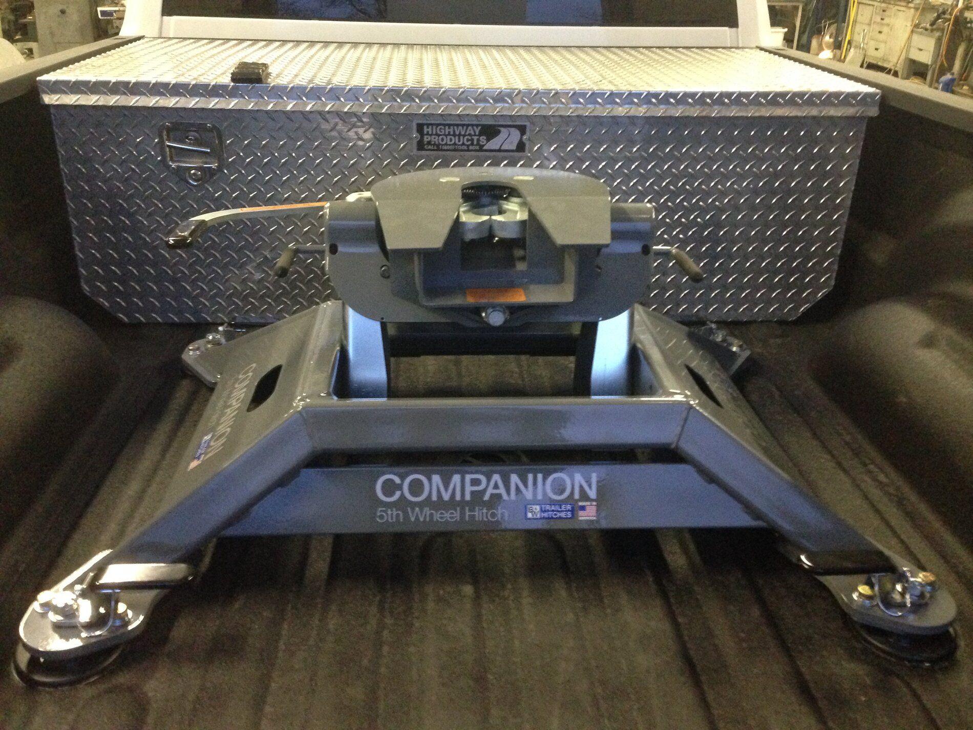

I haven't the need for such a device, my B&W companion 5th wheel hitch works great and I don't get the slop attributed to cheap hitches. I suspect it will be even better with the new base for the puck system using the same Campanion hitch. I can't wait, but it will be awhile before I pull the 5ver any long distance.

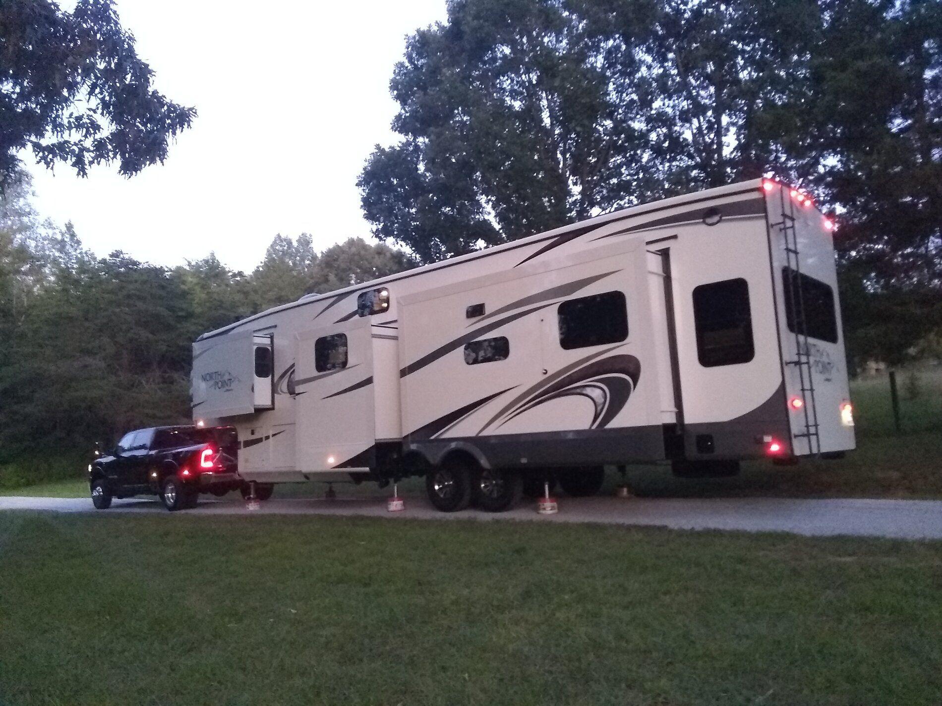

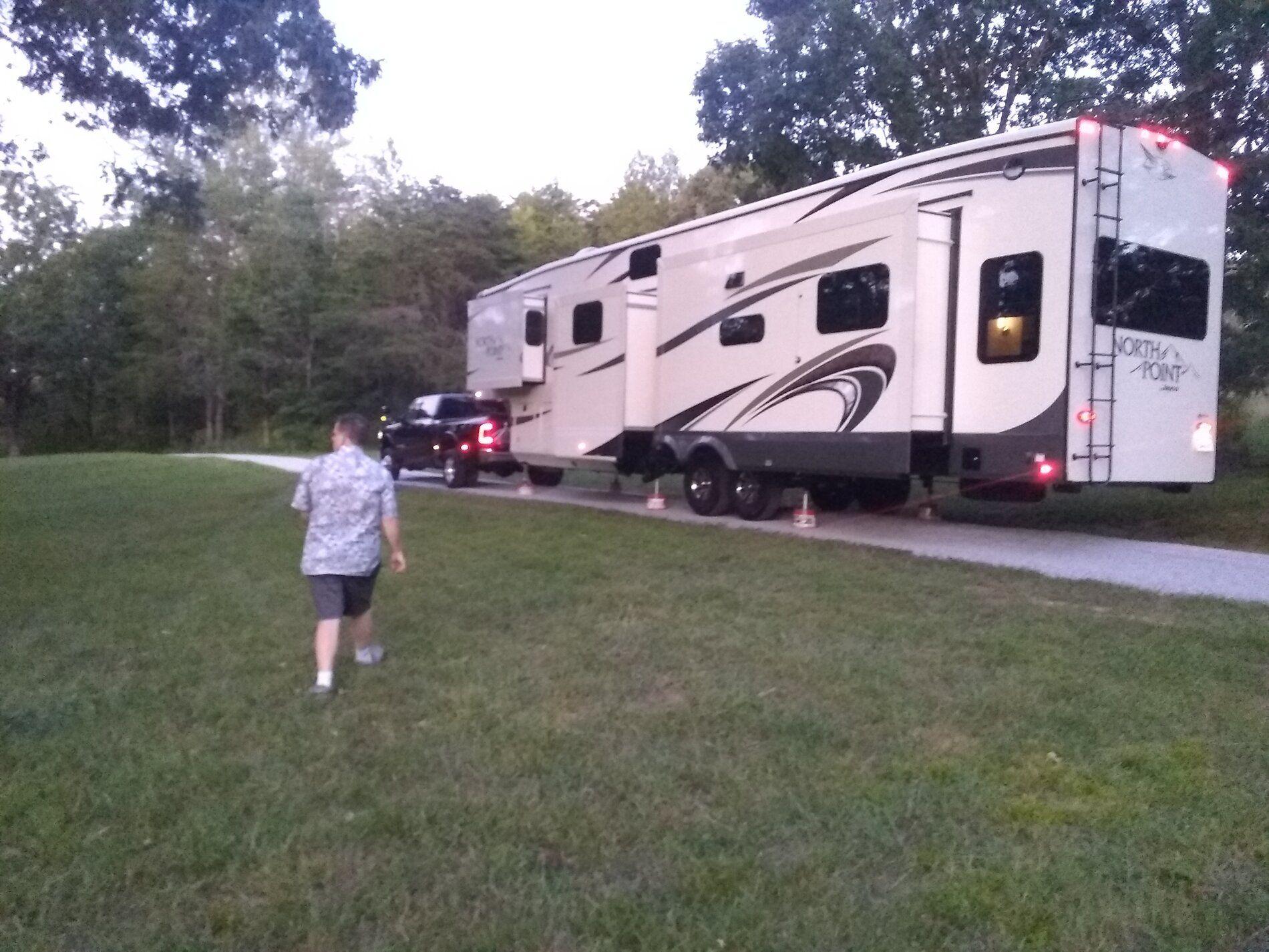

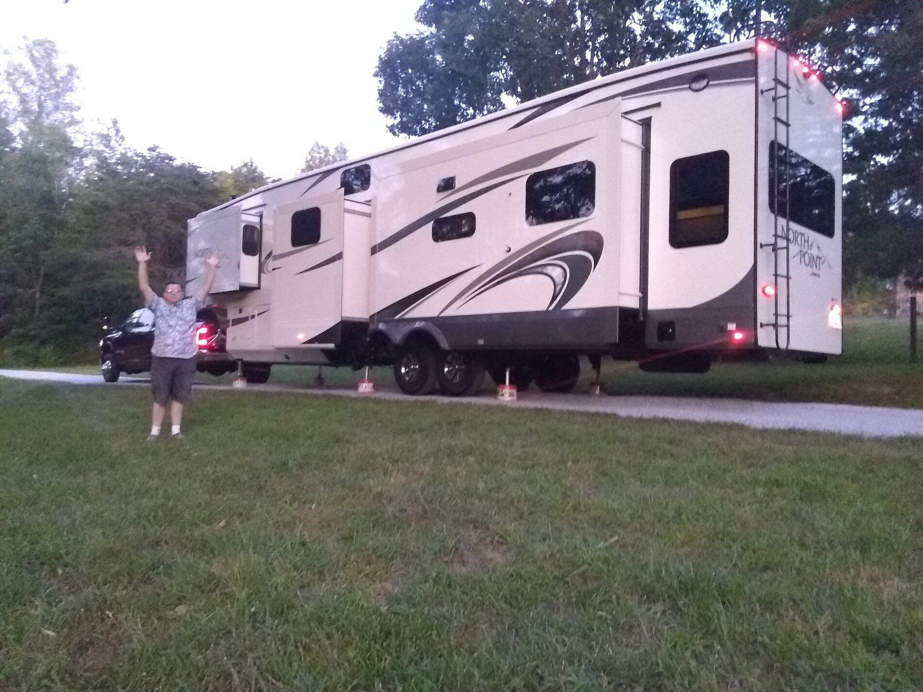

I wanted to show you guys a picture of the alternative ride height on the Dodge with the 377rlbh on the back yes this is the alternate ride height look at the picture nice and level goes good and I actually wrote it today about 18 miles that way and it felt pretty good so all his worked out everything is good guys no problems so we can use either or as a way to ride.
I just wanted to show you guys okay here's the unit all leveled out with the trailer jack blocks under each of the landing gear and I'm here on our property and they just wanted to show a little bit guys and yeah everything's working out pretty good so here you go.
