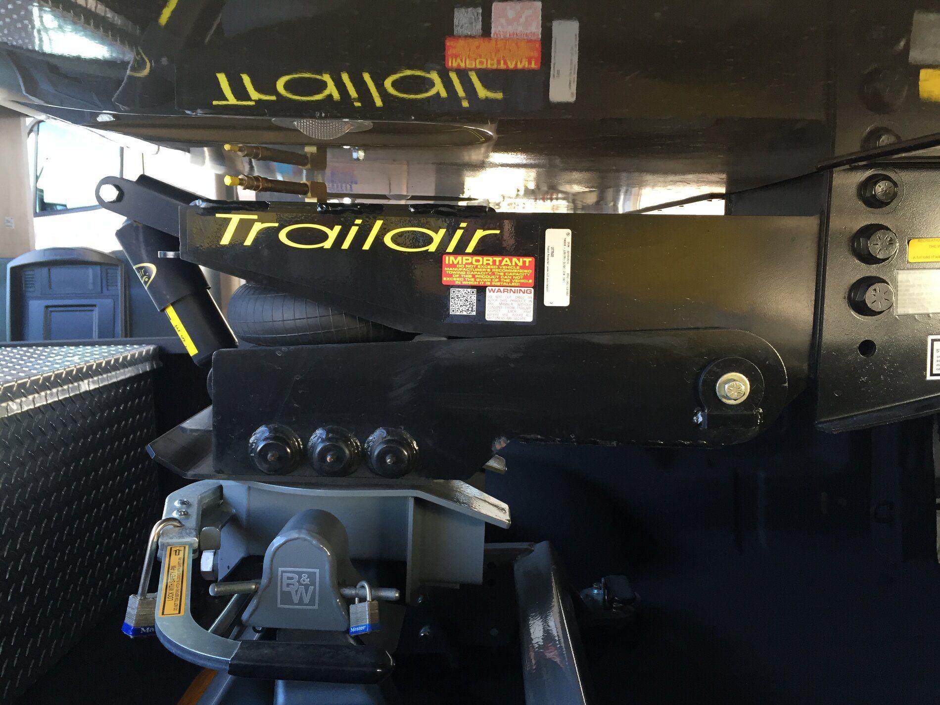

I tow very heavy with my truck pulling a 34RL Cedar Creek using a Trailair pin box. This is my second trailer with a Trailair pin box. I love them since they eliminate a lot of the bounc on the roads when you tow. I would estimate about 90 to 95% of the harshness of the rough roads as the trailer is towed.
I would Air your bag up in the Trailair pin box so, the shock is even with the top of the line on the bottom of the shock. Marked by arrow tip. This is the correct ride height for the Trailair pin box to eliminate the bouncing you will feel in the truck. The air pressure could be as high as 100 PSI I know my bag is close to 95 PSI air pressure in the bag.
Now the Trailair pin box will do nothing for chucking that can occur between the king pin and the slop around the hitch jaws. When I changed my hitch to a Demco Glide Autoslider hitch the slop between hitch jaws was eliminated. This is do to the design feature of having a tight fitting hitch jaws around the king pin to work with the sliding feature of the hitch. Thus no chucking occurs.
If you have any slop in the king pin joint you will get chucking which can be volient in some trucks.
I believe the Anderson hitch that you have has introduced slop in two places one at the device that attaches to your kin pin. Than this device again when connected to the ball on the Anderson hitch is also introducing some more slop. This is accentuated by the height of the Anderson hitch ball on the hitch.
The Morryde king pin box may work for chucking but will do nothing for the bouncing that can occur.
If you are determined to replace your current Trailair pin box I would look at the Trailair Flex Air pin box rated for the 18,000 lbs trailer.

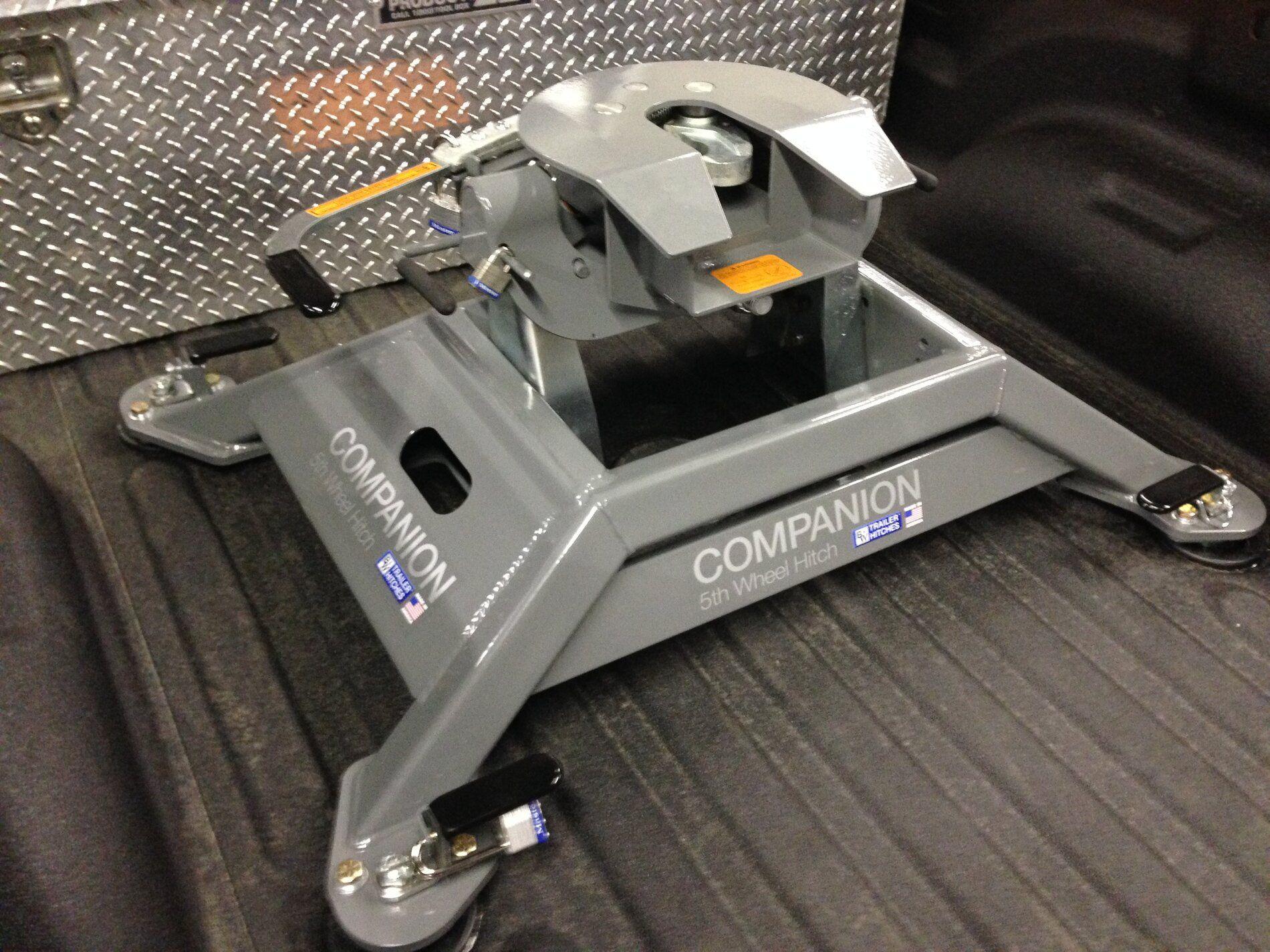

It looks like its an inch or two behind the center of the axle but thats the way the Andersen works, if I were do this over again I would go for a BW COMPANION and the Flexair but for me to do that now would cost almost 2500 bucks more and have a fight with the rv dealership.

Nothing wrong with your TrailAir pin box. One can argue your ANDERSEN is moving fore and aft as they do. Get the pin ahead of the center of rear axle especially when you have a long bed.

Is that the Trailair that slides forward and backward kind of like the Moreride I think it was called the TRIGLIDE????? the regular Flexair does not have the three bolts on the bottom, or I may have missed them???

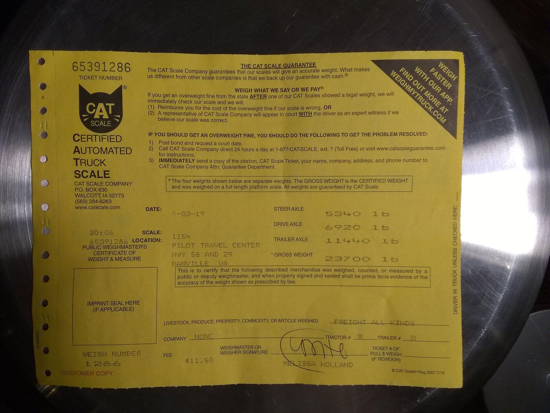

okay guys I've got it here here's the weight scale ticket with a full tank of fuel and full deaf and me and my wife and not much in the truck or the trailer but okay here's the basic wait right here without any tanks full of whatever or water or gray tank or black tank or freshwater tank.

Ok so how do I make sense of the numbers guys I have no clue?????????????? but I think the SRW would have been way over weight lol.
Those numbers are well within your ratings, and yes a SRW would have gotten out of its ratings quickly. The SRW would be about 6500 on the rear axle, which doesn’t leave much room for more pin weight.
Since you don’t have a scale ticket of the truck without the trailer this is just a guess.
It appears the trailer has about 3300 lbs of pin weight, and a empty weight of closer to 14,700. It’s about 700lbs heavier than the brochure weight. With about 400 of it on the pin and 300 on the axles.

I assume your rear axle weight would have been around 3,900# so that would give you about 3k pin. So that puts you at around 20% pin.
You need to use the weight/inflation chart for your tires, look under Dual wheel. Add 5psi to what the chart calls for. Your individual tire weight is 1,730#, use that number.
