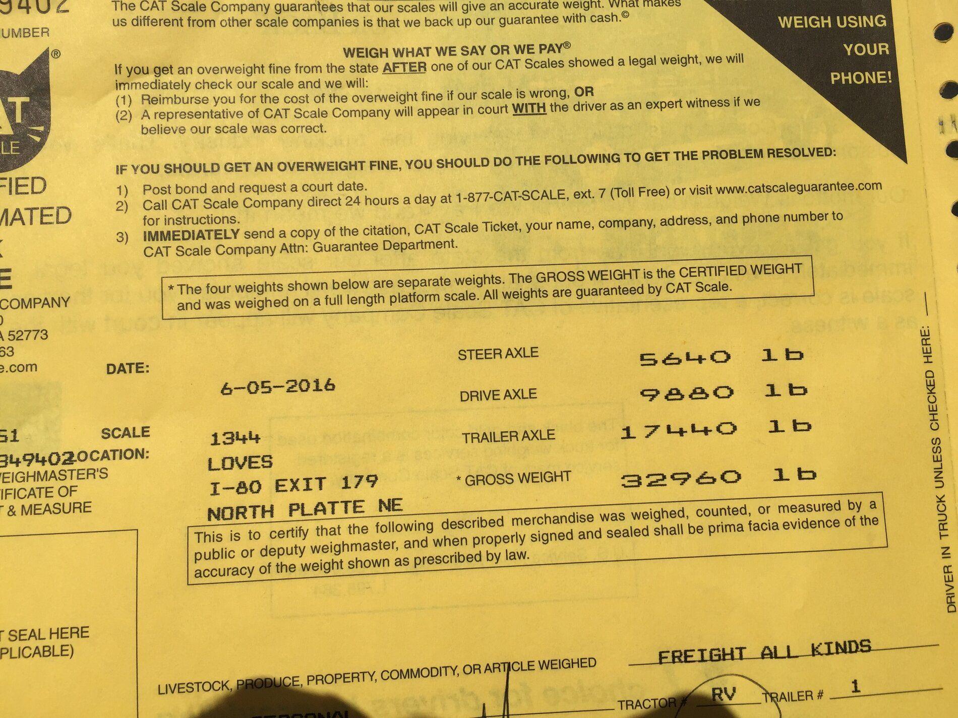

Stuart, I just pulled my 5ER to Lexington KY about 350 miles from my home. I ran the front tires at 55 PSI and they did not blow up nor did they over heat. By my IFR gun the fronts were around 70F.
I am just say use a tire load inflation chart for your tires. All the front tires need to support is the front axle weight which accordingly to your weight sheet is less than 5500LBS.
My front axle loads for my truck are under 5200 LBS. This is why I can use 55PSI for my tires!

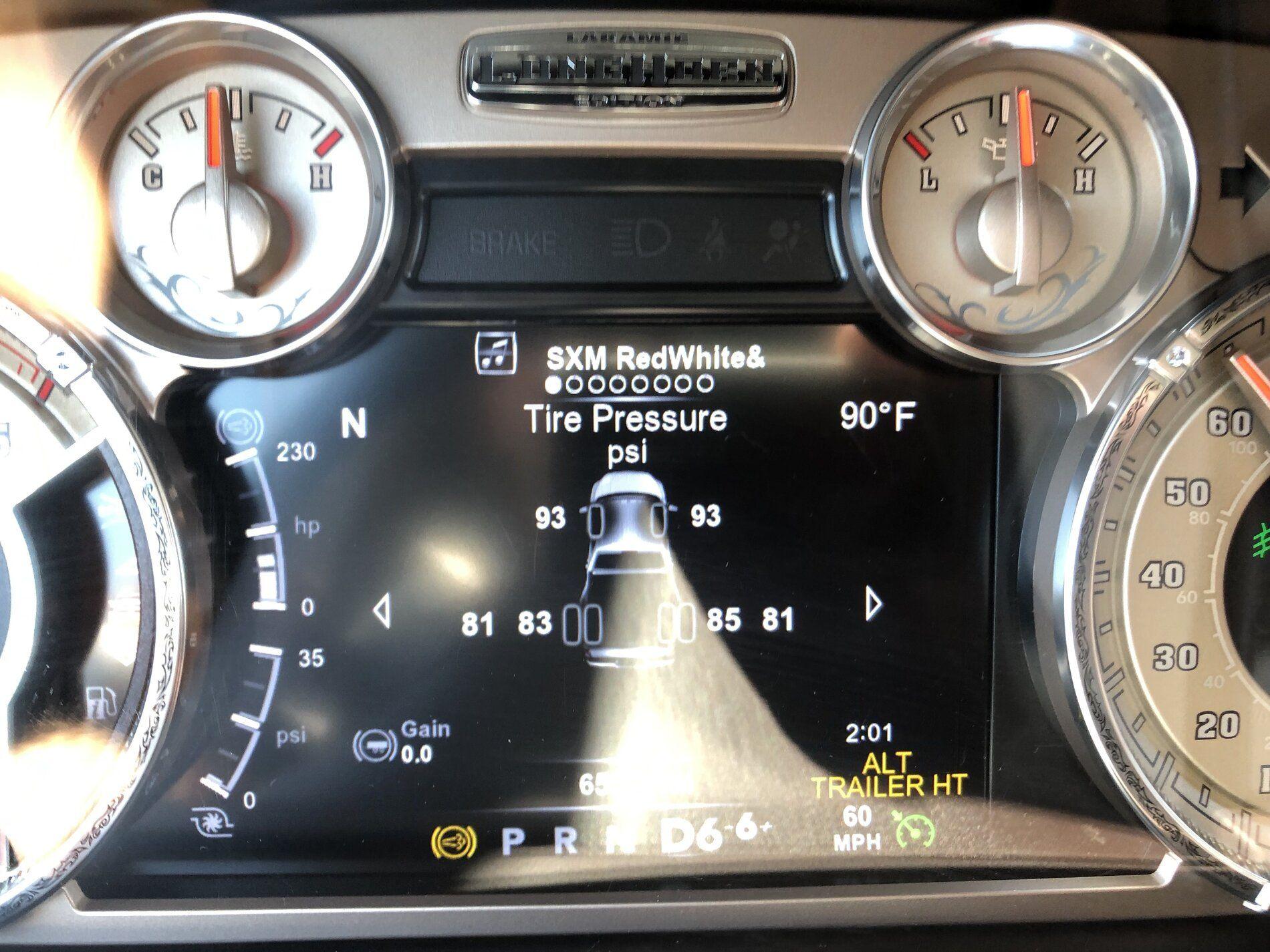

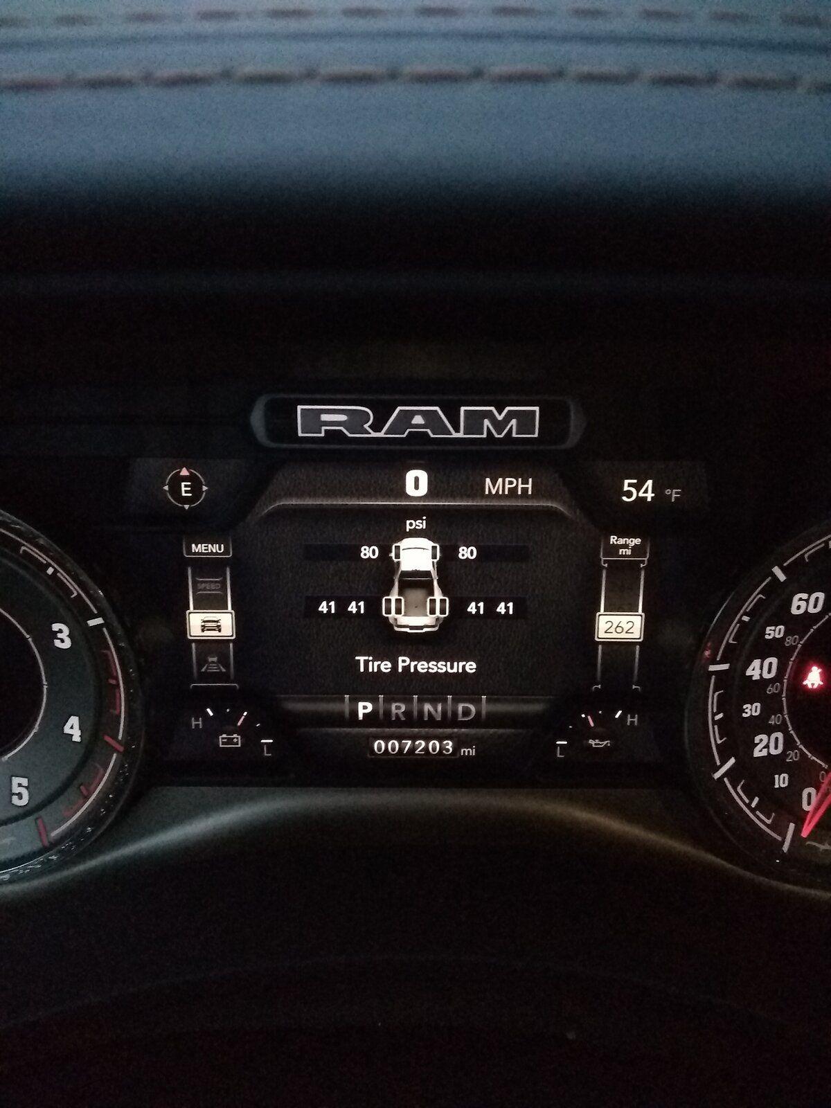

okay boys it is 7:14 a.m. the temperature is 54° and we have the front store at 80 and the rears are at 41 wow pretty consistent but yeah here's a little picture so 80 and 80 4141 4141 take a look Boise.
funny thing I remember a guy told me a few years ago when I used to run my I had a suburban a GMC suburban remember guy told me oh you can run those tires at 60 PSI if you want but he said most tires can take usually 1/3 more so if it's a Max of 100 if the tires of says a Max of 80 psi cold it means that tire can easily handle 110 so all right guys but yeah that's our little update for this morning talk to you guys later have a great day.
Get those rears to 45 and turn that display OFF!!! While traveling occasionally check the pressures and other readings. THEN you will know what "NORMAL" is.
Contact GY or another tire manufacturer and ash if what you are seeing is "NORMAL". They wILL tell young is!
