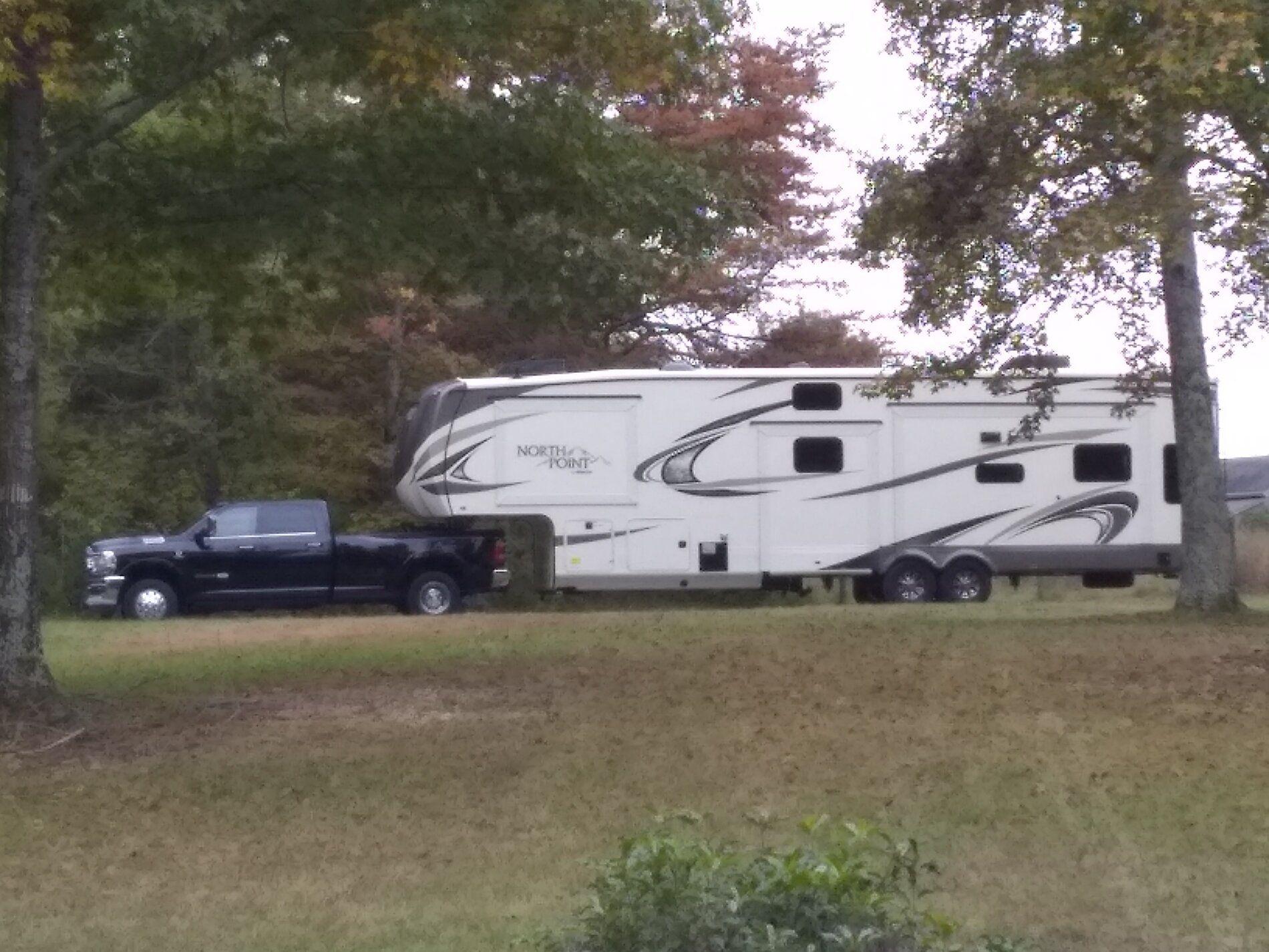

I have a very large problem guys and I'm using voice to text so if there are any mistakes so well with the truck in the RV I was on the road about five times I've had to make some very hard stops and the truck and the RV or developing a kind of a pogo wing or a bouncy kind of movement on the trailer now I'm thinking that it is the trailair PIN box bouncing down because the brakes on the RV are not strong enough now my truck has the brakes on light electric so I'm going to switch them over to heavy electric and maybe that will fix the problem or I've already made an appointment tomorrow to change to the more are not more air to mor ryde pin box mor ryde pin box to see how that works but before I do that I'm going to try the heavy electric setting on the the truck the heavy electric setting for the brakes so if you guys know anything anybody that has a 2019 when I have a trailer connected it is very very very you can't the the the brake pedal is very mushy so but I've made about for a 5 very hard stops and it develops a bouncing pattern The bouncing motion but as soon as you get off the brakes The bouncing stops and I doubt it's the anti-lock what anybody's got a 2019 please chime in on this cuz I'm at a loss for words on this one bouncing but I think it's the trail are bouncing down when I think it is I don't know I'm not sure?????????????????
Well the trailer should brake itself, should even pull the truck back.
Your sounds more like the trailer wants to over run the RAM that tries it's best to brake the trailer..
Yes I have the brakes on lite electric we shall see if putting them on the heavy electric setting helps ????????????
I don't know if they are pulling back on the truck to any extent at all?????????
Talking to you yesterday, changing to heavy electric will be your best bet. You can always try the MorRyde pin box later. My system is a little different on my 2014 ,but I still have it turned up to about as high as it will go .
Ok guys I put the setting on the Dodge 2019 I put the setting to heavy electric and I took it for a test ride this morning about 10 mi yeah what a difference it stops like a it really stops well now so it's possible that the brakes were not even really on the trailer doing that much but yeah what a difference it rides better rides better but it stops way better I had a few times where it didn't even really want to stop so yeah I guess now it's on heavy electric and I can feel that trailer pull back when the truck a little bit not that much but a little bit and the The bouncing I was feeling I guess that was caused by not much trailer braking but yeah now it's really breaking well also thanks for the tips guys and yep that's another little option that save me some money.
okay so the brakes are now set on the Dodge ram 2019 3500 are now set on heavy electric and if I wasn't making it clear in the previous post what a difference it stopped so much better it's like night and day all I can say is the difference from light electric to heavy electric is astounding it stopped so much better guys thanks for your help.:):):):):):):):)
