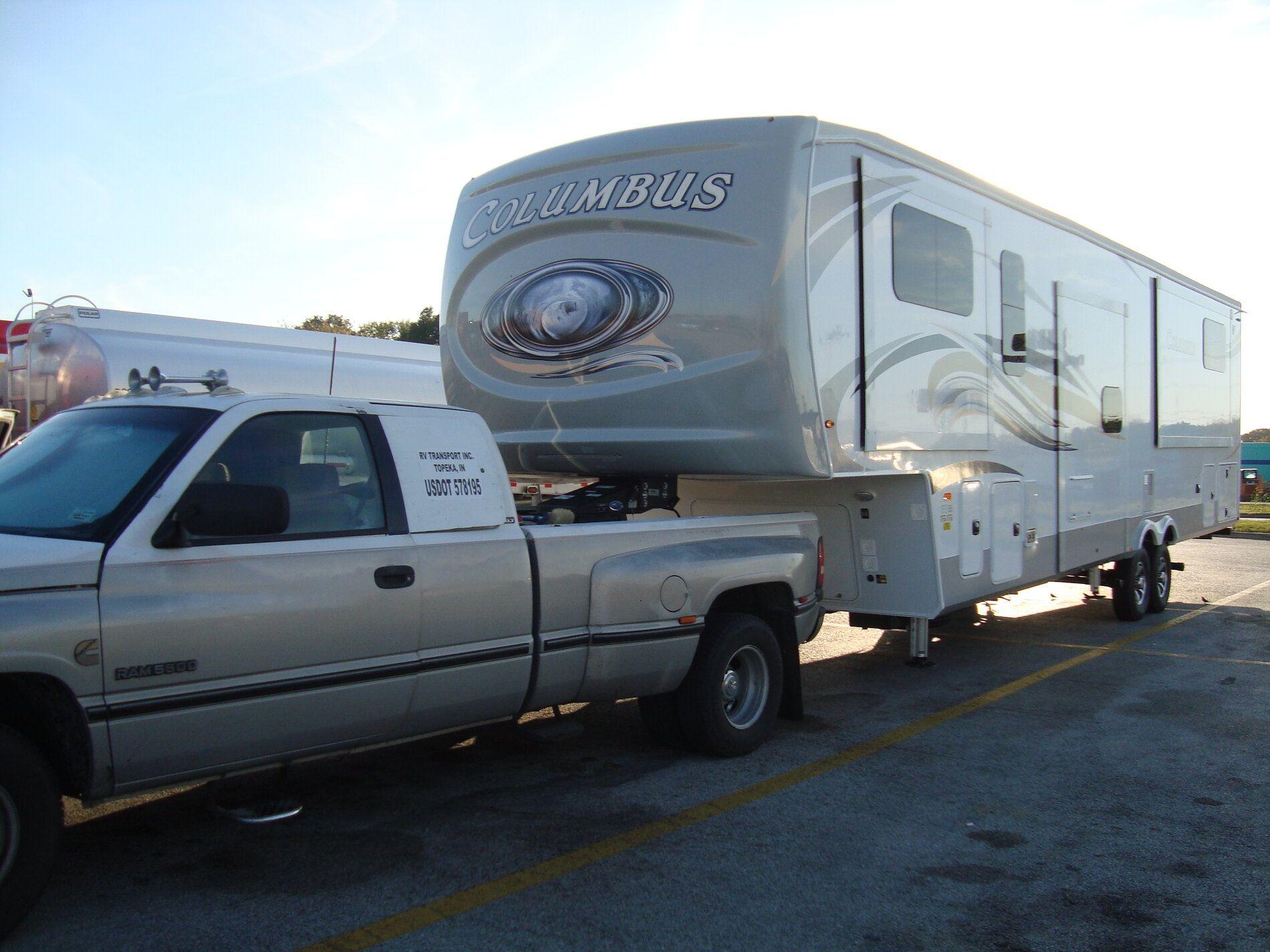

I just delivered a new 5th wheel trailer that was nose down on my standard height hitch. It's possible, depending on make and model, that the trailer will be level.
