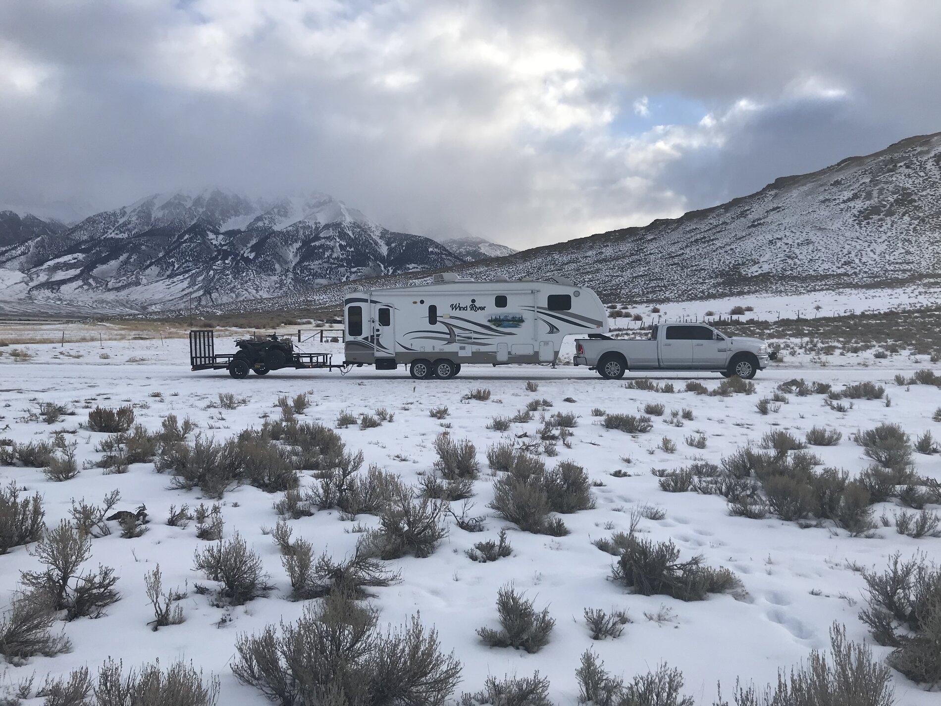

I previously stated I recommended a tandem based on my experience with a single axle......but I have since changed my mind on that. After helping my brother-in-law attach his tandem behind his 5th wheel and noticing how much more incredibly difficult it was.....I decided to stick with my lightweight single axle that I can move by myself. Not having to back up a 5th wheel, to line up with the 2nd trailer, is huge benefit. I can deal with the periodic odd handling.

I have a 5x10 side load ATV trailer (single axle, no brakes, GVW 3,000#). One thing I noticed while looking for a trailer is the base weight. A lot of "ATV" trailers are light duty flat decks and are heavy -- 1,200 - 1,500 pounds. That doesn't leave a lot of capacity for equipment. A full sized ATV is around 700-800#. Add fuel and other camping gear and you can go over the GVW. I saw a 3 ATV trailer with a base weight of 1,500#. The salesman didn't understand the problem.
My trailer is a light 500# and easy to move around.

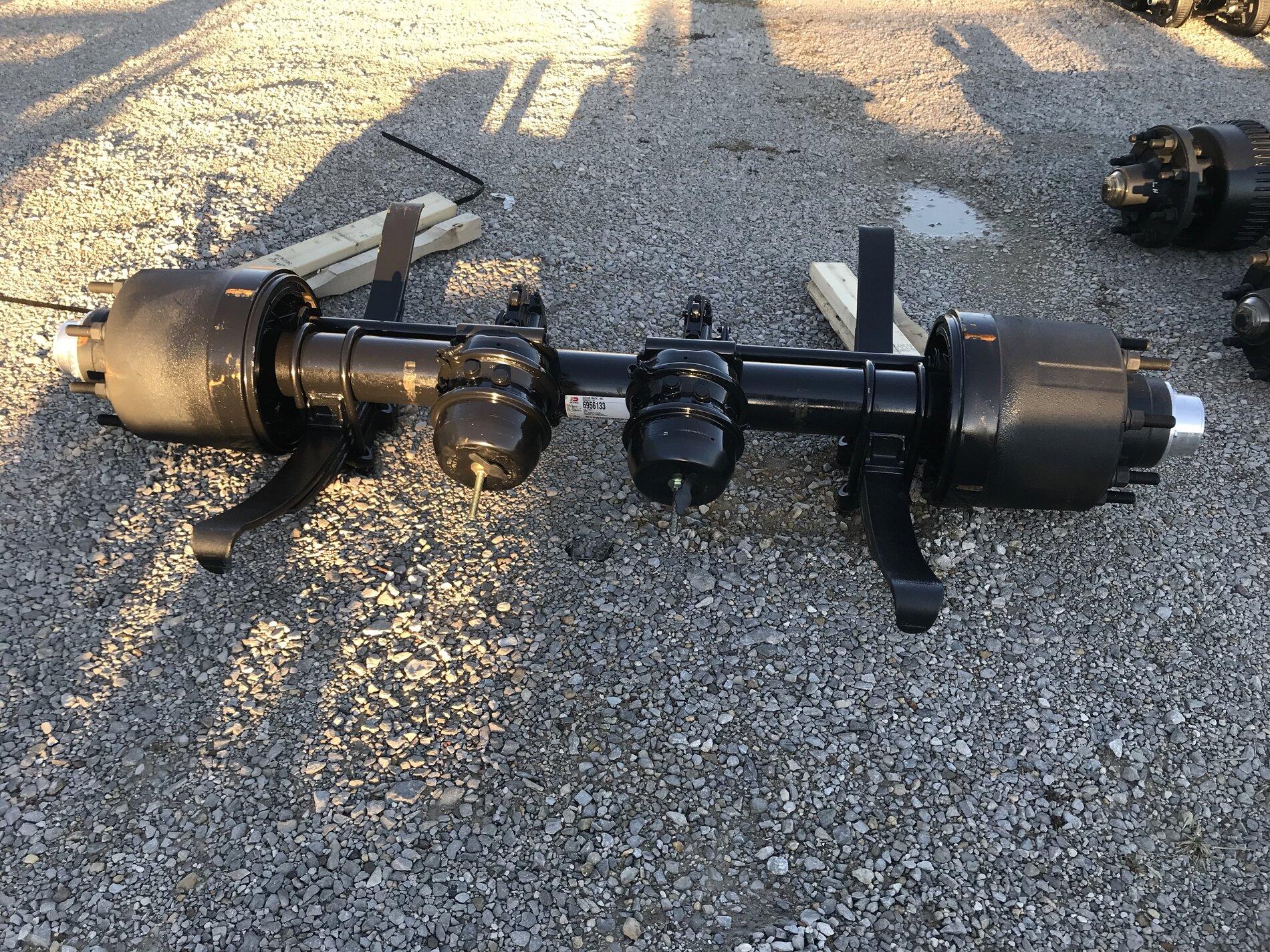

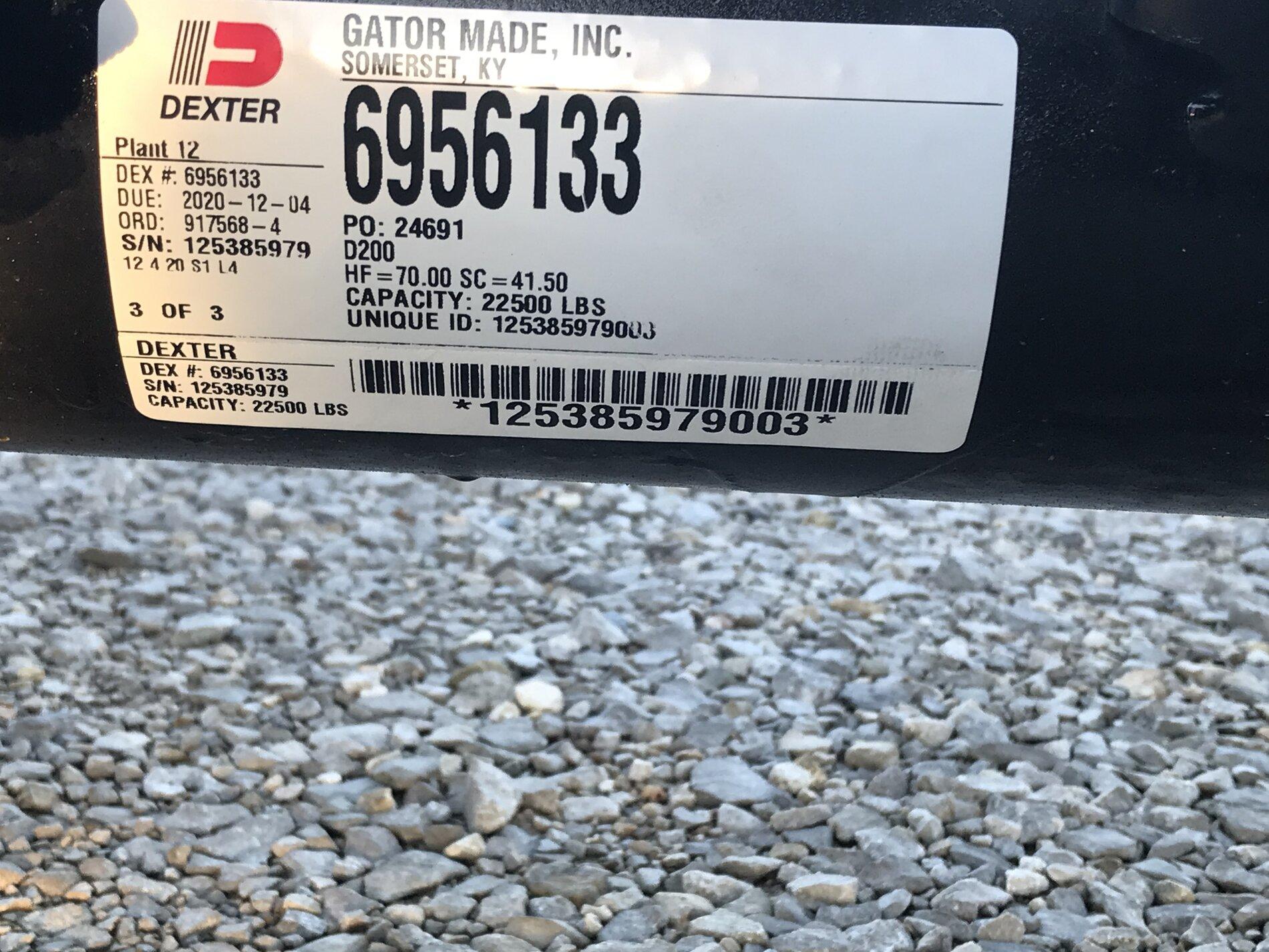

In the event you run into an issue with capacity or bending of the axle on your trailer, I found a simple solution for you in the form of a nice BOMB’ed axle. I stumbled onto this at GatorMade just a few days before Christmas.
