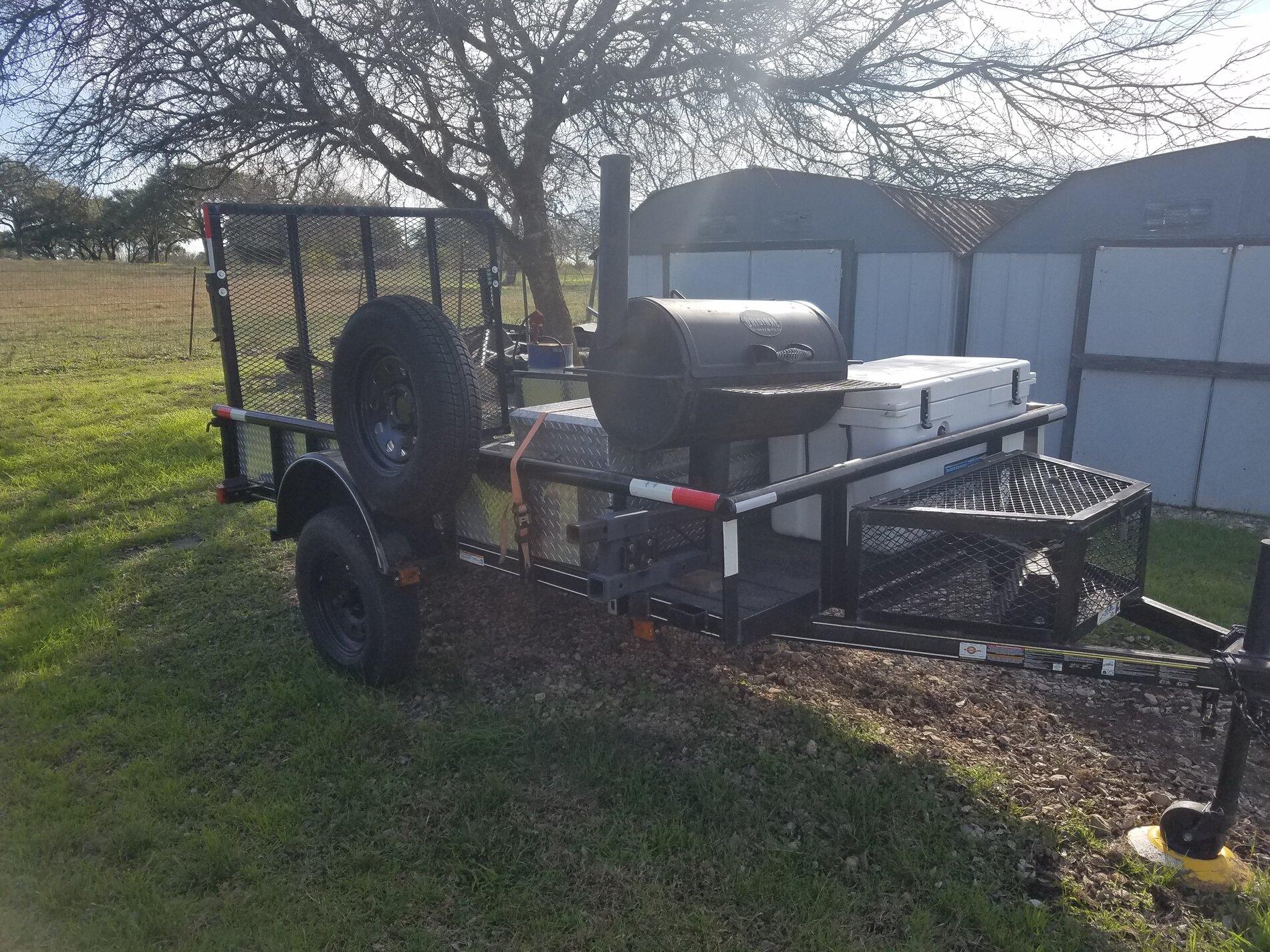

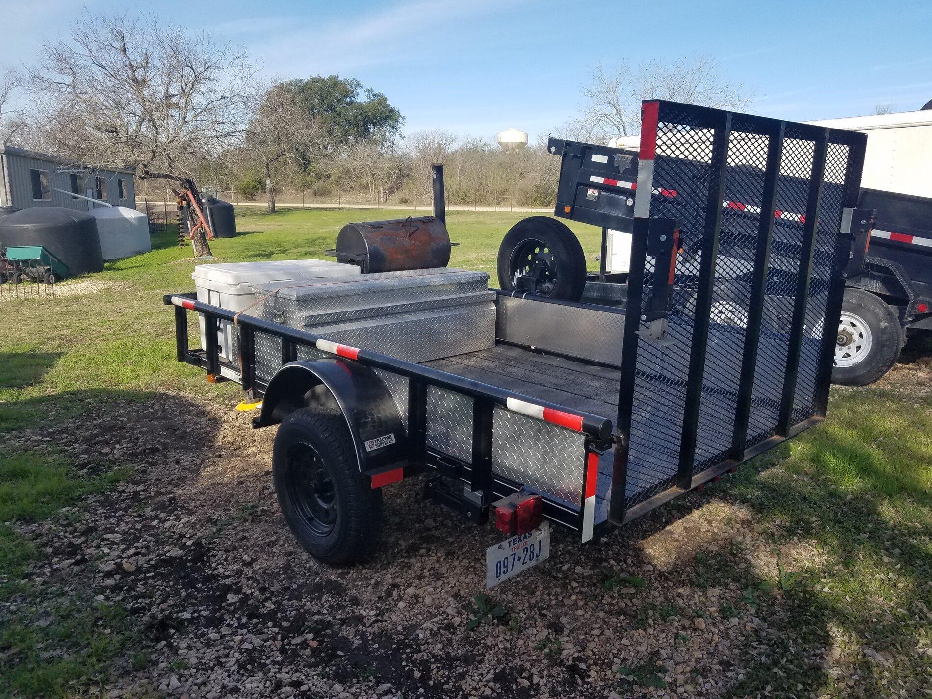

So I got a new BigTex 35SA in 14’. Single 3500lb Dexter axle, and plenty of deck space to fit everything I want and load for proper tongue weight. 1180lbs empty with the spare, easy to double tow.
I also got it cheaper than many used trailers are listed for, stuff was a premium this fall due to lack of availability.
