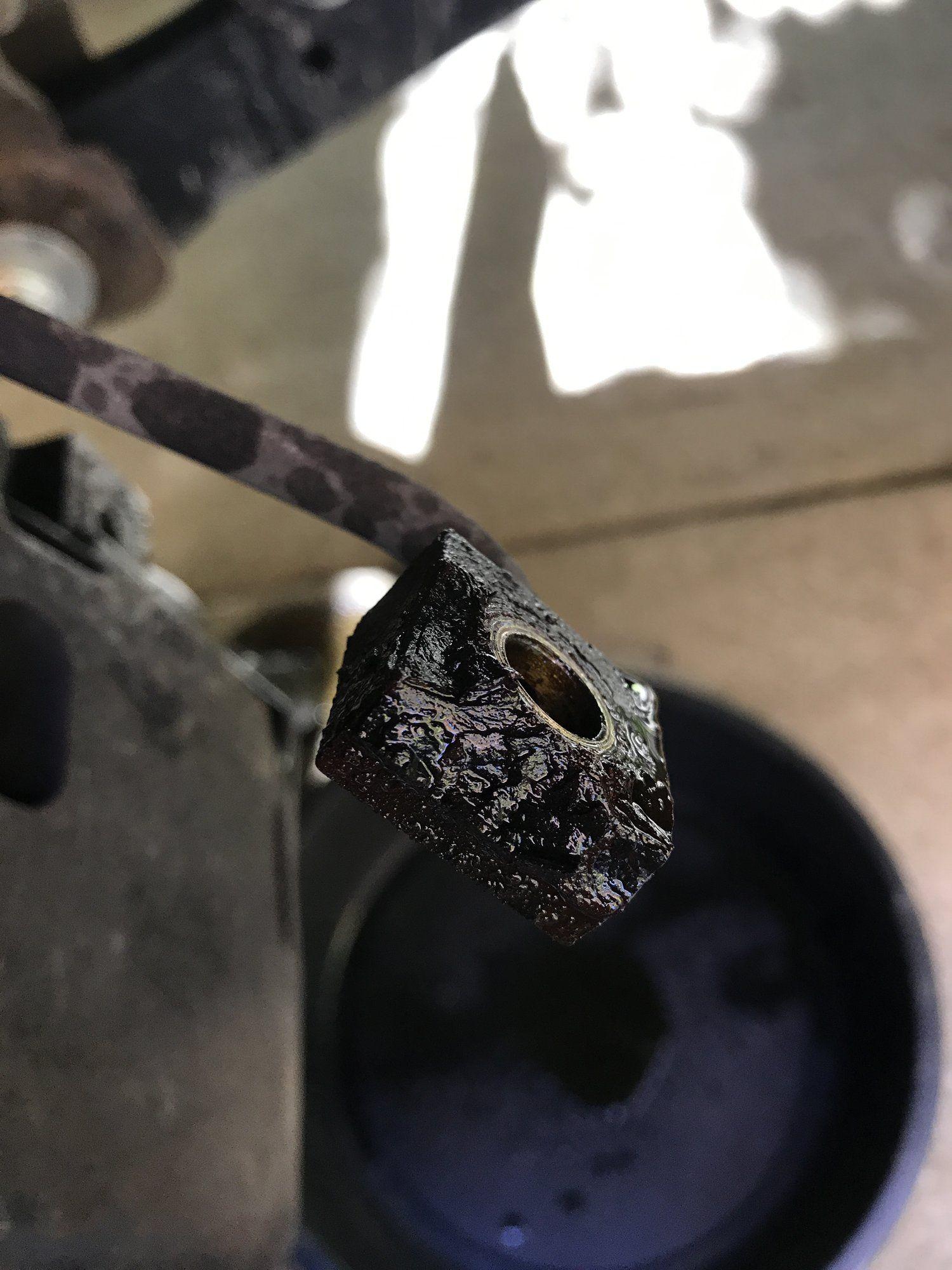

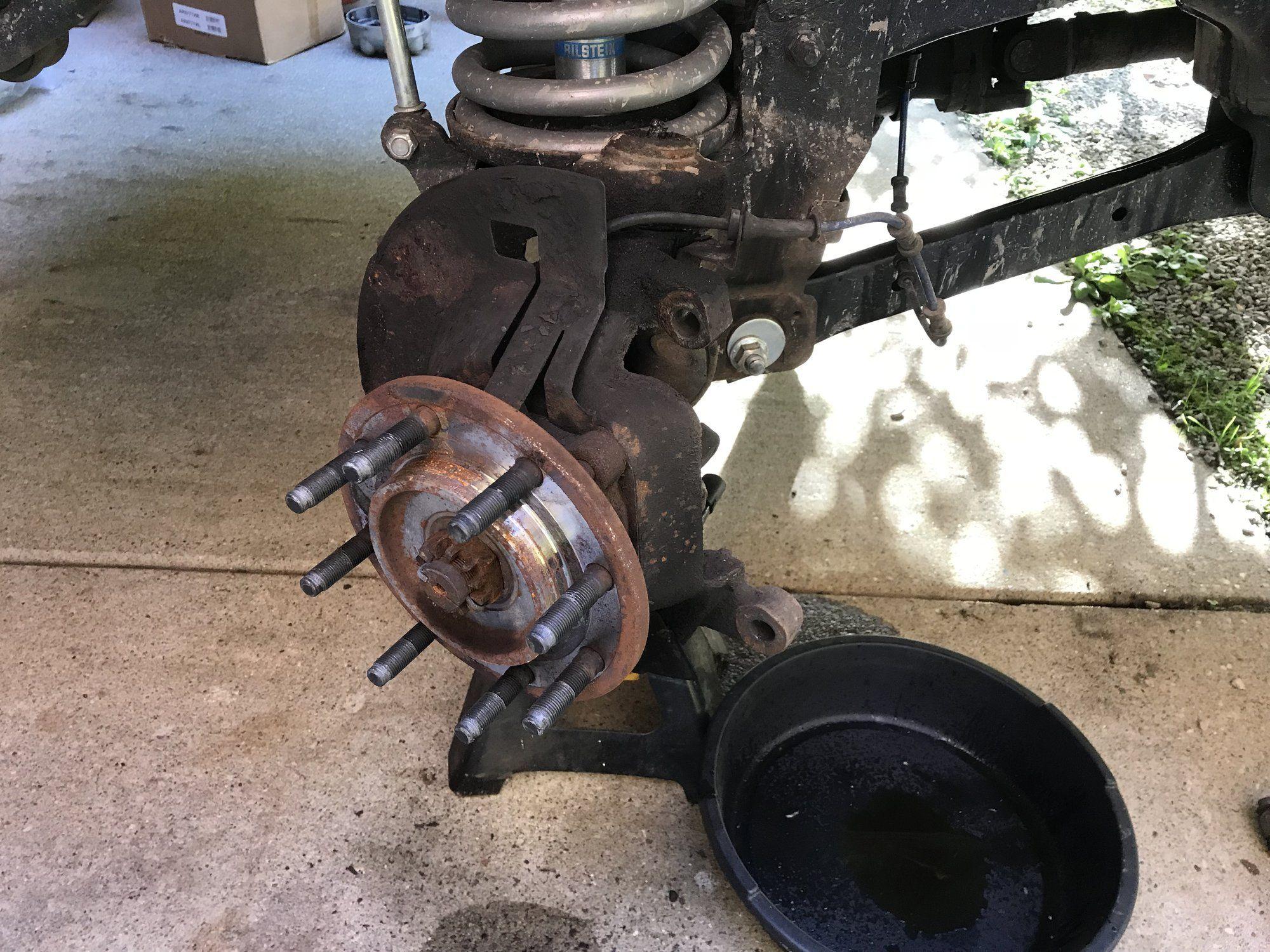

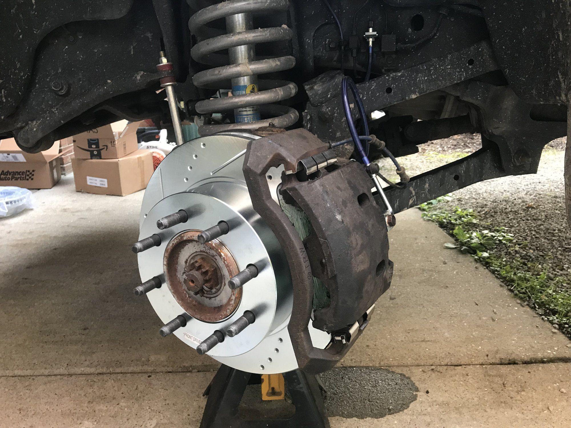

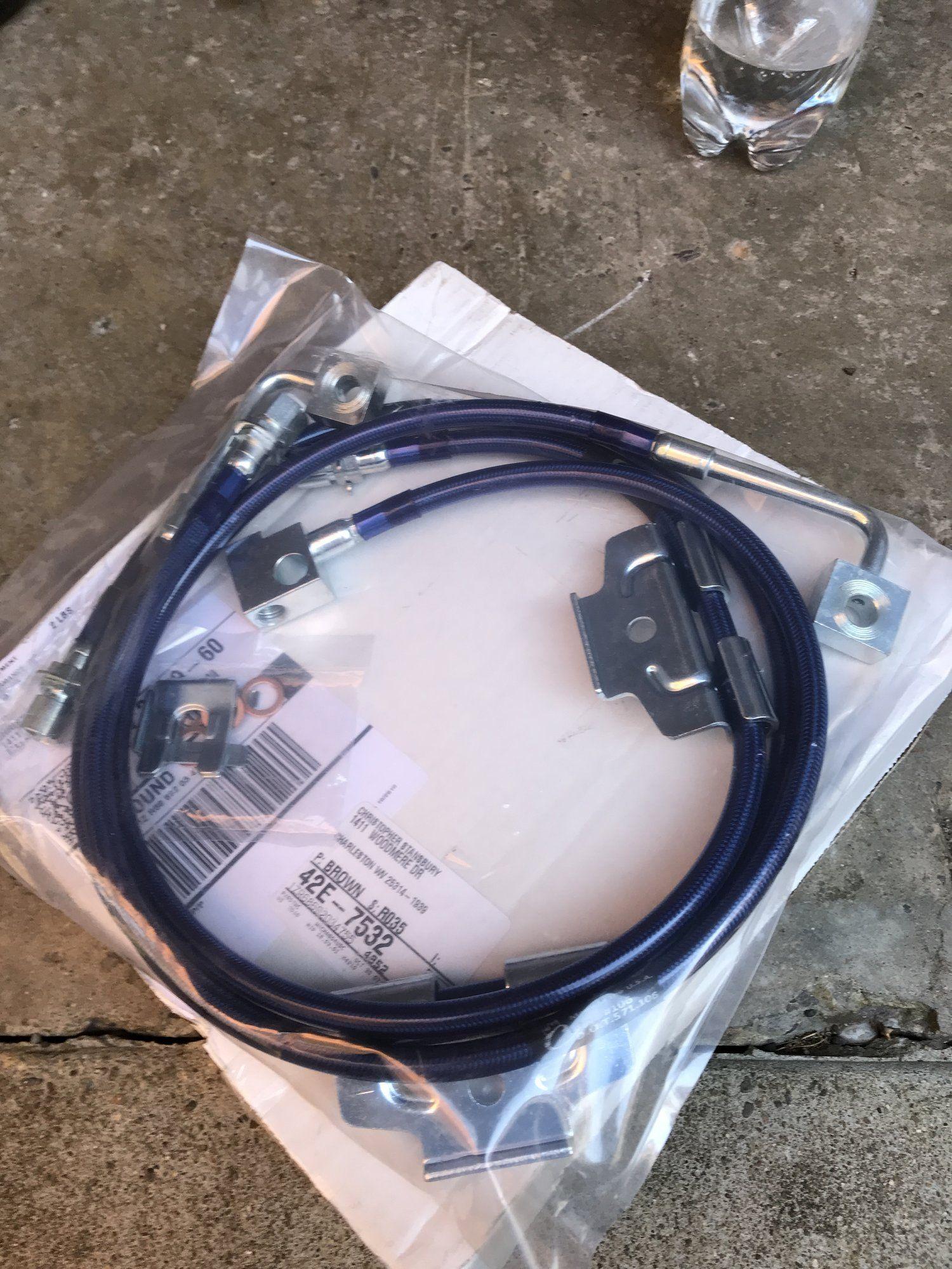

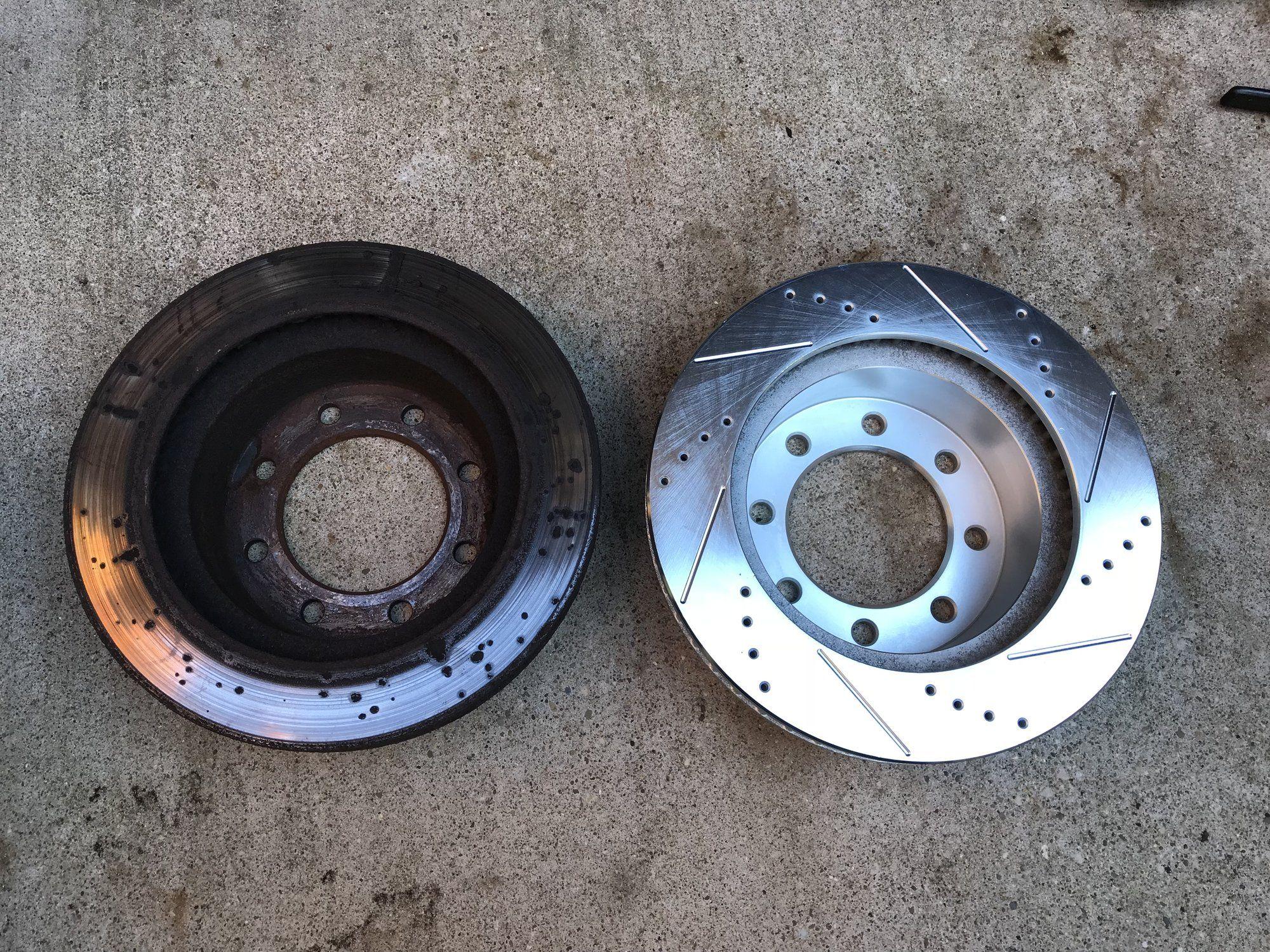

My most recent upgrade on my truck was to the braking system. I changed out all of the rotors, pads, parking brake shoes, and parking brake hardware. The old rotors were crazing and spalling, and the old pads were scored and cracked. I upgraded the system with Power Stop slotted, drilled, and coated rotors and their Truck & Tow pads. I’ve been very happy with the stopping power and they are whisper quiet. I also changed out the rubber brake lines with a 2” longer braided stainless set from Crown. They look and perform much better!

The Crown line set:
Old removed and ready for new:
Old vs new rotors:
All the new stuff installed:
Badly corroded banjo fitting on the old line:

Smart upgrades!
Thanks for taking the time to post the pics too!

Old vs new rotors:

Old vs new rotors:

Thanks for the pics!
Upgrades look great and sounds like it all works well together!
The brake lines look like they will last a long time too!

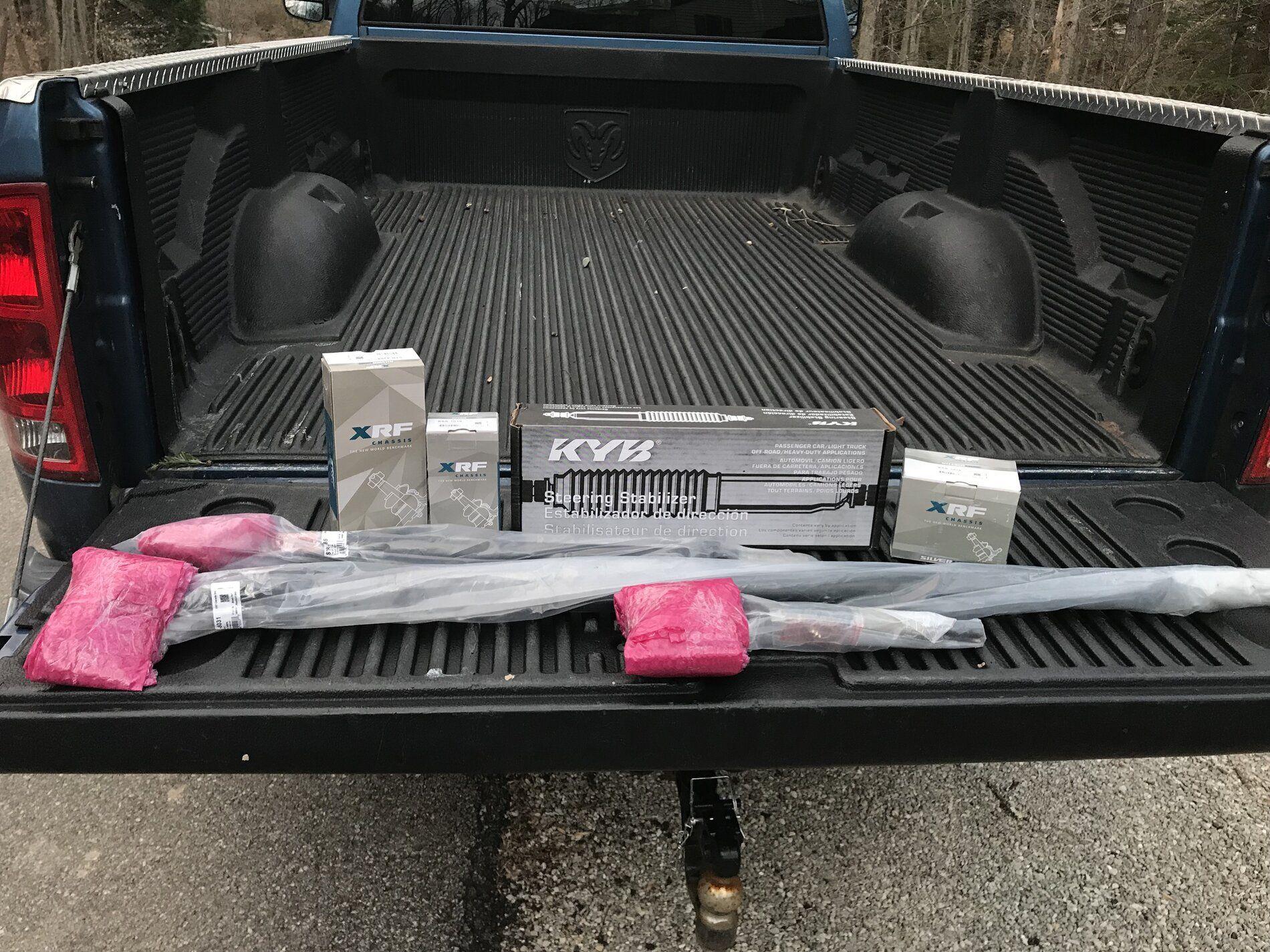

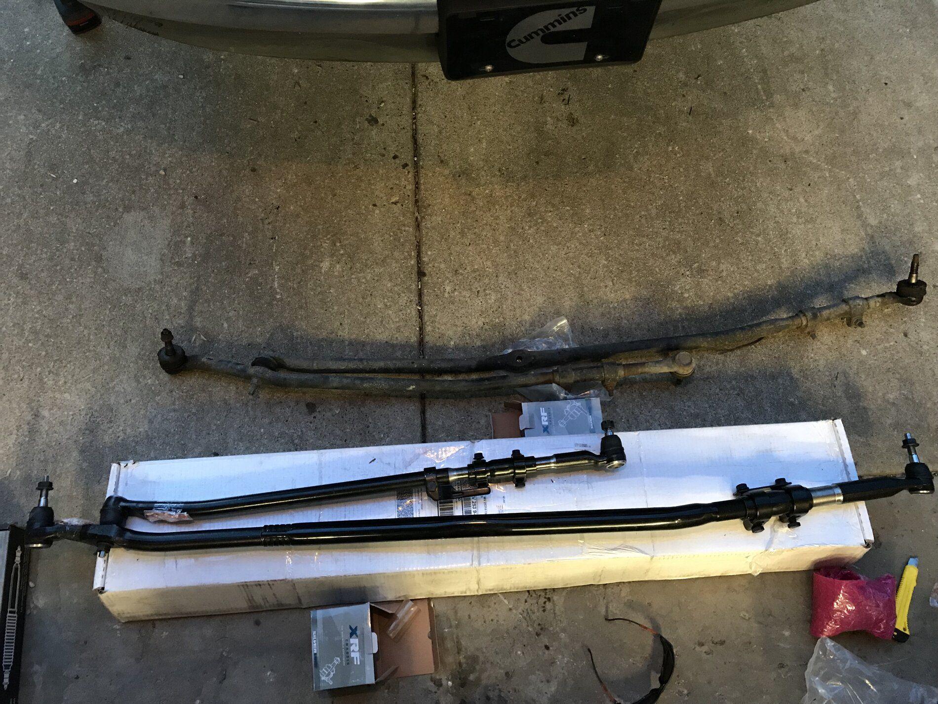

This big pile of parts will soon be a brand new T-style steering setup on my Ram! I finally got sick and tired of the loose, wandering, and clunking stock setup. I decided to go with the XRF system after reading some really good reviews about the durability of their parts. I’ll let y’all know how it turns out!
I'm interested in hearing how the T-Style steering works out for you on your 3rd Gen truck. My 1999 was ordered with the factory T-Style steering and it has been great since day one and continues to operate well with all original parts and approaching 261K miles. I'm confident the XRF system will be excellent!
Keep us posted.....

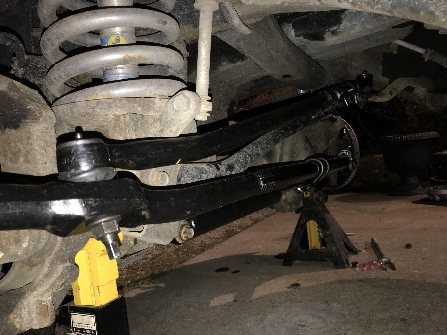

Got my T-style steering setup installed tonight! The XRF parts have a great look and feel to them. They seem significantly beefier than the stock parts. The steering stabilizer was so rusty and crusty that I would bet that it was it was the same one my truck had when it rolled off the assembly line!
The kit install was very straightforward. I removed the factory parts, measured them end to end, adjusted the new tie rod to the same measurement, and then bolted it up. The drag link was a little trickier since it wasn’t in the same position as the stocker, but it went in okay after a little tinkering. Finally, I had to bolt on the new steering stabilizer bracket and then mount the stabilizer.
I took it for a test drive after torquing down the lug nuts. The steering wheel was a little crooked, but the alignment will take care of that. The steering felt significantly more firm/tight/precise. I’ll drop it by my usual tire shop tomorrow for a front end alignment, and then I’ll do some more road testing and report back to y’all!
Good work! Thanks for the pics and looking forward to update after alignment etc.
You most likely will enjoy your truck even more with the T- style steering!
The truck felt great after I picked it up from the alignment yesterday! The steering was much more precise and the tendency to wander in straight stretches was gone! I highly recommend this kit for any DIY guys who want to ditch the stock Y-steering setup.
