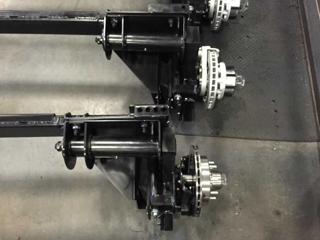

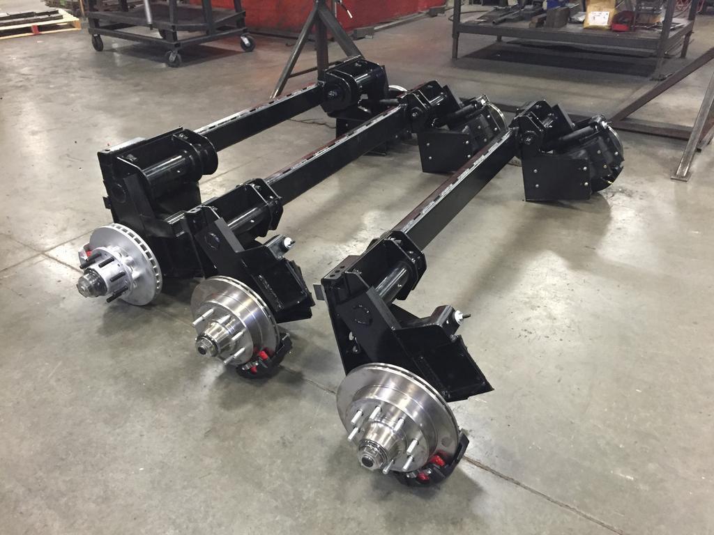

Every other system out there if used for full time will fall apart. Disk brakes are far superior then drums for sure but the IS System is VERY HD! The ride is also much better than standard springs. System is fully alignable.

Cummins12V98, those are some fine looking pictures. The MorRyde IS suspension is standard on the LUX and only available on the
Ambition as an expensive upgrade. The Ambition comes standard with the MorRyde SRE4000 suspension. So what defines the
difference between a LUX and an Ambition purchaser? Obviously, the purchase price and the towing unit, not considering the
cosmetics; remembering that the dry weight on the smallest LUX is somewhere close to 16,000 lbs. Yes, I would love to consider the
LUX recognizing the difference in price is reflected in the full-body paint, MorRyde IS suspension, heavier frame, thicker sidewalls,
etc. but in reality, my truck would be over-loaded and my bank account suffering. Shucks, it's suffering anyway, LOL.
