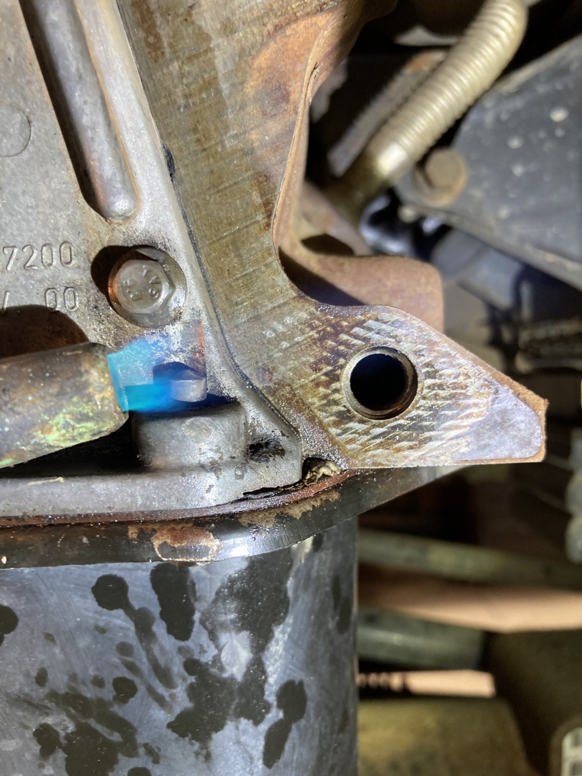

Went down to the shop today to install the freshly painted skid plate and immediately found one of the four threaded holes to be be lightly stripped and wouldnt tighten down. sigh.
I grabbed an M12-1.75 x 30mm bolt (and correct flat washer and lock washer) from the bins, lightly filed the burr off from the face of the crossmember, and then drilled out the stripped M10 hole with a 13/32" drill bit and retapped for the M12-1.75 bolt.
My OCD really wanted me to drill and tap out ALL 4 holes, but after inspecting and testing each of them and finding them good, my common sense wrestled my OCD into submission and I left the 3 good holes using the OEM M10 bolts and I used only the one M12.
The M12 bolt still (barely) fit through the skid plate holes (which are over sized for lateral movement), and 15 minutes later, the 48RE TC adapter bracket was properly bolted to the skid plate.

Second pic shows the retapped and larger bolt.

I stripped two of them , replaced with steel rivet nuts so I can use the same bolt and functionality.
Yes it will forever forward drive me crazy when I have to bring two different sockets to remove one skid plate, but thankfully that won't be too often.
