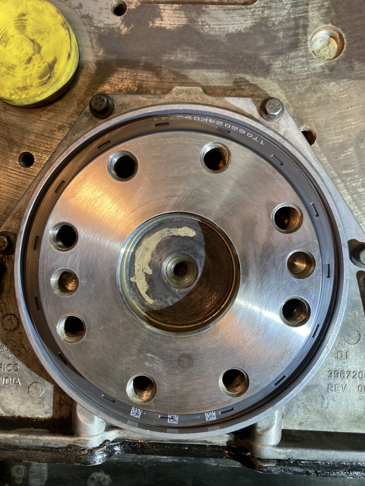

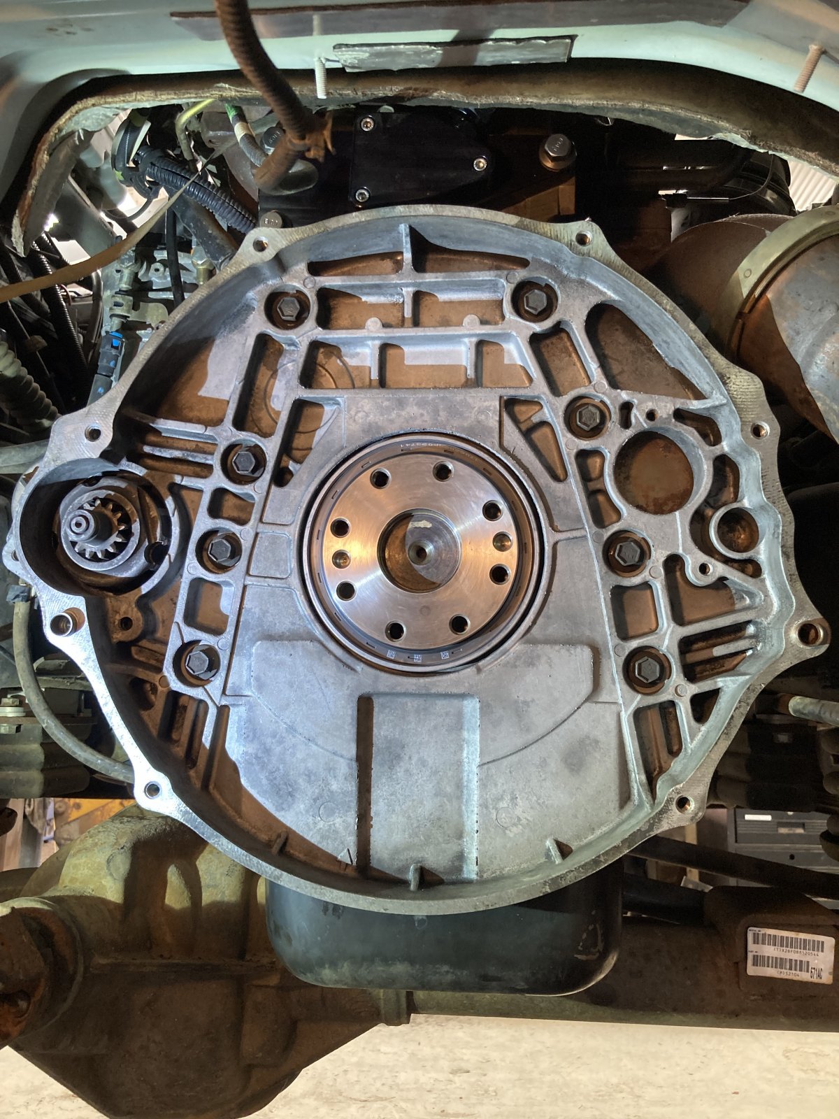

New Cummins rear main seal started with the plastic install sleeve and also the depth/set tool that comes with the Mahle kit (which Genos does sell)
Even though I bought the Mahle kit which includes the rear main seal, install tool and also retainer housing gasket, I also separately bought a genuine Cummins rear seal which is what I actually on the truck, installed using the Mahle kit.
NOTE — I also bought and installed the genuine Cummins camshaft to adapter plate "square cut" O ring seal. This o ring is placed in a machined groove on the FRONT of the transmission adapter plate just where the camshaft ends at the rear of the block. That is just under the yellow protective cap you can see in the first couple of pictures.
Flywheel bolts and lotsa washers to finish pressing in the rear main seal evenly —

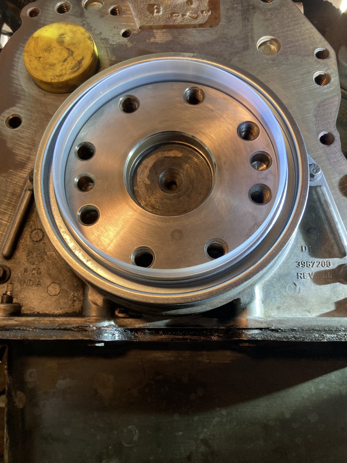

Rear main seal fully installed —
Starter and transmission adapter plate torqued back in place --

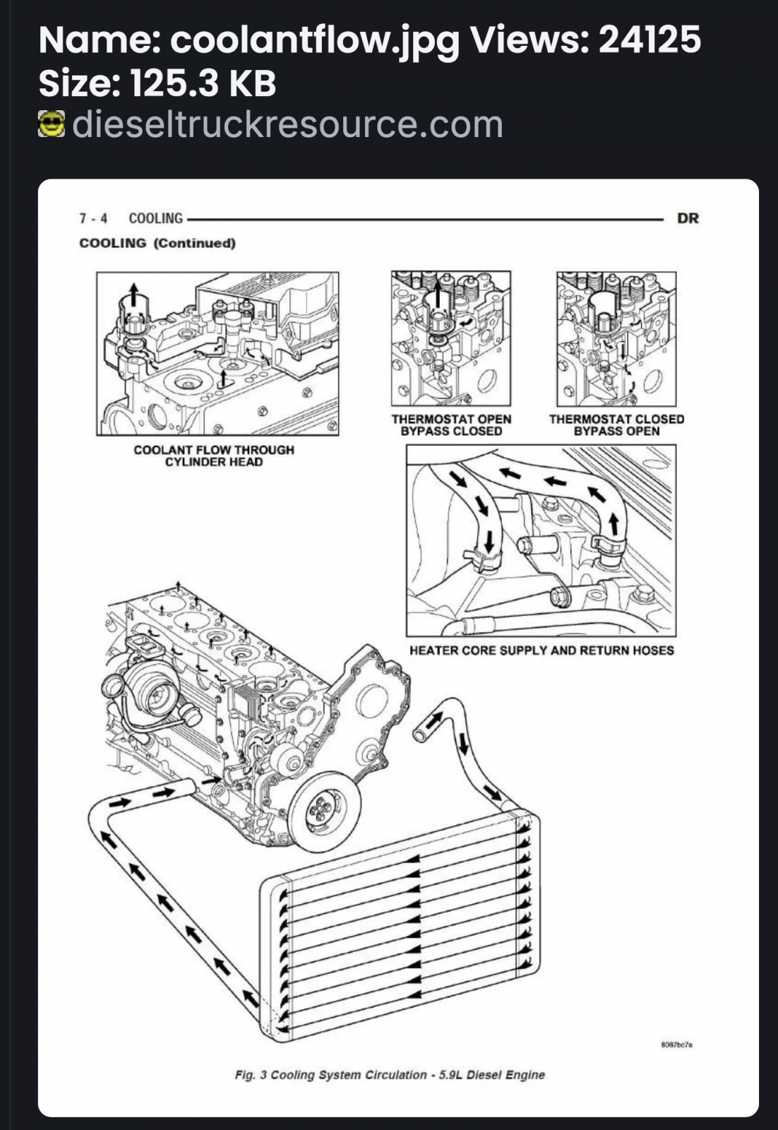

But the rear bypass thermostat only connects to a riser ABOVE the OEM thermostat which is remaining closed until 190…doesn't that mean the bypass thermostat is just recirculating coolant in the block until the OEM thermostat actually opens ???
Maybe thats what I am unclear on..the direction of coolant flow.
That’s the outlet for the bypass thermostat, which allows it to dump into the radiator.
When the coolant at cylinder 6 reaches 180° the bypass thermostat will open and likely under most empty driving keep the truck below the normal 190° operating temp.

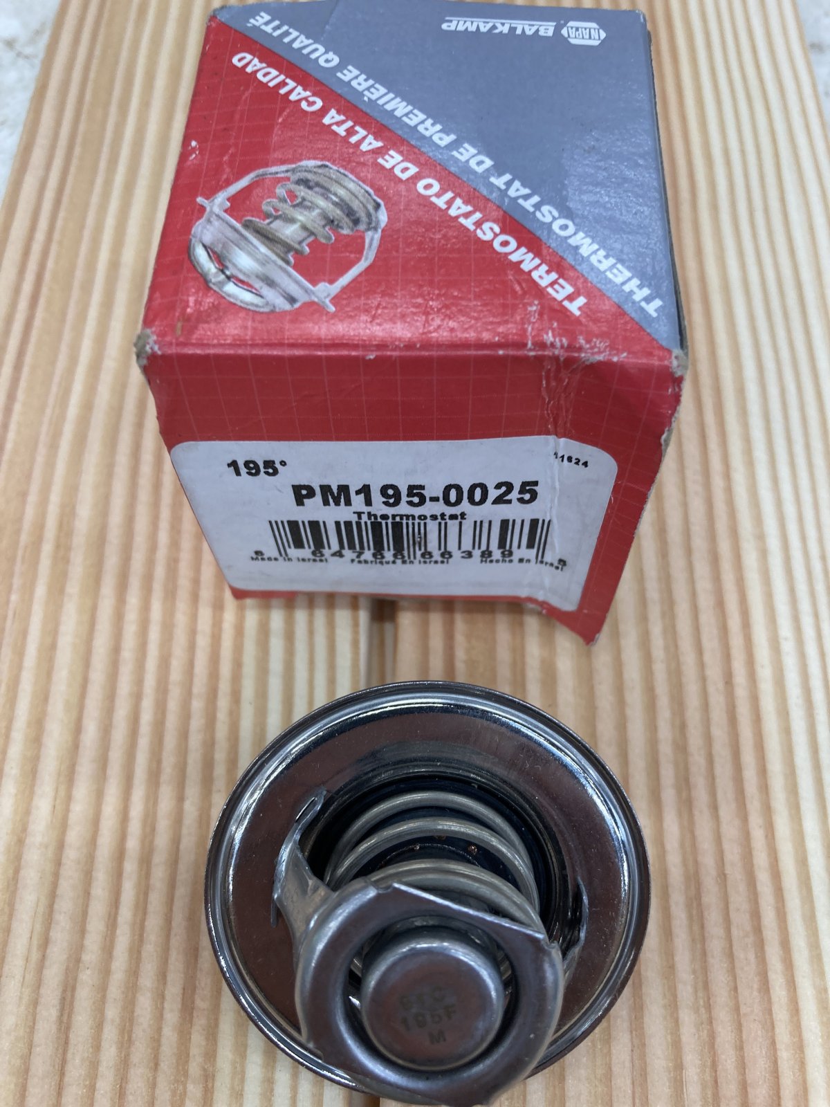

That said, after work today, and based on what AH64ID would do if it was HIS truck :cool:, I went to Napa and bought and installed a NAPA/Balkamp premium thermostat for a small block chevy 5.7 hemi that is rated at 195* and put that into the Fleece Coolant bypass …so now both the Fleece and the OEM thermostat will be opening more or less at the same time, with Fleece starting to open just a tad later.
The 1x4 fir that you can barely see under the thermostat is a "nickel gap" T&G for a client's ceiling.
