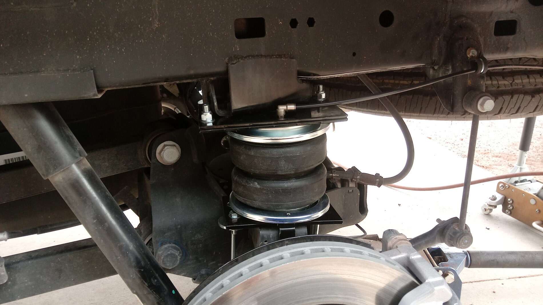

OP, I recommend air bags, you will be fine. They mount under/outboard of the frame. You already have a rear sway bar. I went with the Air Lift 5000 on my '21 Ram 2500 with coil springs.

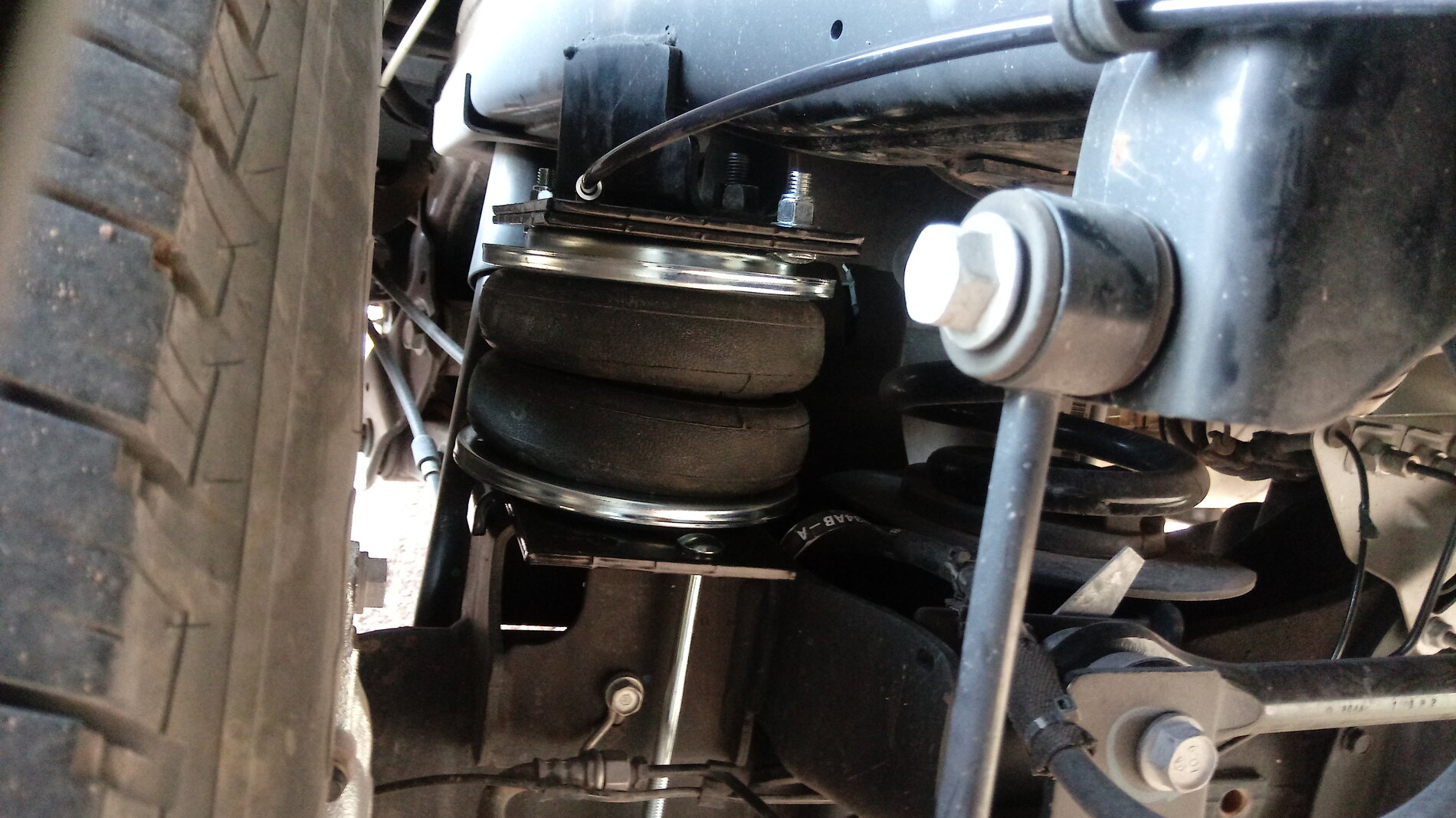

If you go airbags, check out daystar cradles. I run them and it takes away the worry about ripping bags if you put your truck on a lift to be serviced and losing articulation in off road situations.

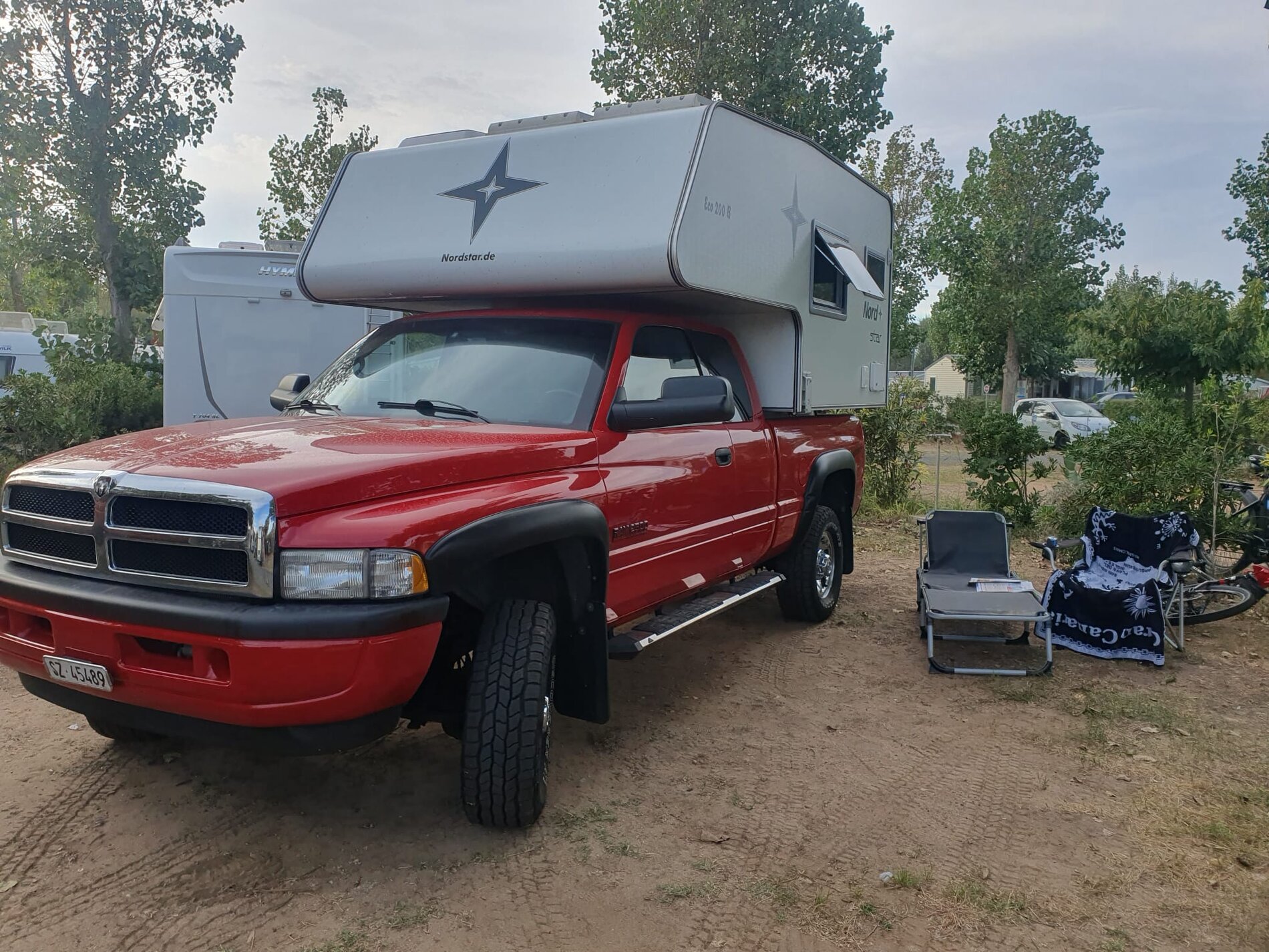

This is my buddies truck with the Camper on it, the same truck that is used to pull the trailer throughout the year - and he is totally happy with the Timbrens.
I've driven it myself both ways and I couldn't find anything bad in it's driveability that would make me to steer away from the Timbrens.
