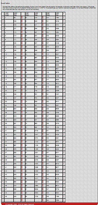

sorry about my incorrect use of terminology, I just wanted to know what the maximum weight and maximum air pressure of certain tires ,to match my old Dunlop's. A LI number doesn't mean too much to me without a chart .( .... the side wall of a tire shows maximum weight and maximum air pressure)
Thats Ok as the LI and the Max. Weight label on the sidewall of the tire is always the same. Must be.
Often there is a double number like 121/118 on it, first is for srw, second for Duallys.
