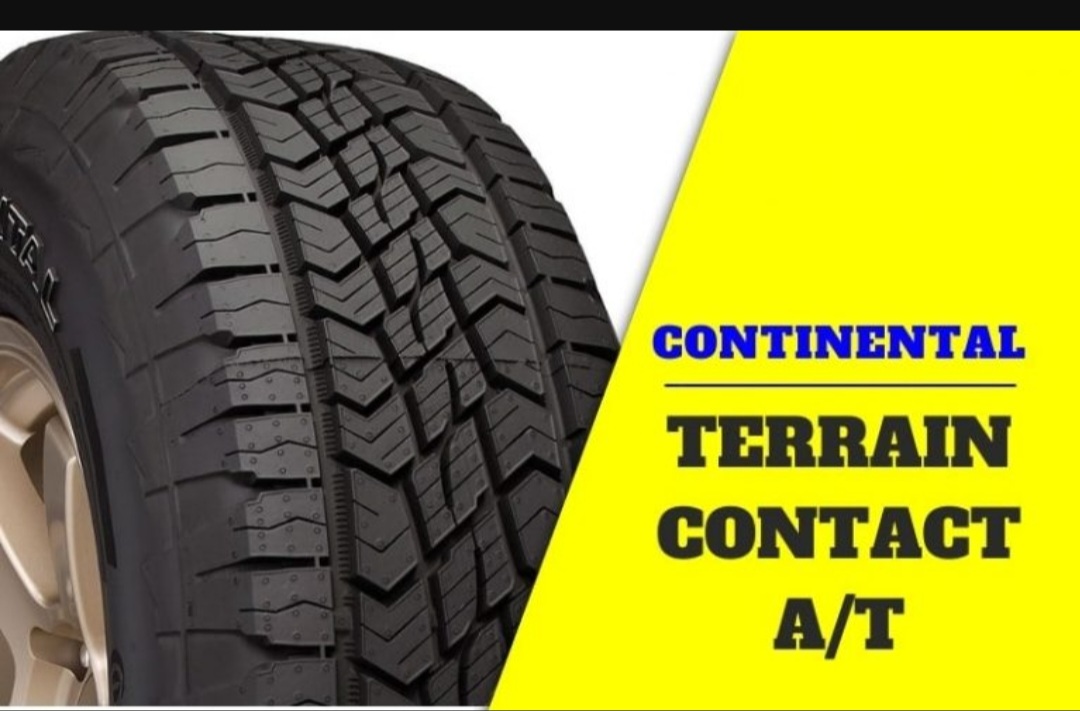

I bought a set of Continental Terrain Contacts now, (all terrain) & so far quieter but they seem to carry (& release) stones.
