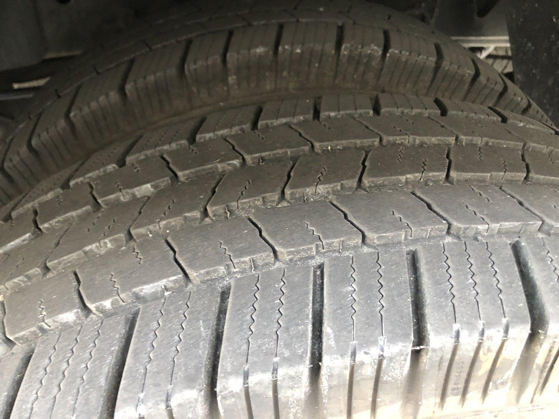

With the Alcoa wheels I simply rotate fronts side to side leaving wheels in same position and tires rotating the same. This puts the inside edge on the outside both front tires. I never touch the rears.
30k on these with 1/4" tread left. Personally don't worry about the spare too much. Next new set of tires I may put one of these on the spare location. Fronts look the same.

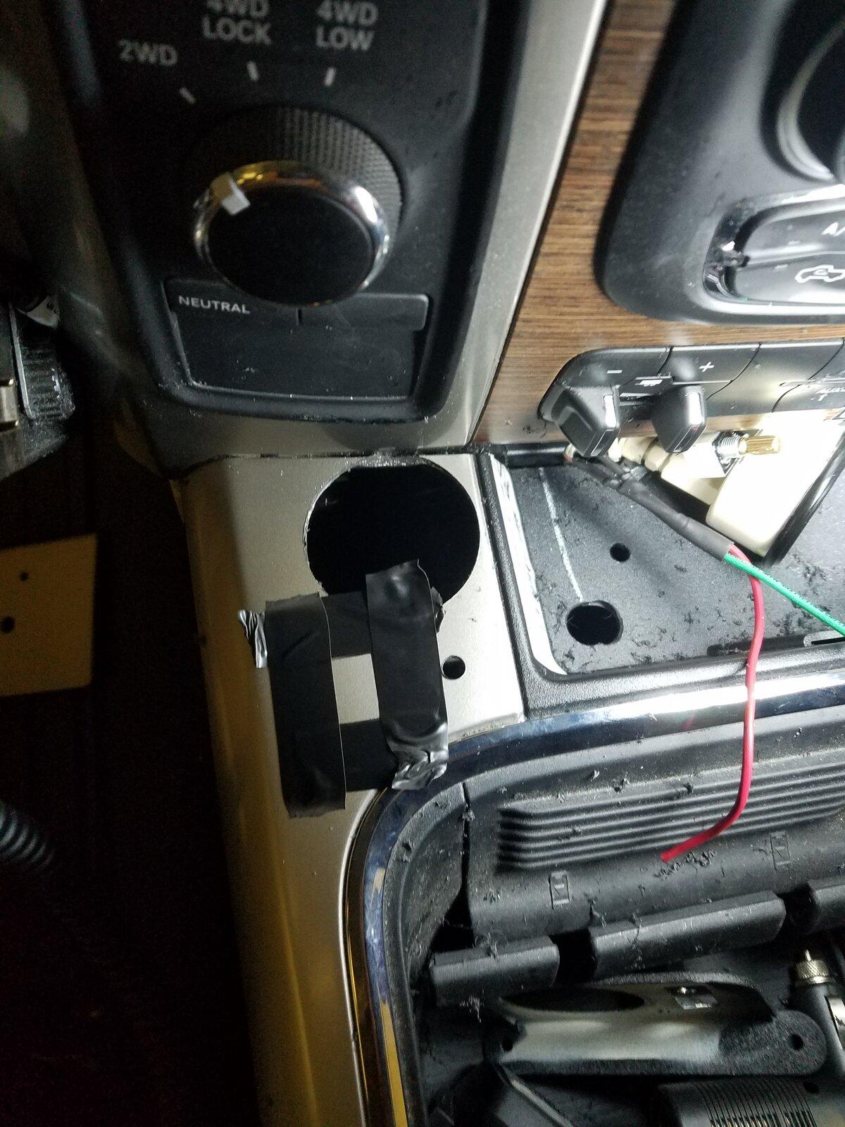

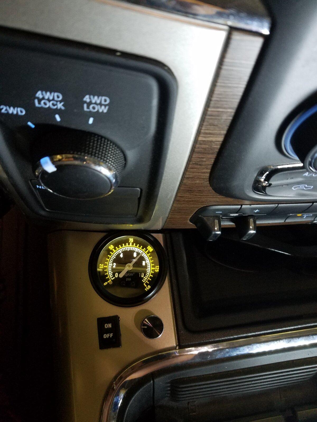

Finally determined final location for the in cab air gauge, gauge light dimmer switch, and air horn cutoff switch. Be done tomorrow.
Pics
Measure 5 times, cut once. Got some tape to protect cutting rocker switch with Dremel and hot knife.

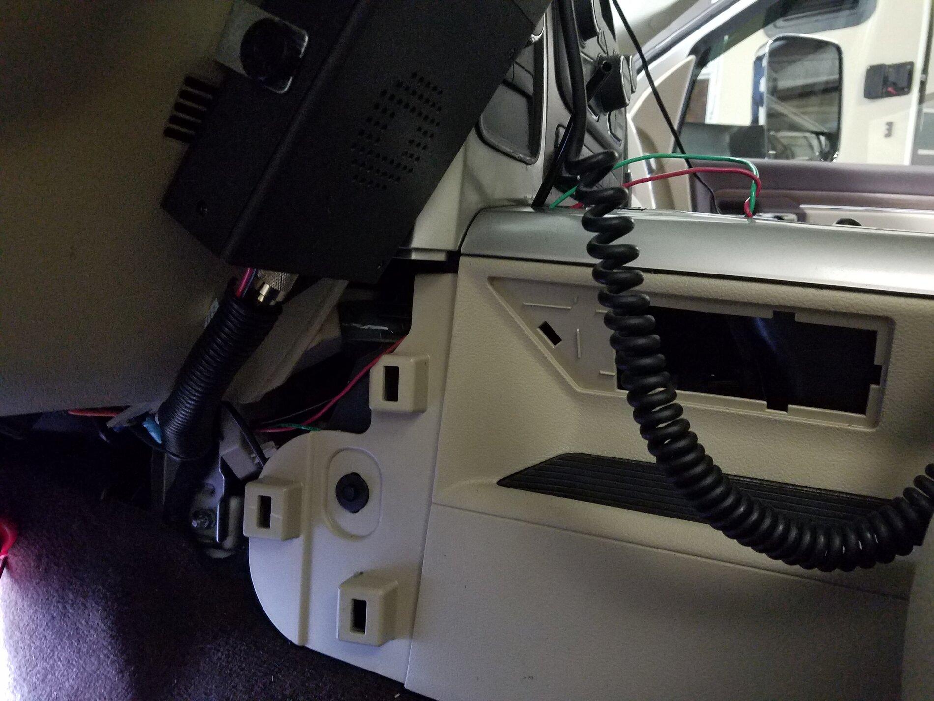

Here's some nice access to reroute the airline and circuit wiring. I left it long enough to reach the console. I knew where I wanted it to live, just not how or exactly where.
Ram musta known some modifiers would want access without pulling the console.
I'll post finished project tomorrow.
Cheers, Ron
Ron, What is the switch below the trailer brakes switch for? Is this the same gauge that was on the left side were I would bang my knee on? This is better spot, thanks for update on this project.
Homer.
Yep, moved it. When not thinking about it, I hit my knee on it a couple times, enough to work harder at finding a better place for it. I found the access opening on the side of the console while leaning on the driver's side door and popped it out... very happy to find a void in that area The switch below the trailer brakes is the gauge light dimmer waiting for it's new home. In all actuality, I might could have made tapping gauge LED into the dash low voltage dash lights, but decided against it since they operate through the buss and the BCM, if I recall correctly. I have small hands and fingers, so I actually can reach my hand into the side of the console (bearly :eek::D).
