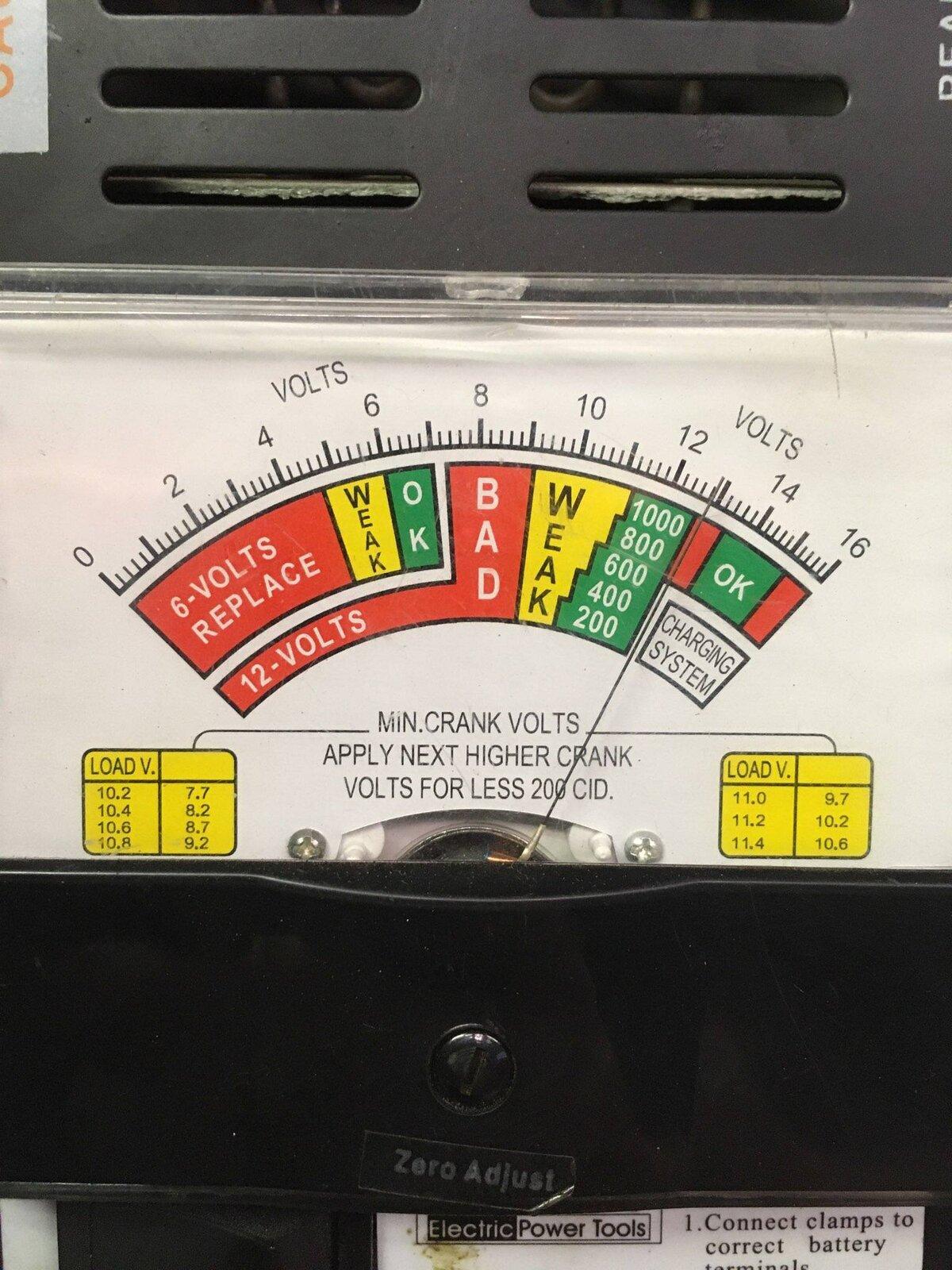

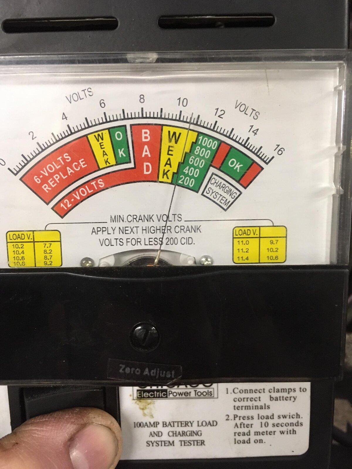

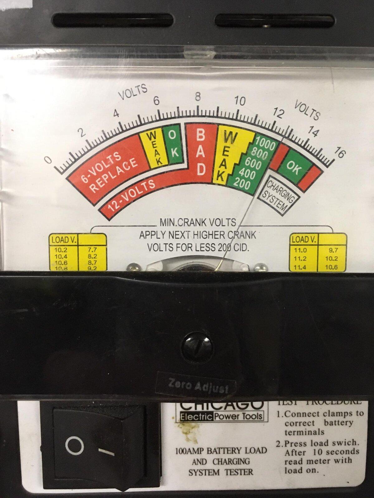

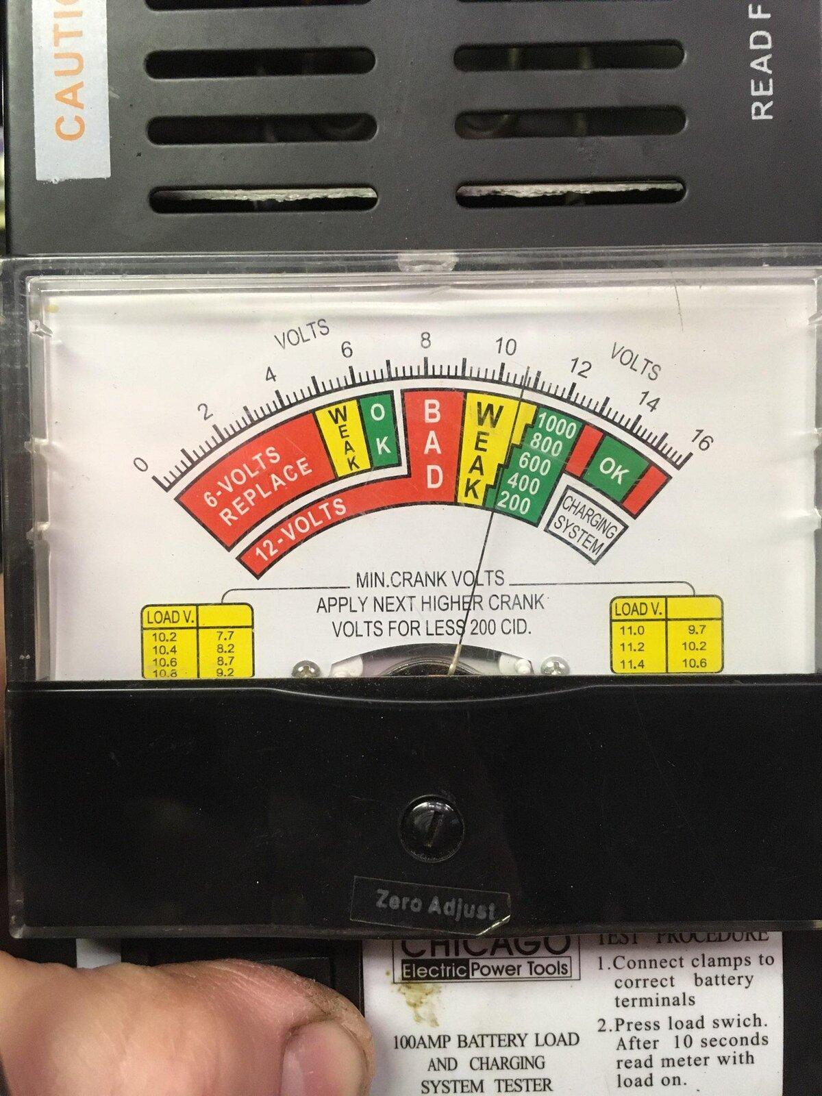

Here is how the batteries load tested.
Passenger Side:
Drivers side:

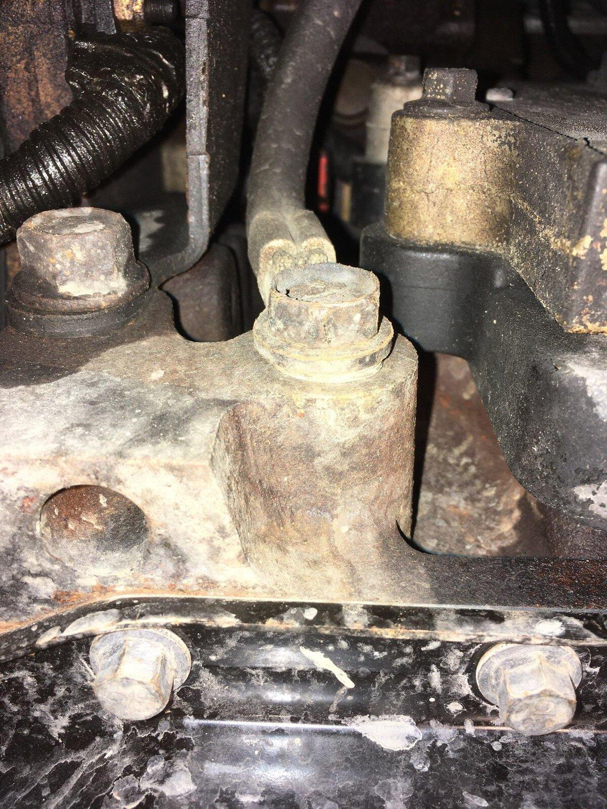

This is the grounding strap on the side of the block. Noticed that it was only finger tight. Not sure if it was knocked loose when changing the oil pan last spring or if it just worked loose over time.
