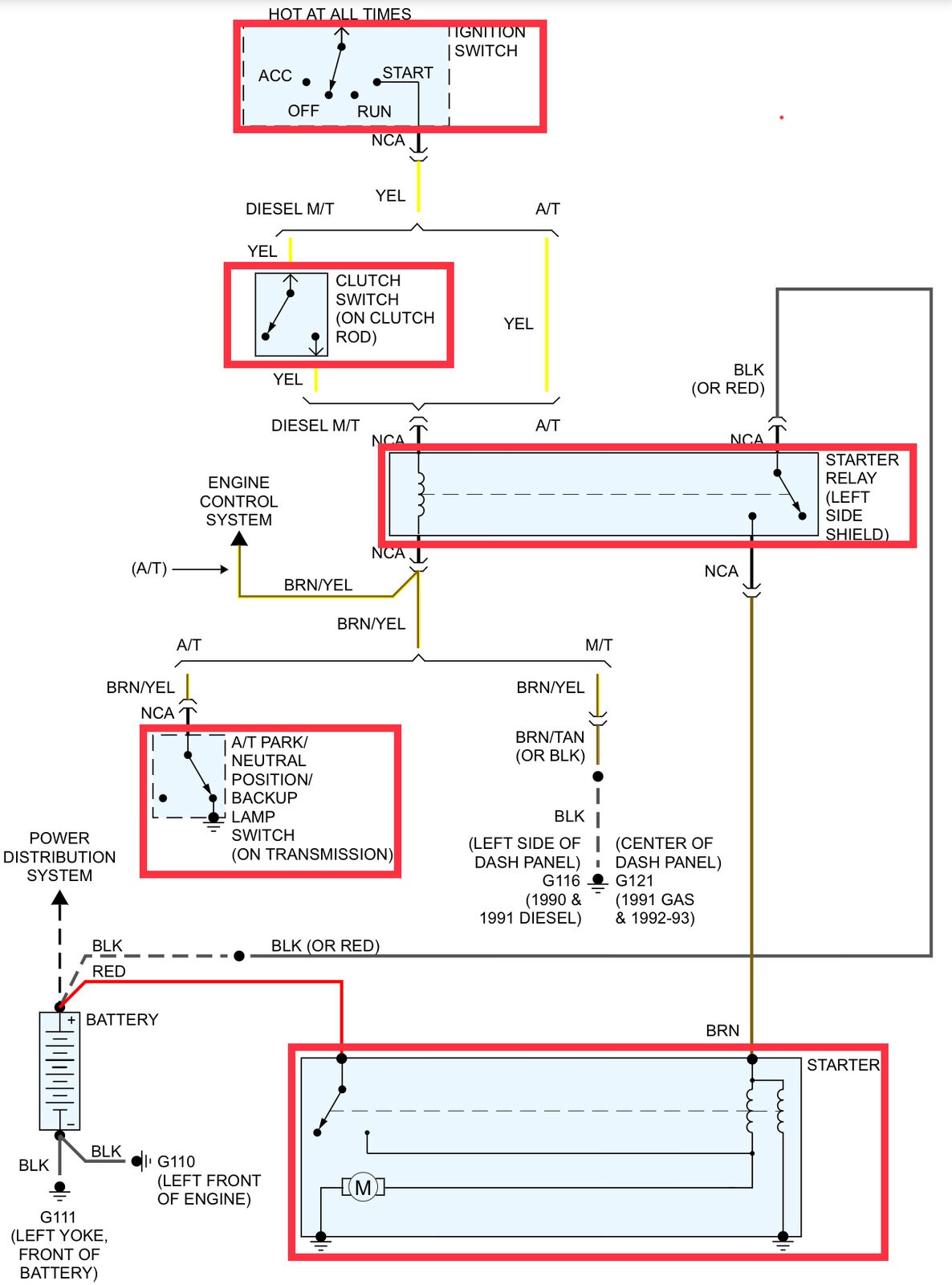

NCA = No Color Associated
what does the NCA mean? also, what are the big blue boxes?
I believe that "NCA" is referring to the wire color - in this case "no color associated". The blue boxes are enclosures representing a component. The wiring inside of a blue box is part of that component.
