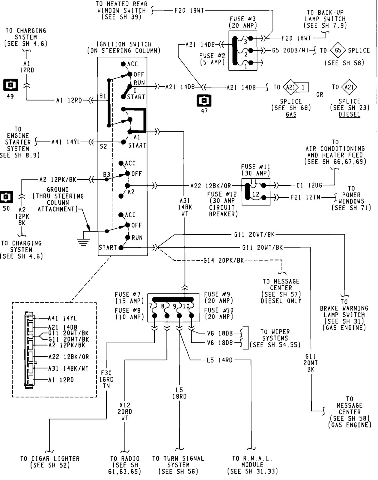

I traced the starter problem back to the ignition switch. I tried the relay and that worked so I backed up and pulled the ignition switch and was able to hot wire the truck and got it running!!!. Now, I just have to find an ignition switch. Then I can get back to so if the grid heaters are working correctly. Thanks

I got an ignition switch from the local parts store. I installed the switch. NO change. With the new switch installed, the halo light comes on but it will not start using the key. From the diagram on page 8D-27 in the manual, I can start the truck using the center wire #4 and jumping to #2, then to activate the starter, I jump from #4 to #1 and the truck starts. The truck will still run with only #2 and #4 connected. If i hot wire the truck, the alternator only goes to 12.0 volts. On page 8D-25, the manual refers to Group 8M for Key-In-Switch and Halo light diagnosis. Unfortunately, my factory manual does not have 8M. Does anyone have that? It would appear to be the ignition switch but at this point in time, I don't know what to look at. Any ideas are very welcome. Thanks
Here’s an OE diagram of the ignition switch. This is from Alldata. I don’t have a manual so I don’t know what’s on 8M.
I have a 92 print manual and it has no 8M...goes from 8L Lamps to 8N Rear Window Defog. BigPapa's image above is the same as my print FSM (page AD10).
I had a CD manual I got with the '92 I had but gave it to the fellow that bought my '98. I still have a USB thumb drive he gave me. I'll have to see what's on it.
I was trying to find some more info. On your wiring diagram of Oct 29, I was trying to understand it. what does the NCA mean? also, what are the big blue boxes? Is there a testing routine for the grid heater in the manual that I cannot find? thanks
