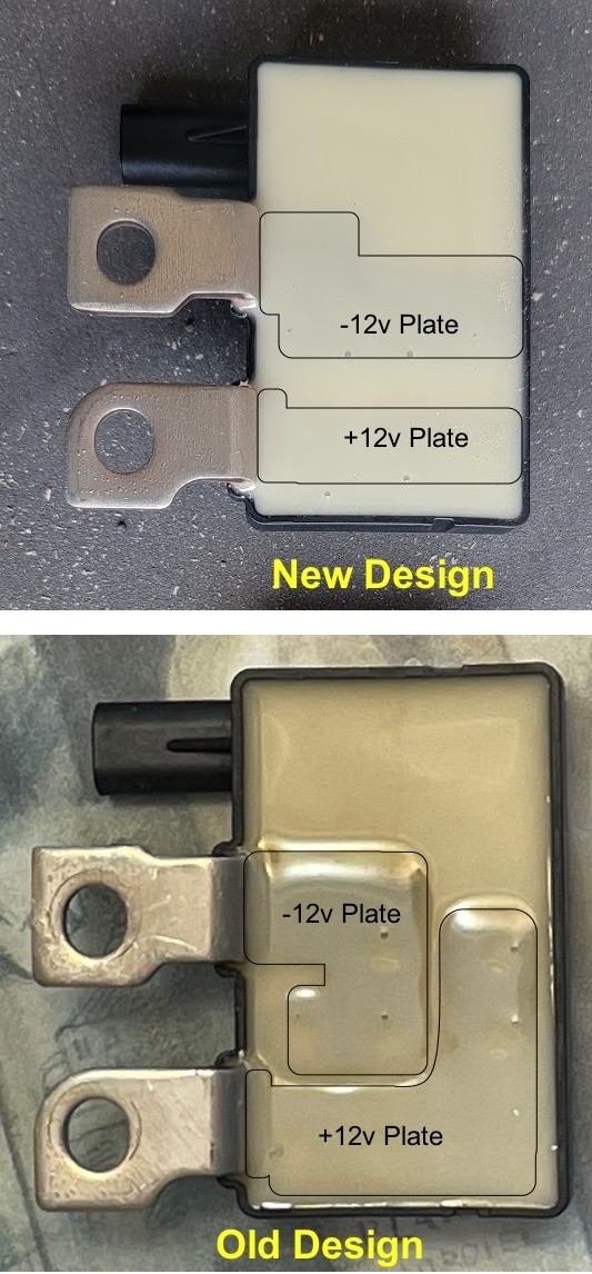

Sorry to start another thread on this. Did a search and read all that but my Indy that serviced my truck brought it up the other day so here goes. When I got the recall on the relay I disconnected the 10 m bolt to the relay so I could park in the garage. Now I have a new relay from the recall and it’s connected back up. So does the bad old replaced relay stick shut causing the grounding bolt to melt causing the killer grid bolt issue or I’m I missing something here. I really don’t need the grid heater here most time. Truck is started in warm garage. And is hot until it comes back. If it got -20 f and I had to leave it outside I would reconnect the grid heater and take a chance. I need some input on this. Thanks
Why is the new relay disconnected? If you look at photos of them it’s obvious why there was an issue, and that it’s fixed. I didn’t create the attached photo and it’s labeled wrong, only the 12V+ circuit is completed inside the relay. Despite the incorrect labeling the photo shows the potential issue on the older design with the plates being too close and a short starts the fire. Don’t overthink this, you live in a state where the grid heater is warranted. Leave it connected and forget about it.
The relay and the nut are two separate issues. When the relay starts a fire it’s at the relay itself. The nut has been a potential issue for the 6.7 since it was introduced, regardless of what relay powers the grid heater. Do the Geno’s wiggle test at each service and forget about it. Both issues are incredibly rare.
