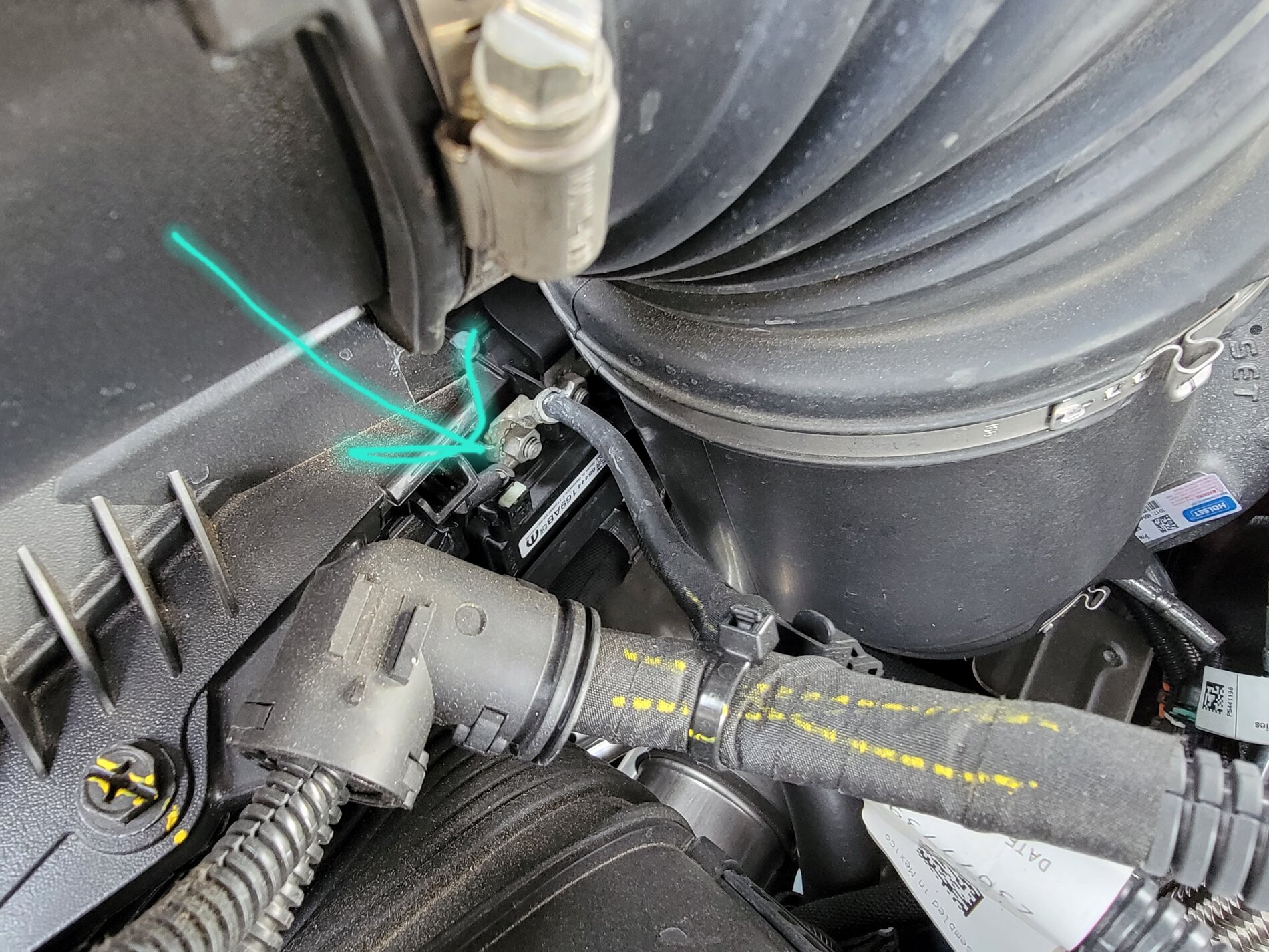

I removed the air box and tube and air cleaner today. I found the grid heater relays. They don’t look new to me at all . With a strong light they look as old and dirty as everything else under the hood after 20 k 2 years of driving. The paperwork said they replaced it . I say bull . What to do.

What's the part number on it?
You shouldn't have to remove anything to see the part or part number. There is also only one relay.
When it comes to the relay deal, I would think they are pretty honest. It's pretty much in the open, I was able to get a pic of mine with out too much hassle.

Mine is a mopar 68605435ab. Toodp195322329. I don’t know how you changed it by just removing the top hose clamp and moving the hose out of the way. Did you disconnect the battery’s or not . H still hard to tell if they changed it out. Eyes not would they used to be. Cataract surgery next week.Really Can you tell by the part number that they changed it then

If you meant 68606435AB, then they changed it as that’s the new part. Sounds like a normal dealership doing normal dealership work.
I did not disconnect the batteries.
Yes 606. I had to take a picture With my apple 11 upside down but I got it done .Good to know my dealer changed it out. Thanks John
