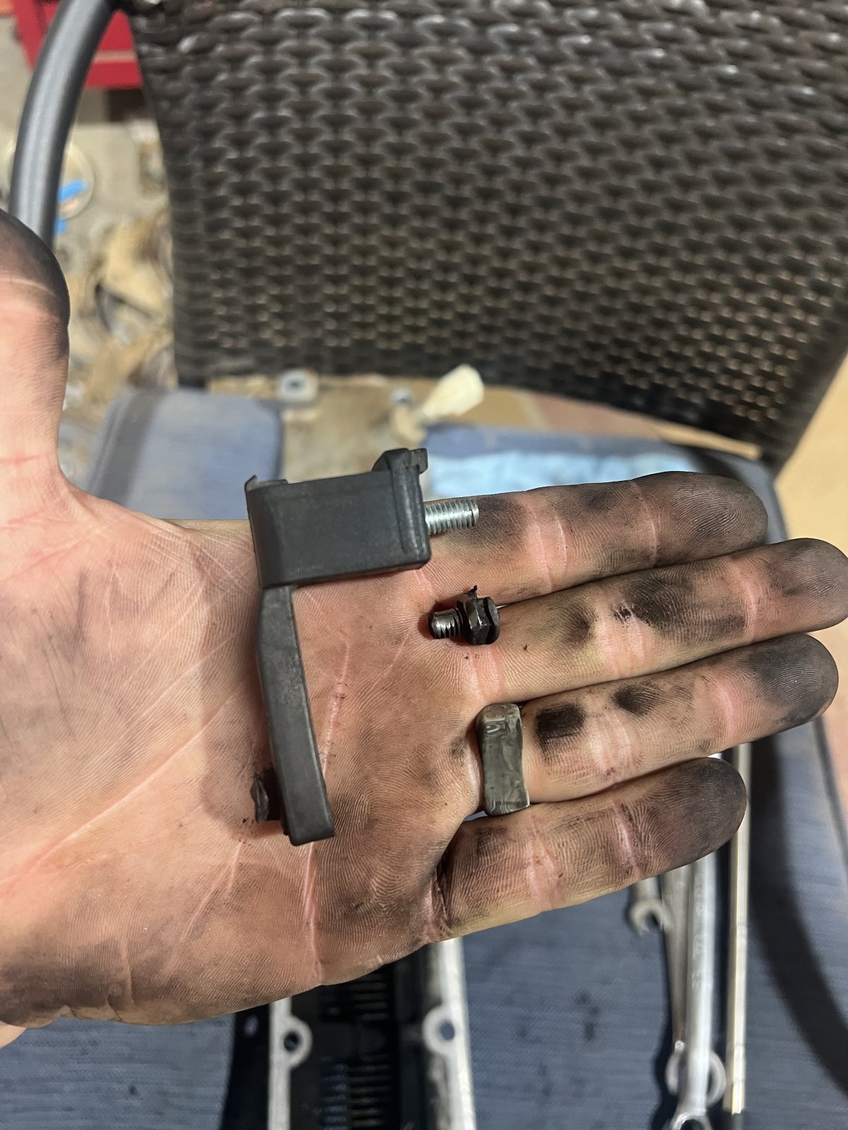

Mine failed. Maybe i caught it in time. I took off and replace it with banks setup. I ran a telescoping magnet down intake back toward number 6 and heard it pick up broke piece. Flat washers were welded to bus bar. When I first heard about it. I should’ve just unhooked wire to solenoid and prevented this from happening.
@Byrd, I'm glad that you caught it "in time"! I did the BD kit on my 2014 a few months back. I did it for that piece of mind and to prevent what happened to you! I know people thought that the BD kit was a "solution" to a problem that wasn't on the radar! I hope that now you'll be able to enjoy the truck without that worry hanging over you. Thanks for posting what you found.

@AH64ID, The wiggle test is pretty useless! The way that the bolt goes through the intake plate, if it wiggles, it's too late! I installed the BD kit to feel better. As we know, our trucks, our choices. We all do things to our trucks that others may feel are unnecessary. I think that Cummins just rolled the dice on the amount of failures. With the environment that the nut is in, and with the way that BD did a redesign, I'm glad to have changed mine out! :cool:
