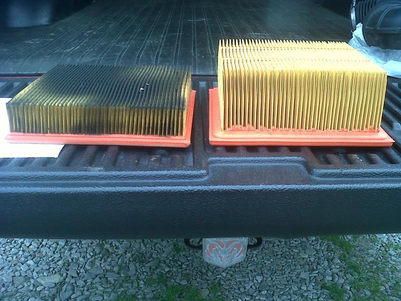

The filter I use is the Mopar 4" pleated filter part # MO-249 if I rember correctly. It is pictured on the right beside the smaller Mopar filter it replaced.
