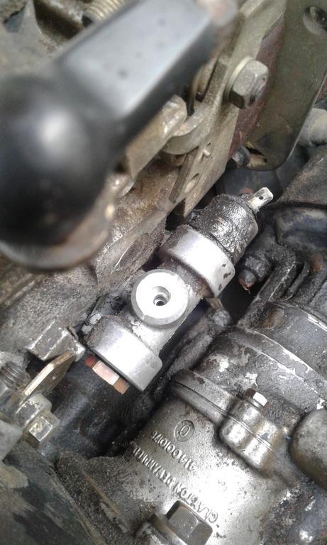

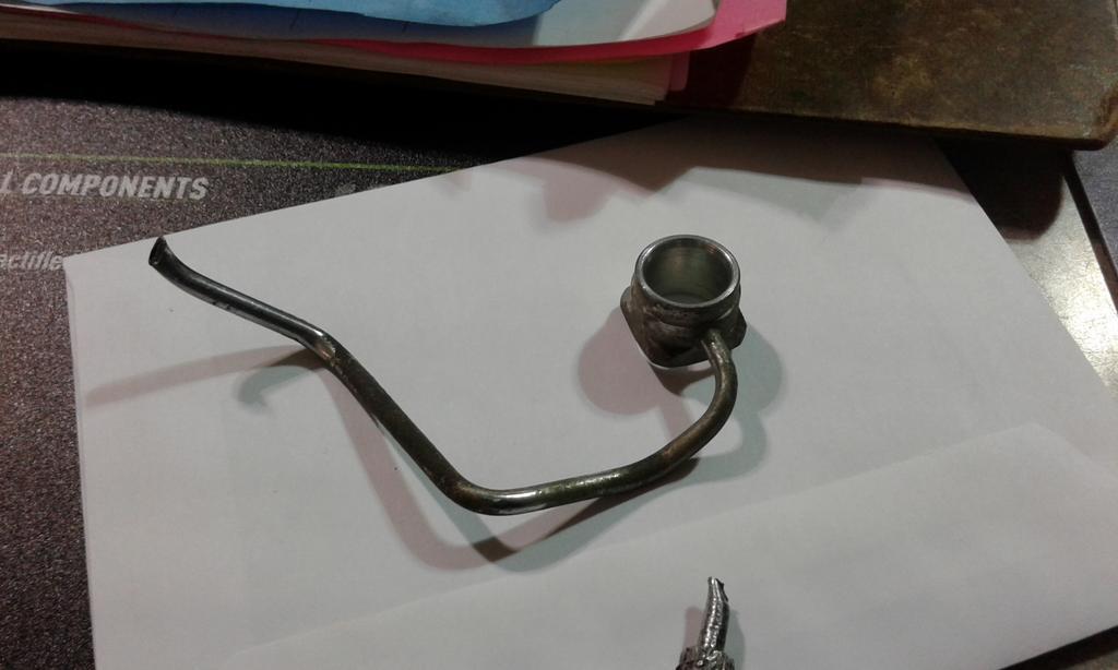

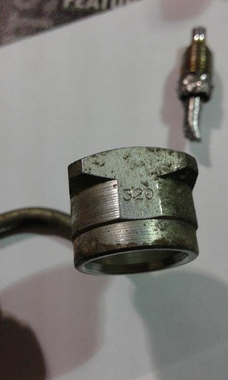

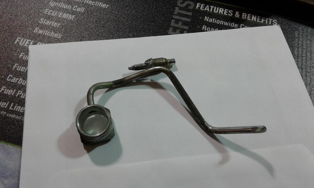

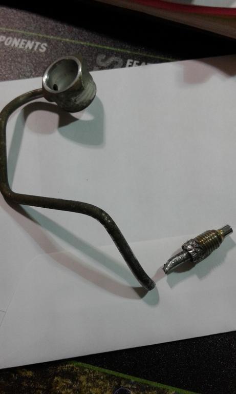

1991 intercooled purchased new .ksb is leaking.had worker who replaced seals. then found it was leaking from line at top of ksb. whenthay could not get it to turn out thay cut the line ???? I now have it on my desk and can find no one who can find a part number for it. this is my truck!!! I requested it be laid to rest with me when I go. need help please. thanks Quick DRAW.
Probably not serviced separately. Go to a Bosch authorized injection shop and see if they can come up a part # or just a salvage part.
This line?

Quickserve doesn't break the pump down as far as I can see. The image I posted was from QiuickServe.
My local pump shop told me there are two different versions of that line. He asked for a pic to ID it.
the non inter cooled had wax that would melt causing the advance to drop. the 91!/2 intercooled has a different kbs. if I can find some here smart enough to take a photo and post it I will. as fore me getting the computer turned on maxes out my talent.

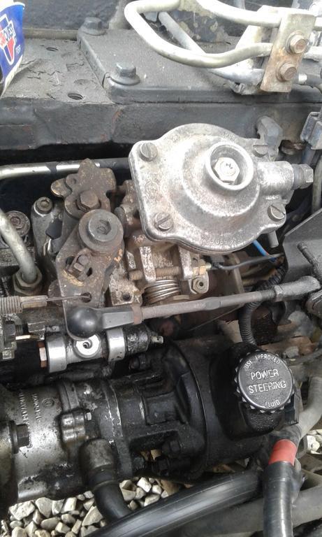

here is a few pictures of my promblem
Not to highjack sorta, but, my KSB is leaking at the nut on the end toward the radiator. Who makes a rebuild / seal kit for those things ? ( ‘89 1st. Gen. W250 )
