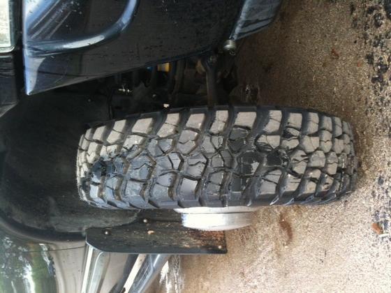

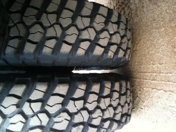

thanks for the replies! for now I had the local tire center order BFG 255/80R17 MT KM2 tires. I went ahead and ordered 7 tires to give me a new spare as the current spare in on the drivers side front and not to mention a different size. Will post some pics when they come in and have them mounted. Can't wait to get them on!

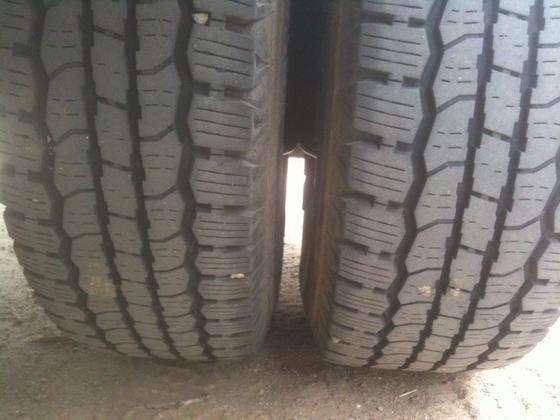

Pictures. One is a pic of the OEM stock tires showing the space between the duals.
