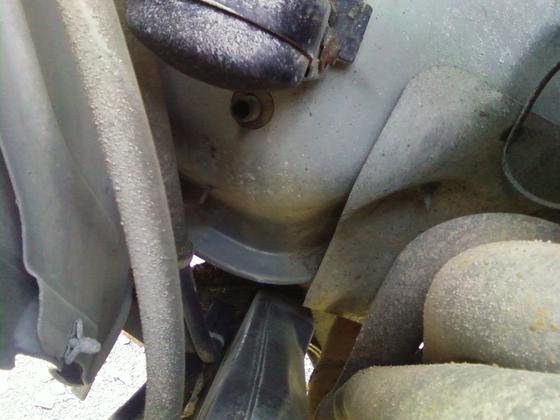

It may be obscured by isulation, if it has it, and the insulation has gotten loose and fallen away from the firewall. It's directly at the bottom of the A/C box, through the firewall, behind and under the dryer. Pic is from frame, looking back under firewall from front of engine compartment... . this is in my '01 gasser rig, but it's the same.....
