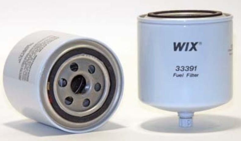

This is a common issue. Mine failed three times. I found a Wix 33391 that has a plug in the bottom of it to drain if you need it and does away with the junk drain valve.
Here’s a good thread on it.
https://www.turbodieselregister.com/threads/water-in-fuel-sensor.266108

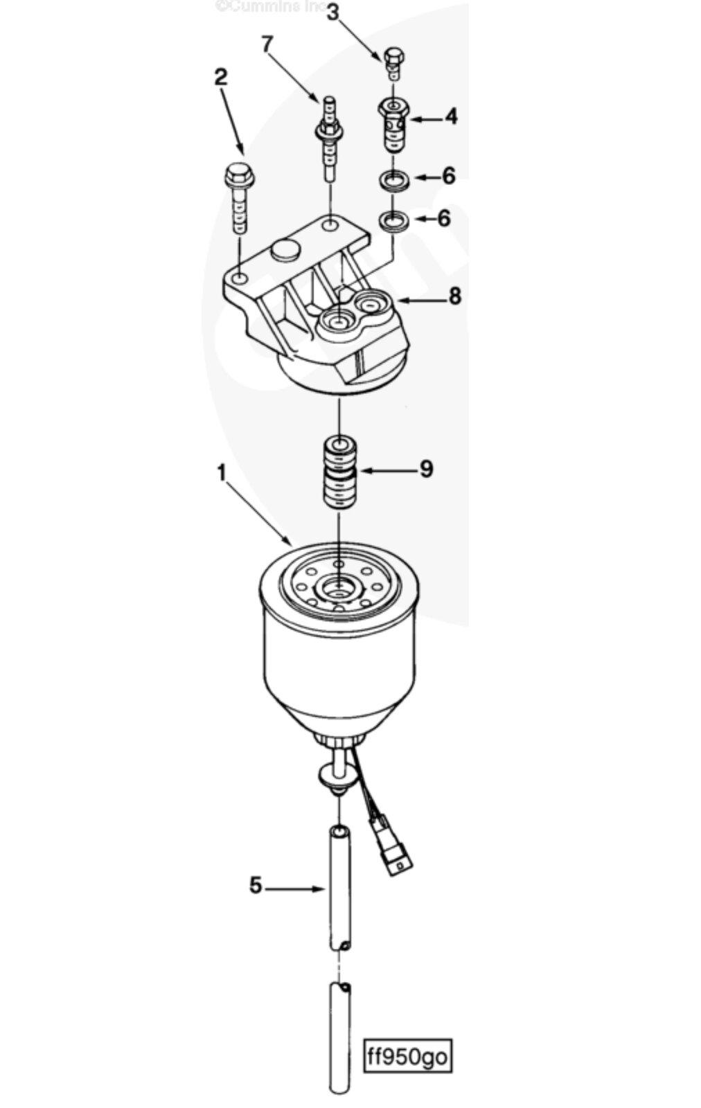

I had the issue with the 2001.5 RAM and it was an under sized o-ring between the valve and the filter housing and not the valve it's self. As I recall the valve mounts with just one bolt.
We’re talking 12-valves, SK. The valve and sensor screw into the bottom of the spin-on fuel filter.
Yes, they did. But, they offered a valve kit with new o-rings to repair it and they didn’t leak that often or that bad.
The first time mine failed I was sitting in a drive-thru and a fellow walked up to my passenger window and said I had something leaking. In the time I sat there it had leaked a puddle of diesel fuel @ 12’-15’ diameter. I had smelled diesel while I was sitting there, but it was at a truck stop so I didn’t think anything about it.
'96, My new valve leaked when I installed it, I grabbed a different oring out of a new filter if I recall.
I figured the oring was just not correct or it was my error on install. But sounds like it was the oring in the kit.
