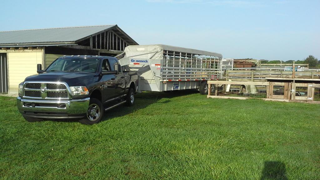

Gonna break in my unagoose hitch next weekend (installed it in March 2015, never used).
6800 lb (empty) 24 foot general livestock trailer with no stalls. 10 calves/steers probably averaging 650lbs-700 lbs each.
Hauling them 150 miles. Looks like the pin weight will be pushing the limit of the payload on the Ram 2500. I know they've hauled this trailer similarly loaded in the past with SRW. (F 250) But their F 250 broke down last year in transit from the same location. So I offered mine.
I'll be using the exhaust brake alot. I think we plan to tie the bridles to the bars on the side (leaving some space to move in case they fall) prevent load from moving too much.
Anything I need to watch for? Never hauled livestock before. I work at an agriculture school. These steers will become student projects to be auctioned in the spring.

Broke in my GN hitch. Worked like a charm. I might have been a few hundred pounds over what my truck is rated at on bed weight.
10 young steers. We are about to load in the picture. I was to busy today to be a photo journalist, but stepped back to snap one pic.
260 miles. 24 ft trailer.
In August, we used my truck to transport cattle from central florida to south florida.
