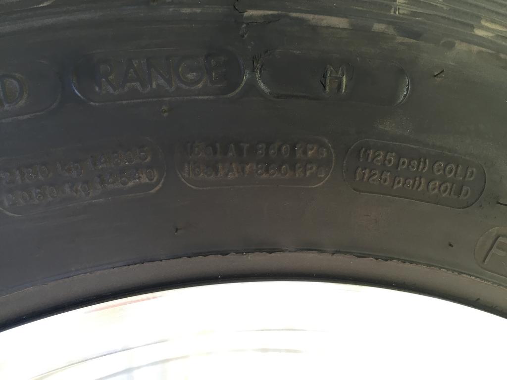

I'd like to appeal. Both Goodyear and Michelin (on their XTA) seem to cycle back and forth every time they run a new batch of tires. I've seen both tires with 120 PSIG and 125 PSIG max cold inflation pressures molded into the sidewall, so I may or may not be incorrect depending on the batch of tires you have. :-laf Here's another one for you - both the Goodyear G114 and Michelin XTA are rated 4805 lbs, but Goodyear calls theirs Load Range H and Michelin calls theirs Load Range J - go figger....

That H & J rating is strange.
