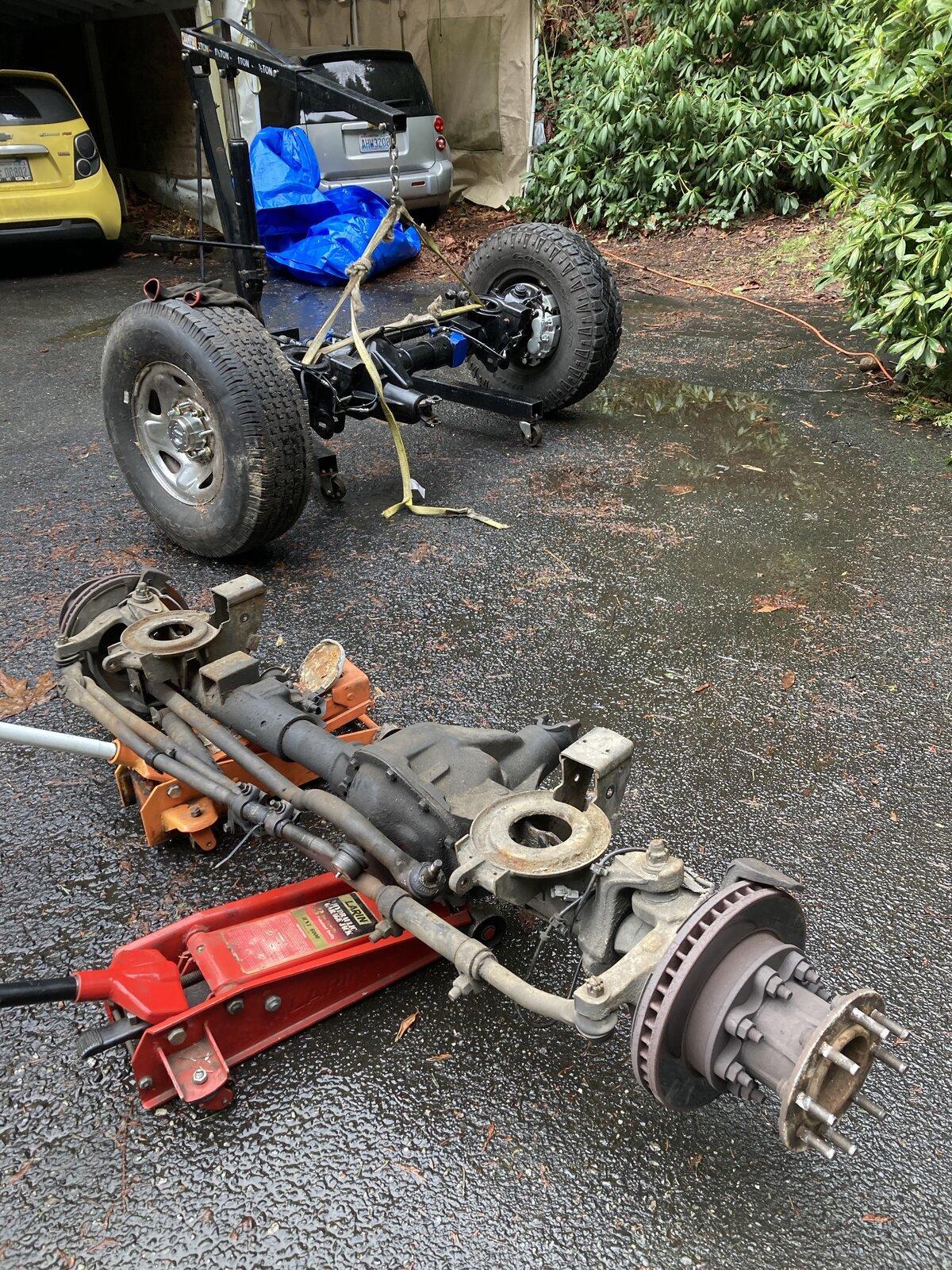

When I did my free spin install I went to a newer axle. From the 99 to a 2002. In 2000 dana upgraded the 60 axle with bigger axles and it has the two piston brake calipers. I rebuilt the axle and upgraded the steering components. The great part was I was able to sell my old dana 60 for what it cost me to purchase to 2002 axle. R&R the axle was only 4 hours.
