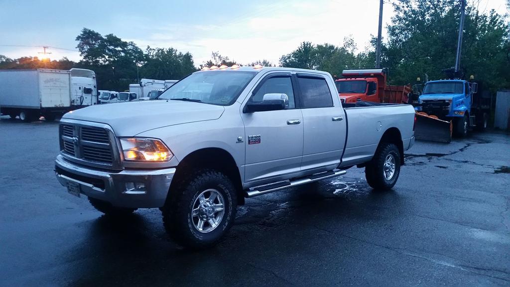

With cap the day he bought it..

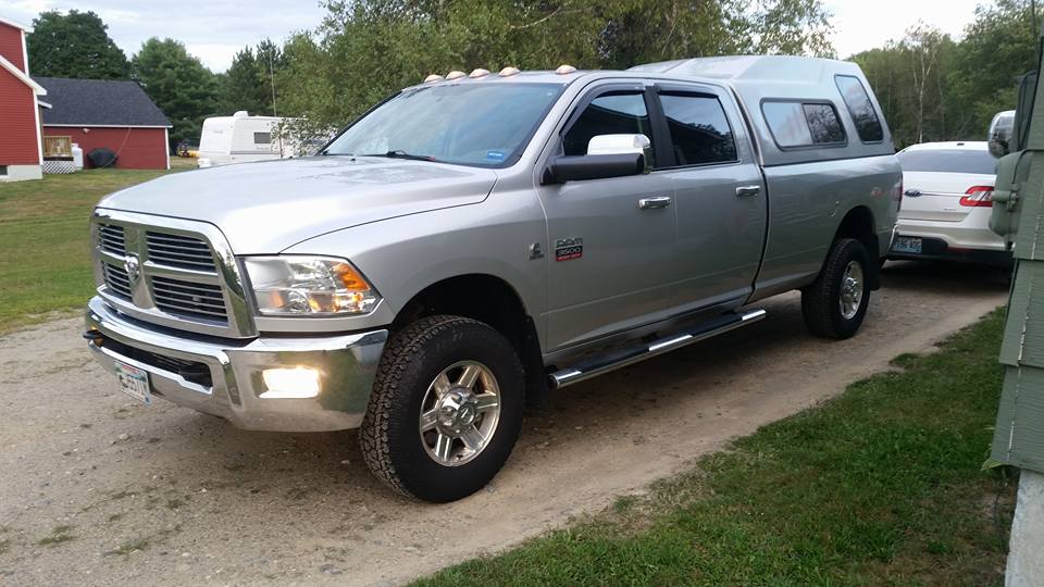

After cap removal and trip to paint shop....

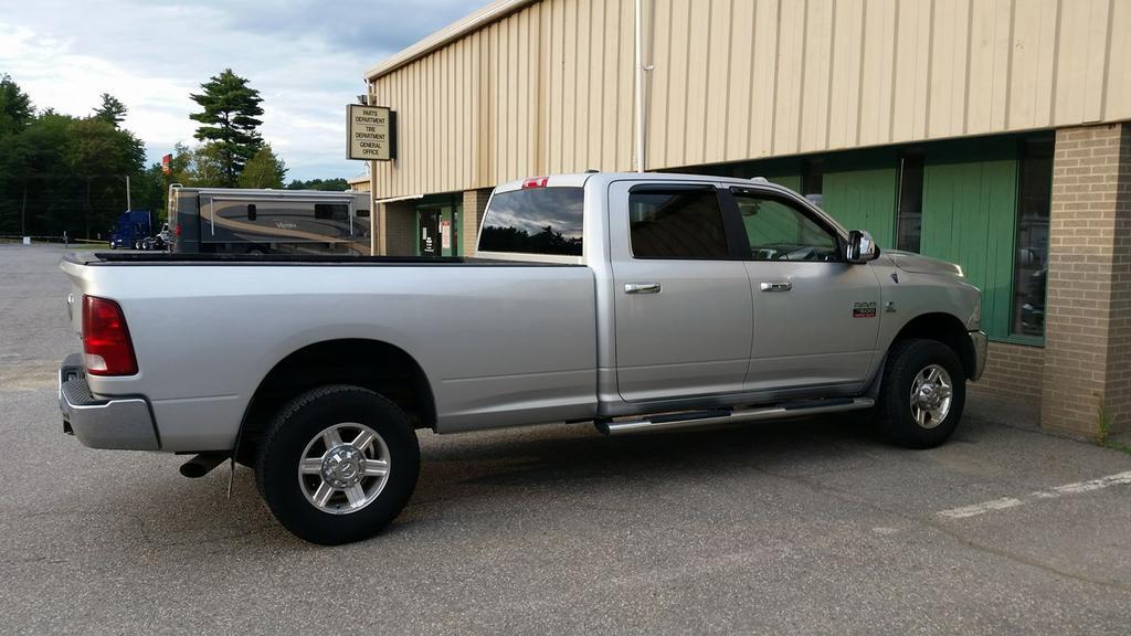

After leveling kit.....

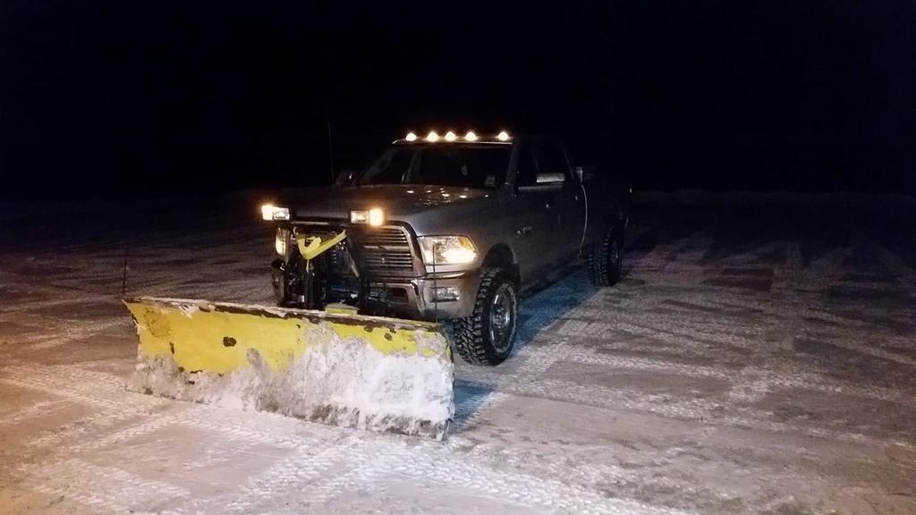

And finally after plow install....
