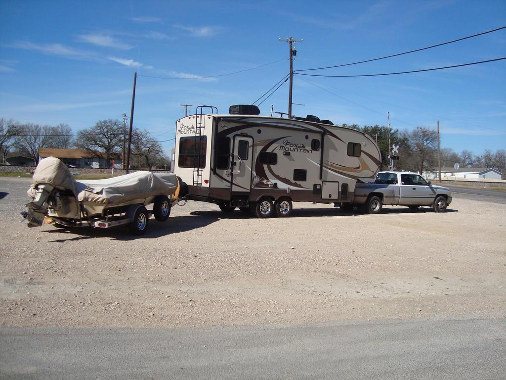

We had one long ago. My wife drove it under a tree and ripped the roof up. They don't fit our need anyway. The primary use is going to the lake with the boat, we can double trailer here in TX. With a motor home launching the boat sometimes involves having to put the rear of the RV into the water and always involves having to wade in the water to drive the boat off the trailer. Recovery means unhooking all the umbilicals, putting away anything that can fall on the floor, and rehooking up when the boat is retrieved. With the 5er I get to the CG, disconnect the boat, park the trailer, hook up the boat and go.
