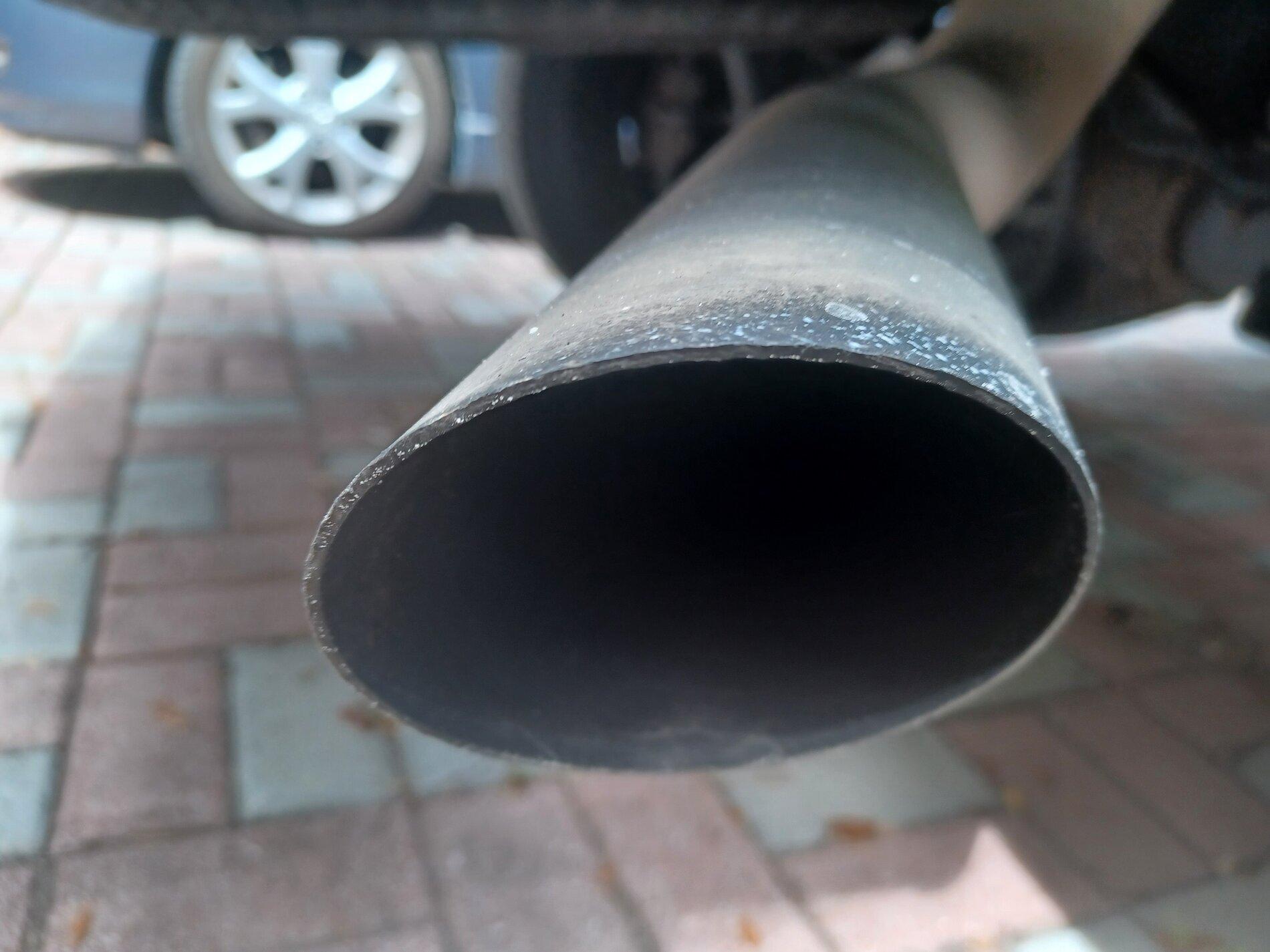

Is this the same guy you mentioned several months ago when I mentioned his SCR / exhaust might be restricted with caked up DEF?
If the DPF is good, you should have zero black soot in the tailpipe, even with several hundred thousand miles.

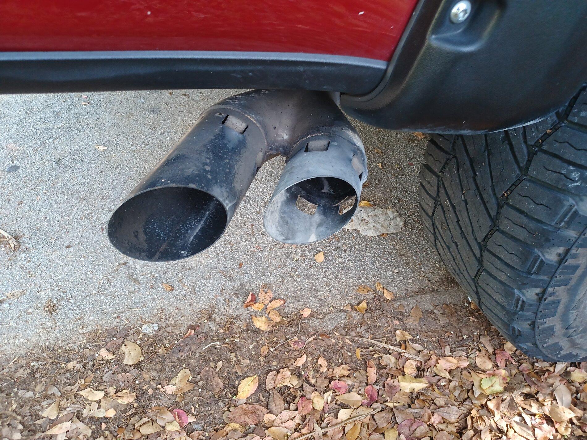

Newsa that is what my friends 13 looks like. The Service guy was not in on his appointment day and they had no clue what to do but scan the truck and charge him $200. He said NO WAY and has yet to get a new appointment. The rookie service guy wouldn't let him talk to the Tech.

Regen and soot have exactly ZERO to do with SCR.
I realize they are separate, however I thought that the DPF was upstream of the SCR. Thus, if soot is coming out the back side of the DPF, it might coat parts of the SCR with residue.
Possible, but your tailpipe would also be black.
You linked the two systems by making comments about a high nox code and active regens, no link exists.
Do you have a sooted up tailpipe?
The SCR is not a particulate filter, so soot in would be soot out.

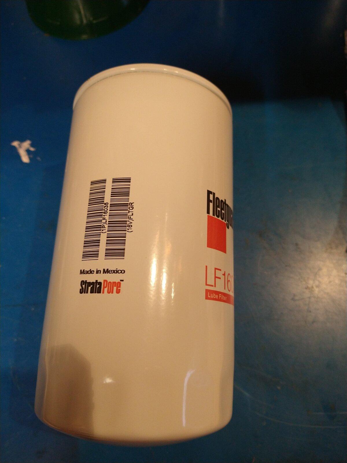

@Cummins12V98 here you go. I've been using them since 2002 and never noticed that. And my first 01 was made in St Louis.
Truck is made in Mexico, we might as well use Mexican filters![]()
Truck is made in Mexico, we might as well use Mexican filters[/QUOTE
Might as well give up and buy everything from other Countries!!!
My 98 12V was Made in St Louis and my other 12V.
Really appreciate the pic as it saved me from stopping at MotorTruck to take a pic of a filter to prove to this guy on another forum that insists the filters are US made as he knows the rep. Like a friend always says "prove it".
Thanks!!!
