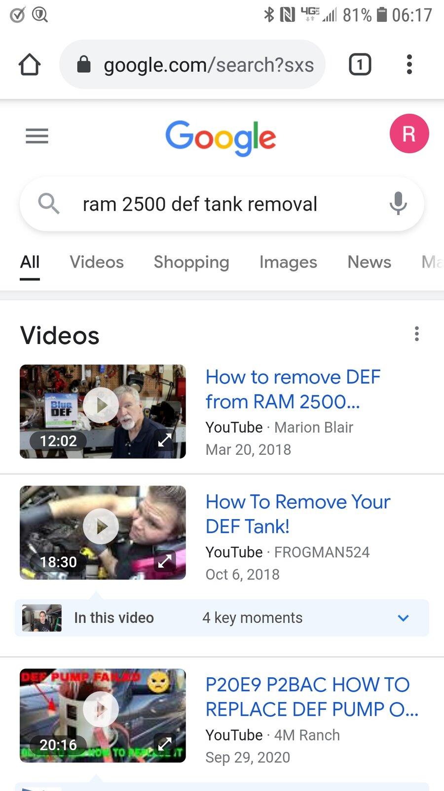

Try YouTube to see if there's a how to on removing it. A lot of serious deleters out there remove all the emissions related part. I searched and see several videos.
