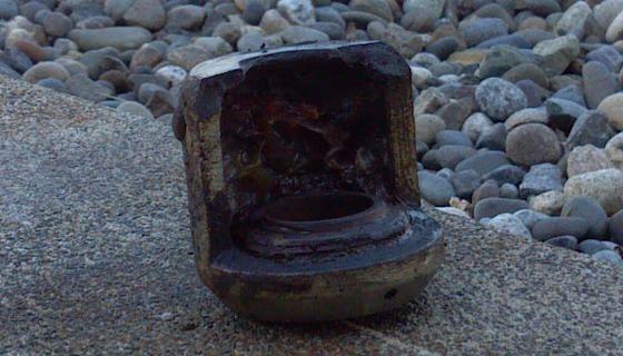

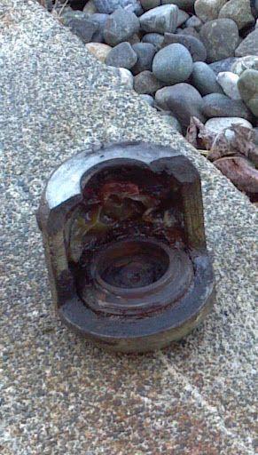

Thanks for the info JMcCoy. After looking at it carefully, something didn't look rite to me. I took it into the local Alignment Shop for them to evaluate... it appeared that the top portion of the link was gone. Thank god I wasn't cruising down the highway at 70 and this let loose!!! I will try and post a couple of pictures of the failed Lukes Link when I get a chance.
My guess is that the joint became so loose that it cocked at an angle and broke the joint. I broke one of my joints during my first install. Of course that was my fault. I decided to try to beat the joint on instead of grinding the end more like I was suppose to. I would give them a call.
