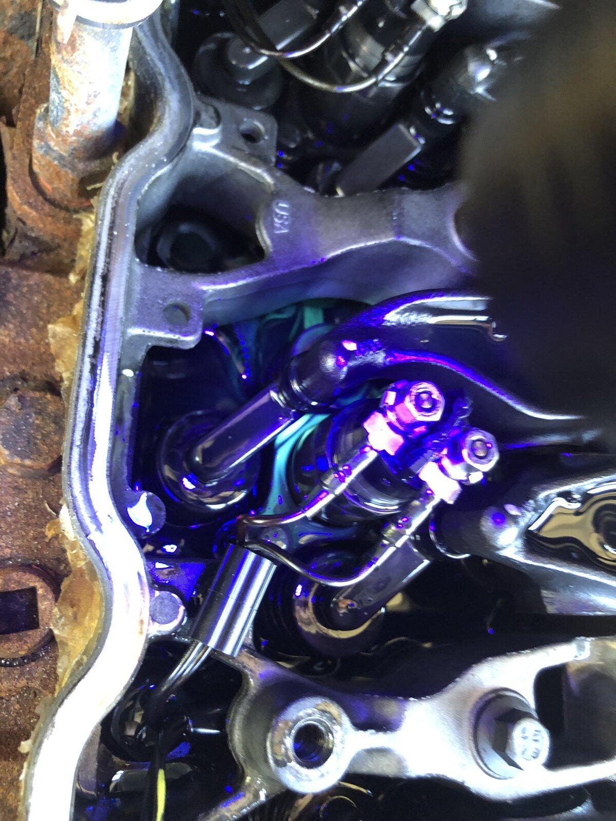

I actually got a new lift pump from THD and it still doing the same thing, so now it is down to the injectors OR the IP and since checking the injectors with the dye or wisp of smoke with valve covers off is much easier that is the first..otherwise IP coming off..still under warranty but a bunch of work so hoping it is in the injectors..and the truck has 353,000 miles so.
The die should tell me whether it is coming from the injectors or if found in oil BUT NOT injectors then I think it's a given that it is the front seal of the IP..I think..if you guys can think of somewhere else other then those 2 places..let me know..the hunt continues :)

I bought a dye kit and UV light for $30 and put the dye in the fuel filter. Ran the truck for 30 seconds then pulled the valve cover.
#3 injector was leaking. Replaced that injector and the problem is solved.
It’s a cheap and easy thing to do, I suggest starting there.
