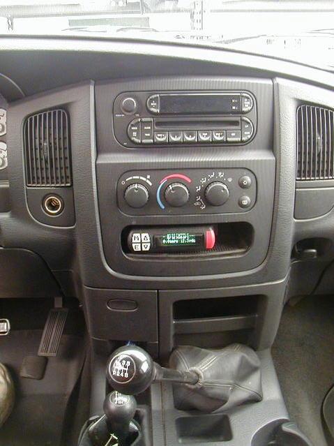

You could always mount it in the dash cubby, like I did my BrakeSmart...
Can't hit your knee on it getting in and out of the truck, easy to wire, easy to access while driving if needed, and looks pretty dam good... . there's even still room on the side fro a cell phone or something else.
I don't think instillation will work for a MaxBrake as the MB has a manual/emergency lever on the bottom of the controller.
