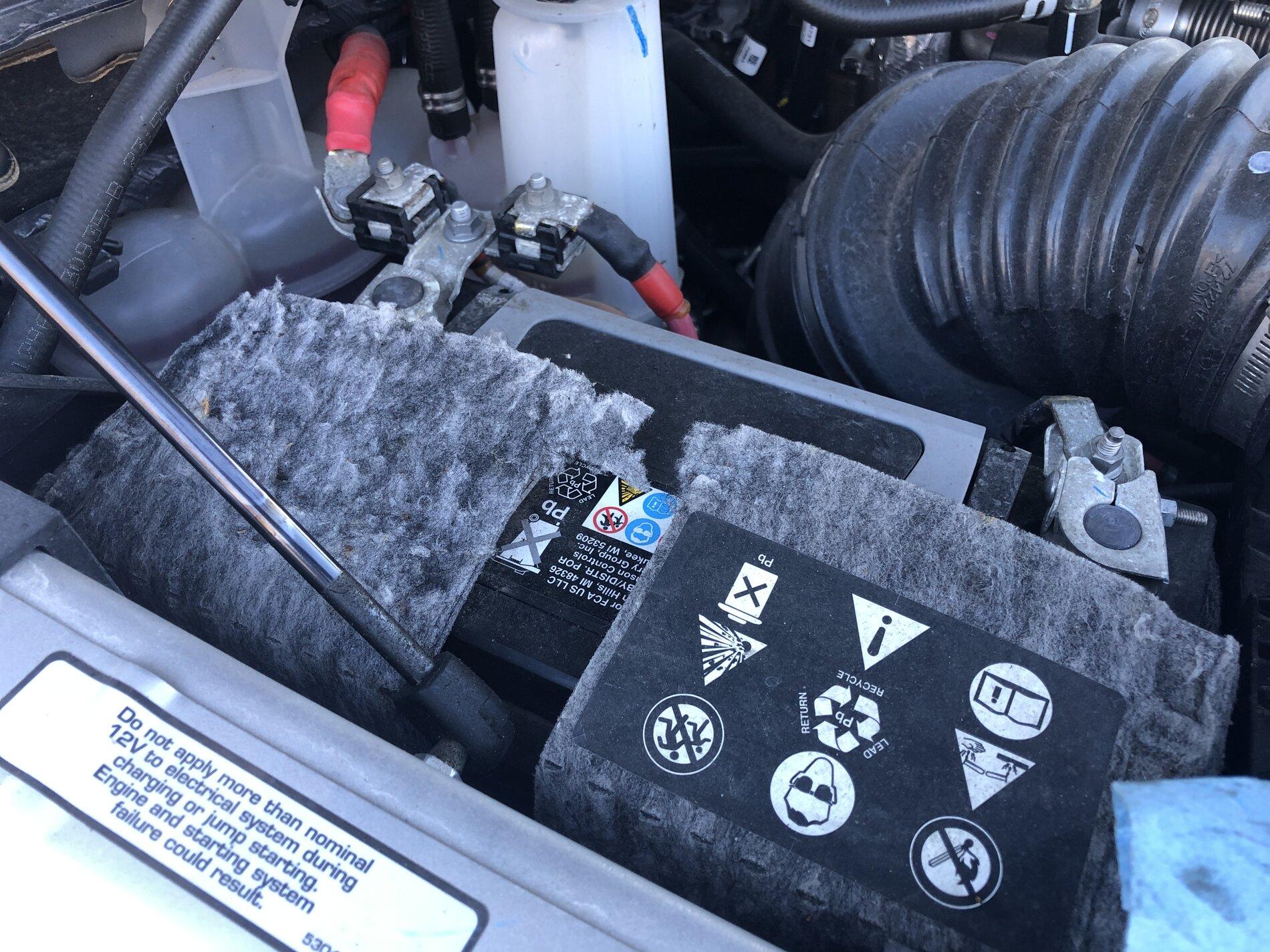

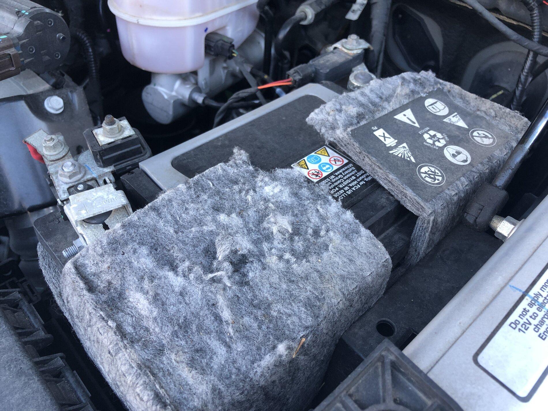

Every vehicle I have bought new over the last 15 years has had a wrap on the battery(s). If the battery is in the engine compartment there will be a wrap. All these were set up for AZ, so the manufactures have no incentive to add any cold weather options that aren't needed.
Insulators serve one purpose, slow the transfer of heat from a heat source to a heat sink. The battery doesn't generate heat (except a bit when being charged) so it will be a heat source if the surrounding air is cooler, a sink if the surrounding air is warmer and neither when the air and battery reach the same temperature. The engine is a heat source when running so the wrap reduces the transfer of heat from the engine compartment into the battery. Heat will kill a battery faster than cold will (just ask any AZ desert dweller that goes through batteries ever 2-3 years); however, cold does reduce capacity but doesn't kill the battery unless it is left discharged which makes is subject to freezing.
When the truck is shut off in cold, the battery is initially a heat sink until the engine compartment gets cooler than the battery and then becomes a heat source. By the time you come out in the morning to start the truck the battery is at same temperature as the outside air so it is neither a heat source or sink and the insulation is doing nothing to help the cold cranking.
Now the electric battery wraps are for cold to help keep the battery capacity up by not allowing it to cool.
