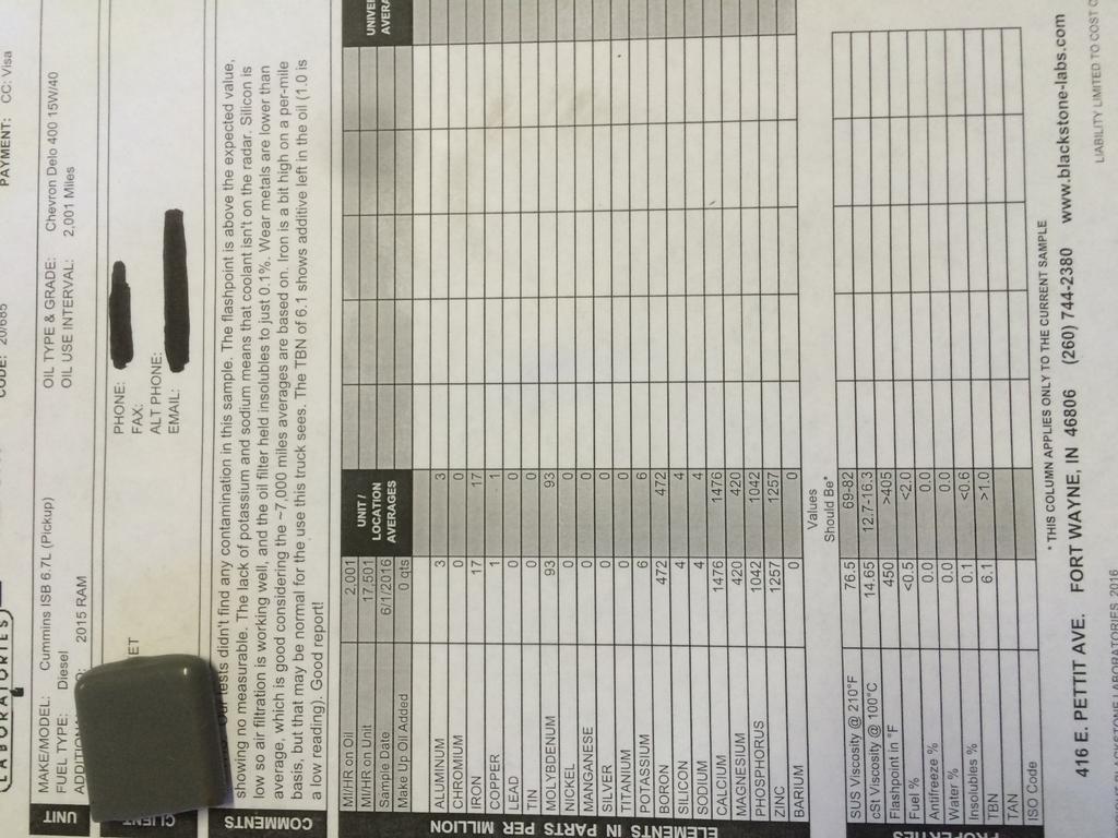

Here is the Lab Report from the Milky Oil....
Another reason I think blackstone sucks... TBN of 1.0 is not serviceable oil. Cummins only allows TBN to degrade to 50% of it's original value before the oil needs to be changed.
With only 2,000 miles on the oil the TBN is VERY low, IMHO. Something is depleting it very quickly. Delo 400 LE 15W-40 starts at 9.3 so the oil was 75% "used" in 2K miles. TBN should have been 8+ with that few of miles, IMHO.
Looks like a very good oil sample. No water or anti-freeze and little to no fuel dilution. So, what is causing the milky oil appears to be a mystery!
