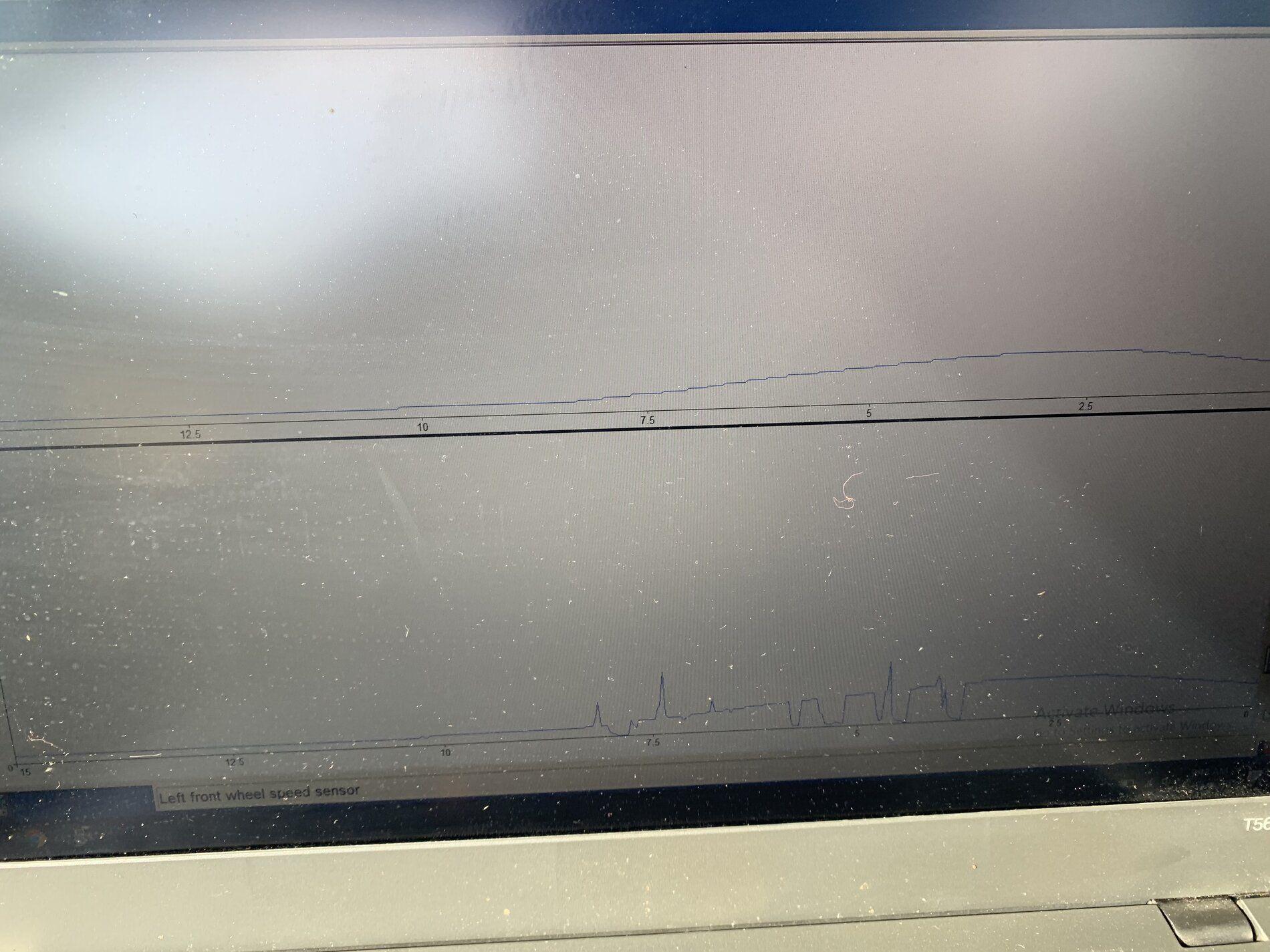

There could be an issue with the reluctor inside too. The setup is just like our Rams. It’s getting another whole unit.That bites.
At least the sensor is easy to change.
