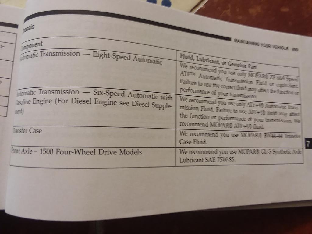

This is what is called out in my owners manual for my manual shift transfer case. Is there an acceptable alternative to the MOPAR BW44-44 transfer case fluid or is this the grand pumba of fluids? I only ask because (1) I do not have a dealership nearby and (2) it is quite pricey! Although not necessarily in the grand scheme of diesel pickup ownership :-laf

My Diesel Supplement Manual says to check the transfer case fluid every 30,000 miles and change the fluid every 60,000 miles or 48 months.

I suspect not but there is not one single spec on the bottle other than it is essentially a 32w oil...yet it is red in color so it obviously has some different additives than hydraulic oil. I ended up buying 2 quarts through my local dealer@ $33 a quart :eek:
Stupid expensive, yes, but not worth the risk to me.
