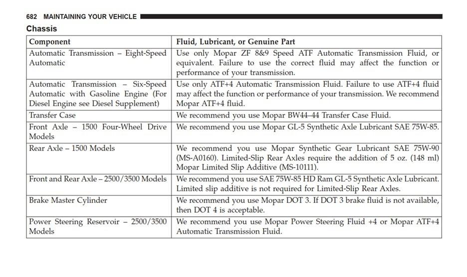

My Owner's Manual (P 682) states: "We recommend you use Mopar BW44–44 Transfer Case Fluid."

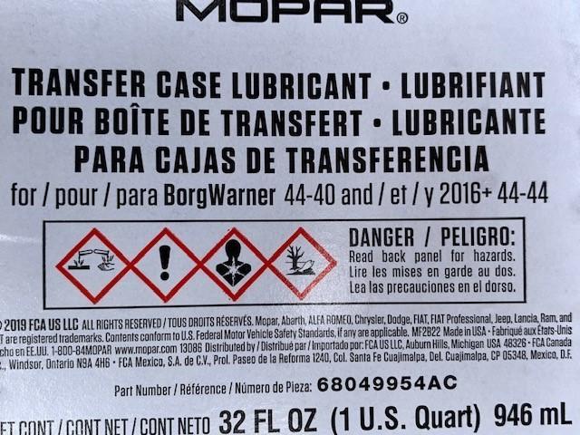

So my 2500 Tradesman apparently came with a BW 44-44 transfer case and the dealer telling me to use part number 68049954AA (clear) is consistent with your list above.
But this still does not answer the question as to why the OEM fluid in my TC was red...

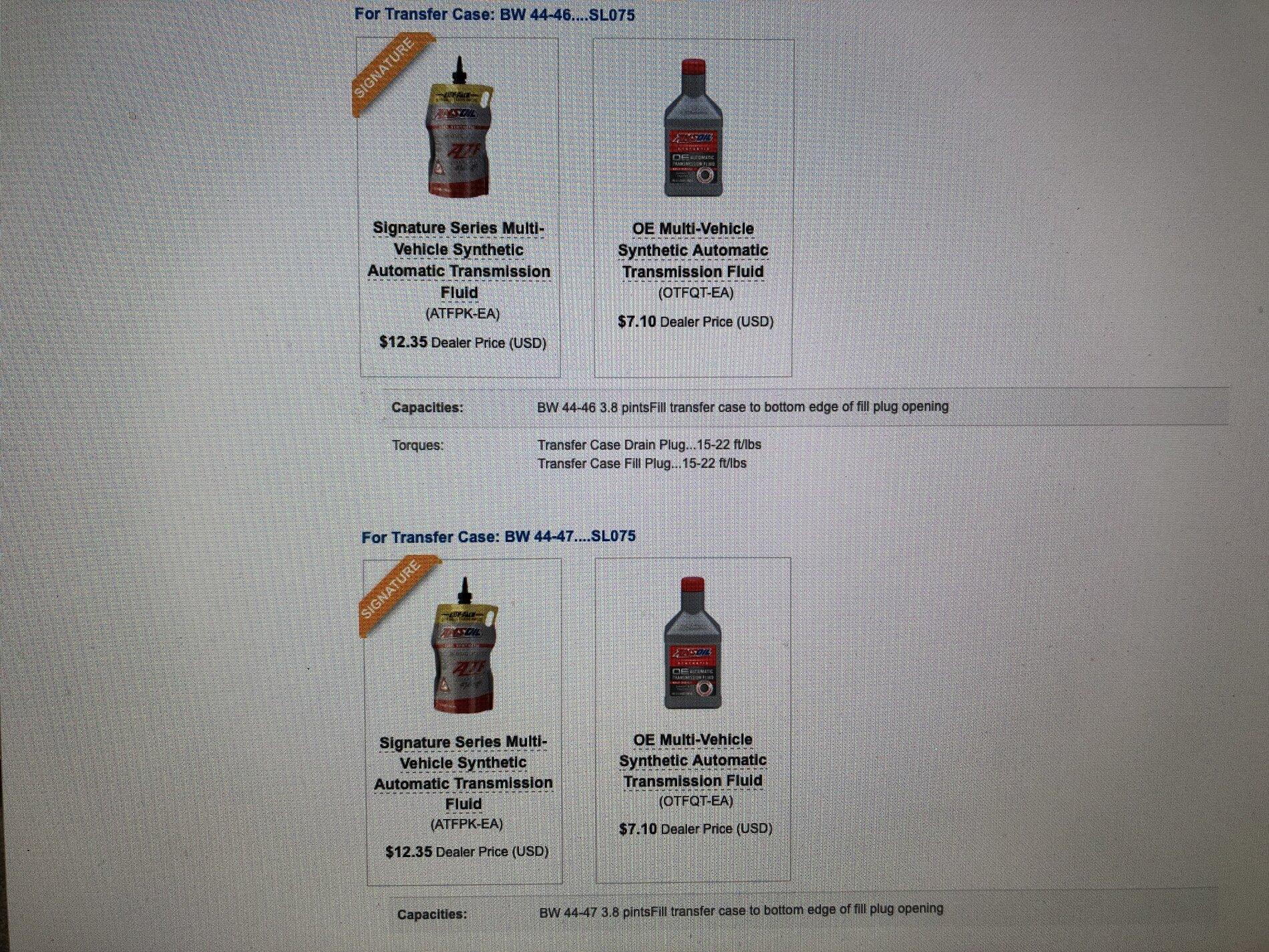

This may well be true but in both the Owners Manual and the Diesel Supplement for my 2017 2500 Tradesman the instructions clearly say to use Mopar BW44-44 Transfer Case Fluid. So now I'm more confused than ever...44-46 ,44-47 were the only tcase used from 14-18 in 2500/3500 trucks. the difference was one had dash knob with electric engage. the other was manual with floor shifter. both used same red mopar borgwarner fluid, although it may well just be atf+4 in disguise, but im not going to open that can of worms

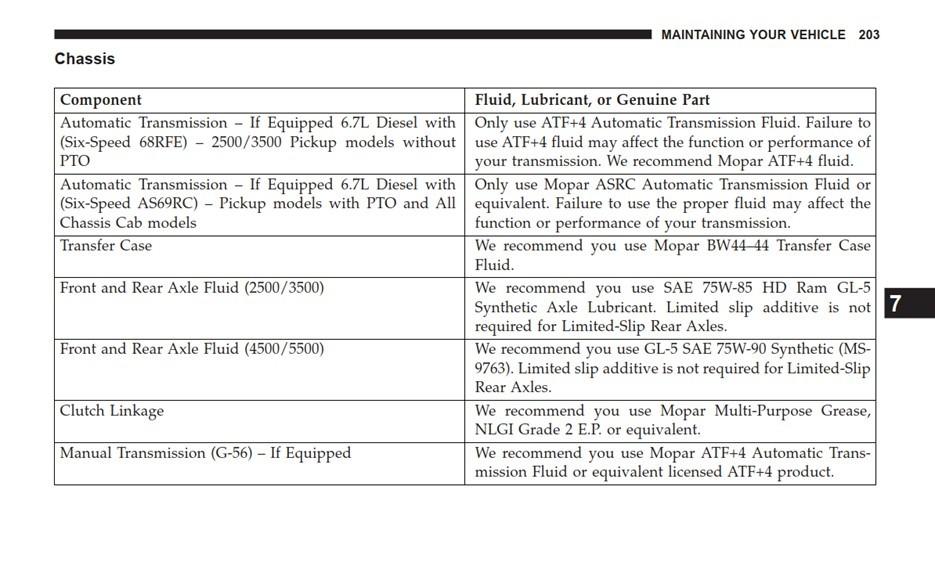

This may well be true but in both the Owners Manual and the Diesel Supplement for my 2017 2500 Tradesman the instructions clearly say to use Mopar BW44-44 Transfer Case Fluid. So now I'm more confused than ever... View attachment 127059 View attachment 127060
.... clear stuff im not sure, could be for 1500 or durangos
BTW, my 2013 owner's manual diesel supplement recommends 44-44 fluid.

your making it more complicated than what it really is. electric engage is 44-46. lever engage is 44-47. bw44-44 fluid is the name given to whats in the bottle. its red and very likely could be rebadged atf+4. this is the fluid you need. atf+4 labeled fluid probly would work just the same. dexlll probly would do just as well. the part#in the 2017 manual has been superceded but the new # is still red fluid, likely just atf+4. clear stuff im not sure, could be for 1500 or durangos
