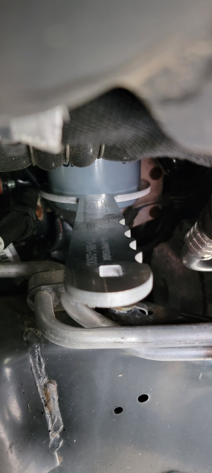

The fuel filters the self prime deal was super impressive, cranked right up.
The Genos tool was really nice. Filter came right out the side no issues or mess.

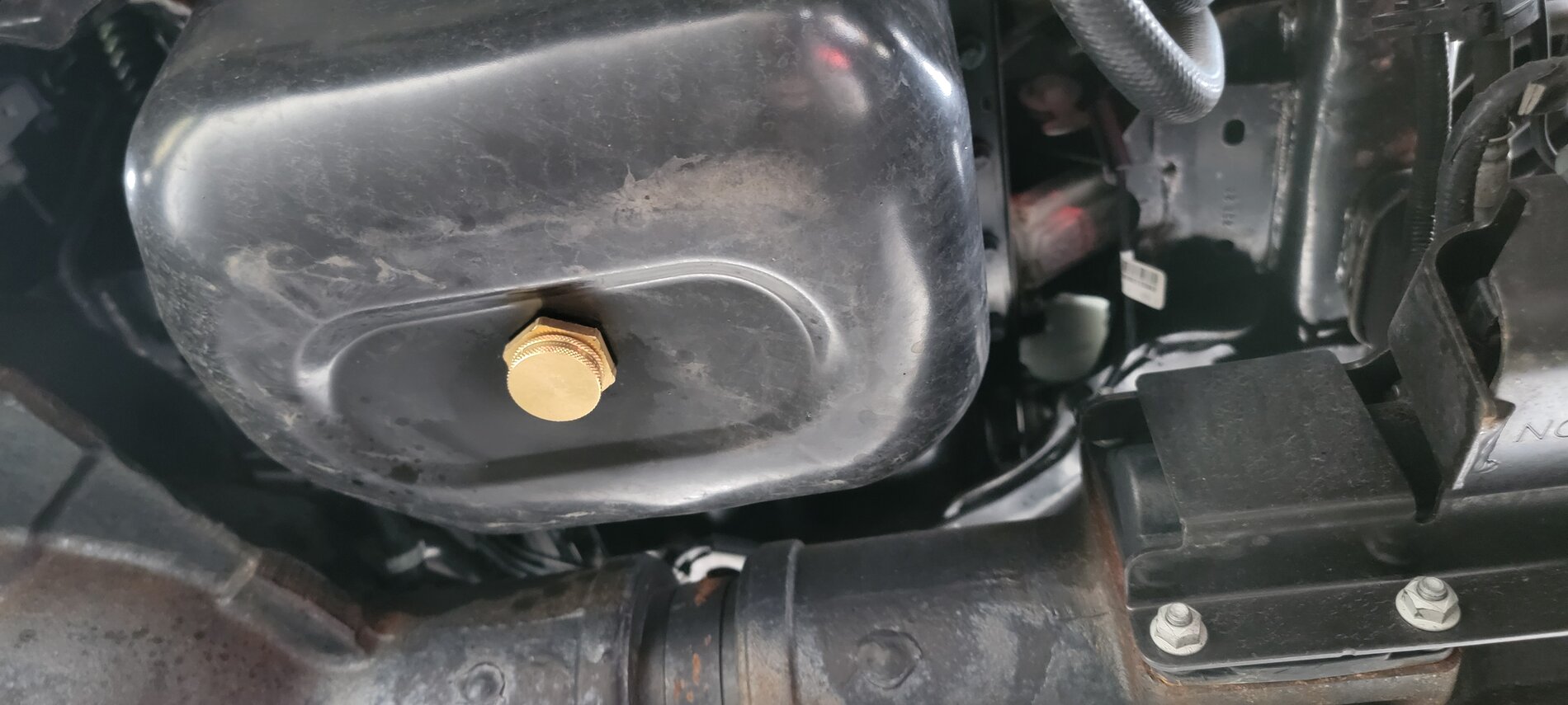

Installed the drain valve as well.

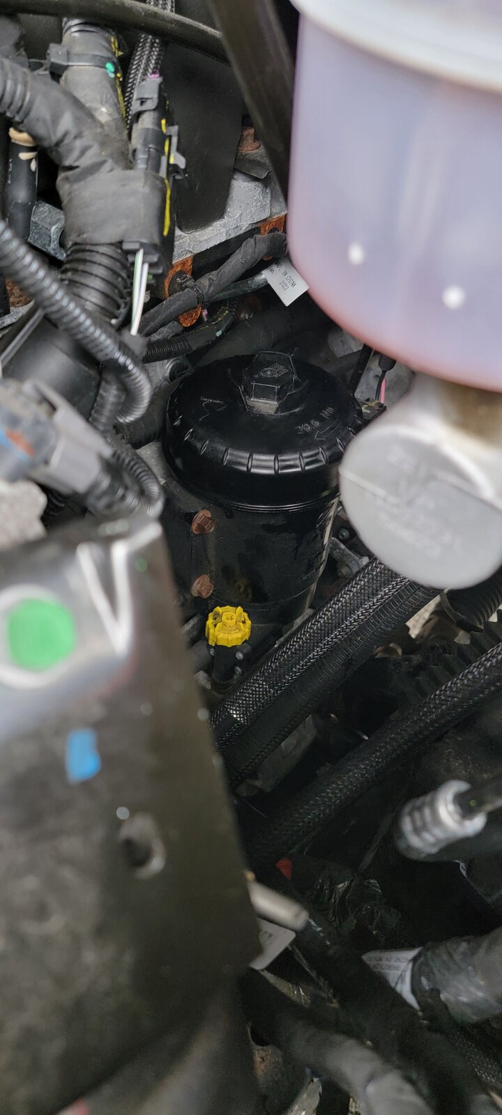

I was actually surprised by the mounting bolts for the engine mount filter how the rusted. Or to me they look rusted.

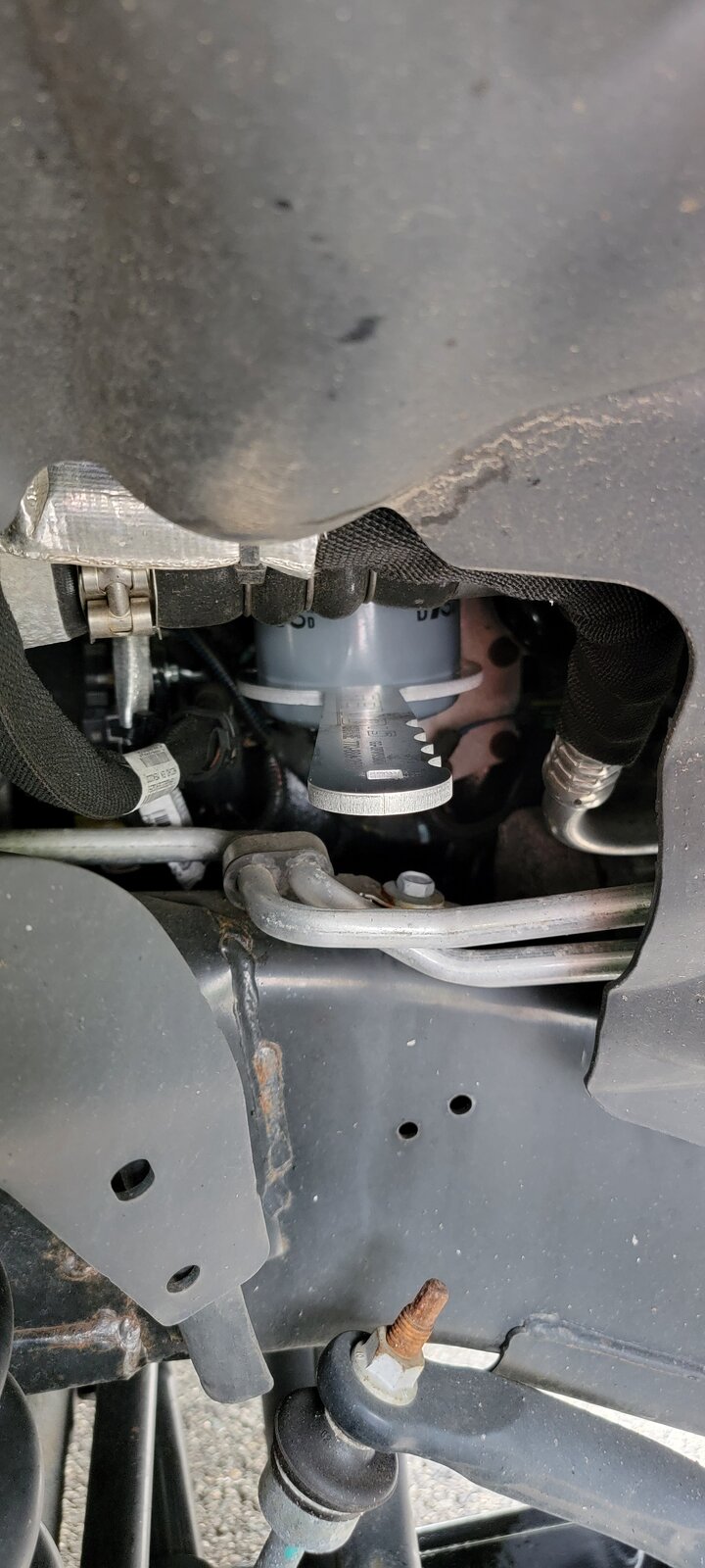

I stayed clean today till I washed out the pan and the stuff sprayed all over me, I was surprised the location of the rear filter right over the drive shaft, I had no clue where it was actually mounted. Wound up using the one hose from the pressure pot.for the brake bleder kit.

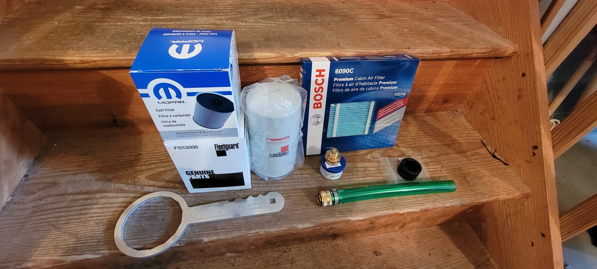

I think a cool starter kit would be..... (not a price savings kit, just a all in one deal order it and be done)
1. GENOS oil filter wrench
2. GENOS fuel filter Socket
3. 30" small hose for rear filter.
4. 1 chassis mount fuel filter
5. 1 oil filter
6. Engine mount fuel filter
7. Cabin air filter
I also would have loved if someplace had picked out all the fluids in one click buy it now deal.....
1. 12 Qt of oil
2. Proper oil for front and rear diff
3. 1 qt ATF+4 for PS
4. What ever that oil is for the ABS sensor deal, I thought about doing that. But not even sure it applies to be honest. Then need to add in that little syringe deal folks use. I think I already have some.

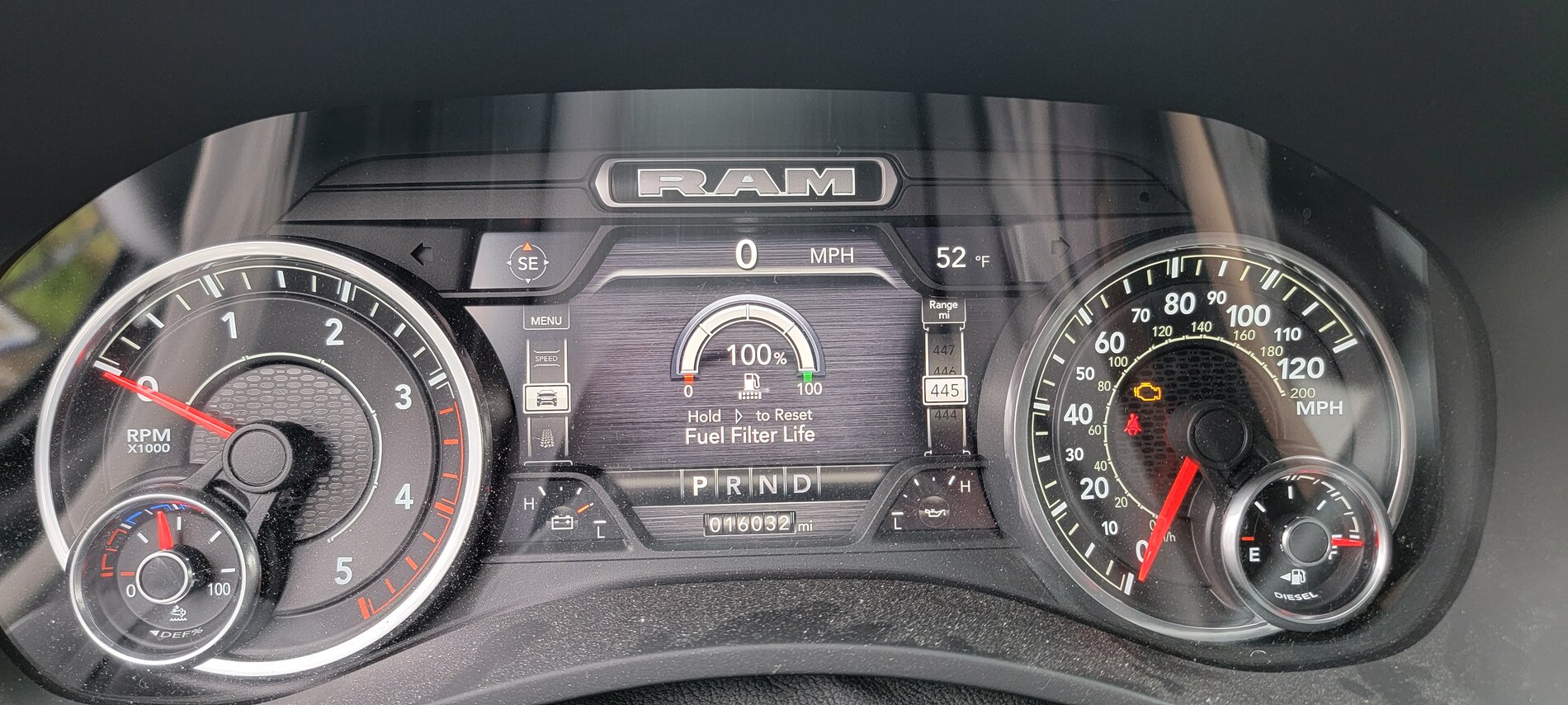

So I did both filters and the oil at the same time, when done went from ACC to Run for about 30sec, back to OFF. Acc to Run for 30sec, then off and then started the truck.
I rolled the window down and had the radio and stuff off. You can hear the pump run, but if your hearing is shot it runs for like 30s.
It does hit the grid heaters twice but I canceled the 3rd by holding the button.
It started right up was really impressed, not like a 12V instant start, but it was not even that stumble start it does at times.
