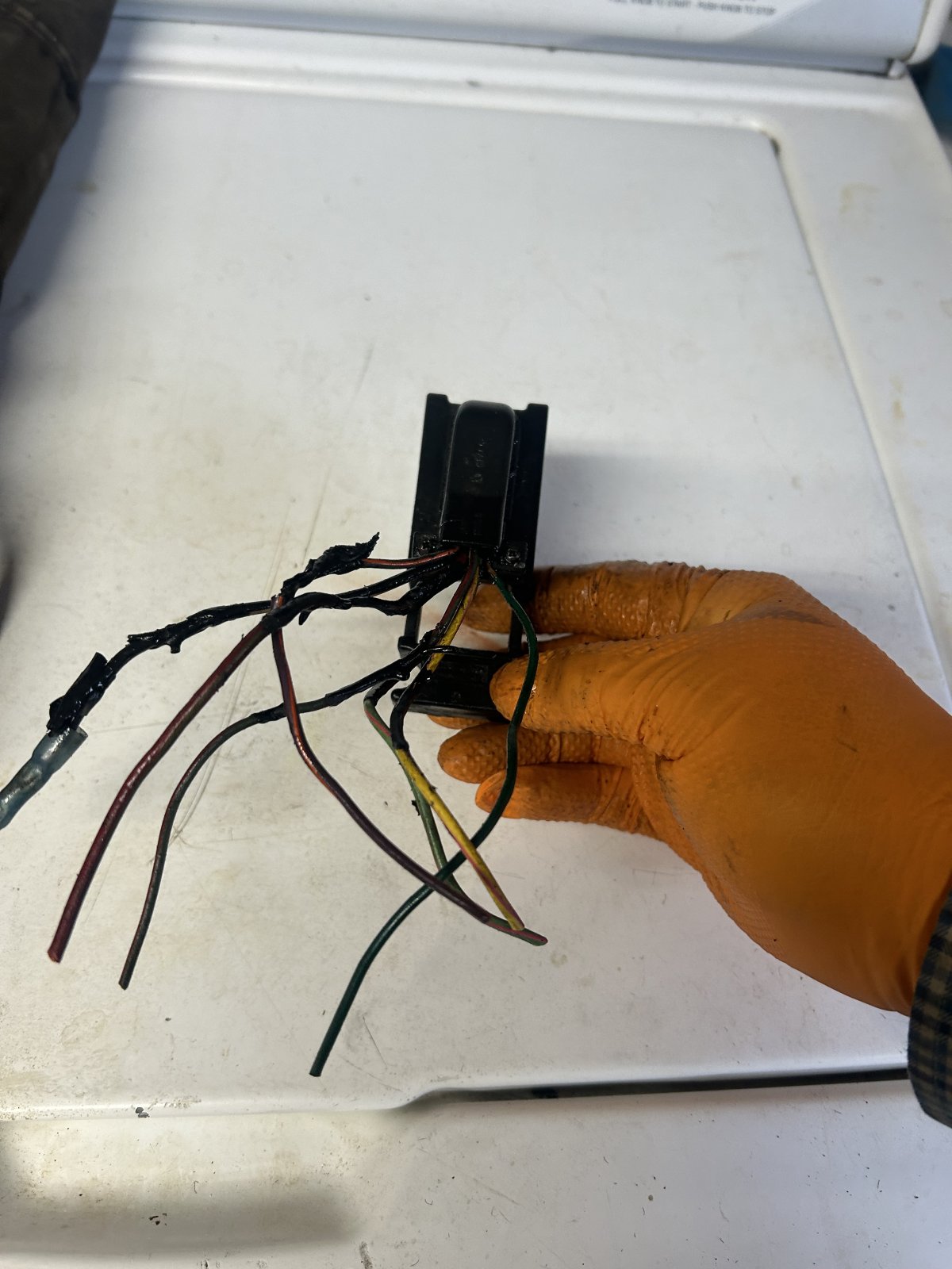

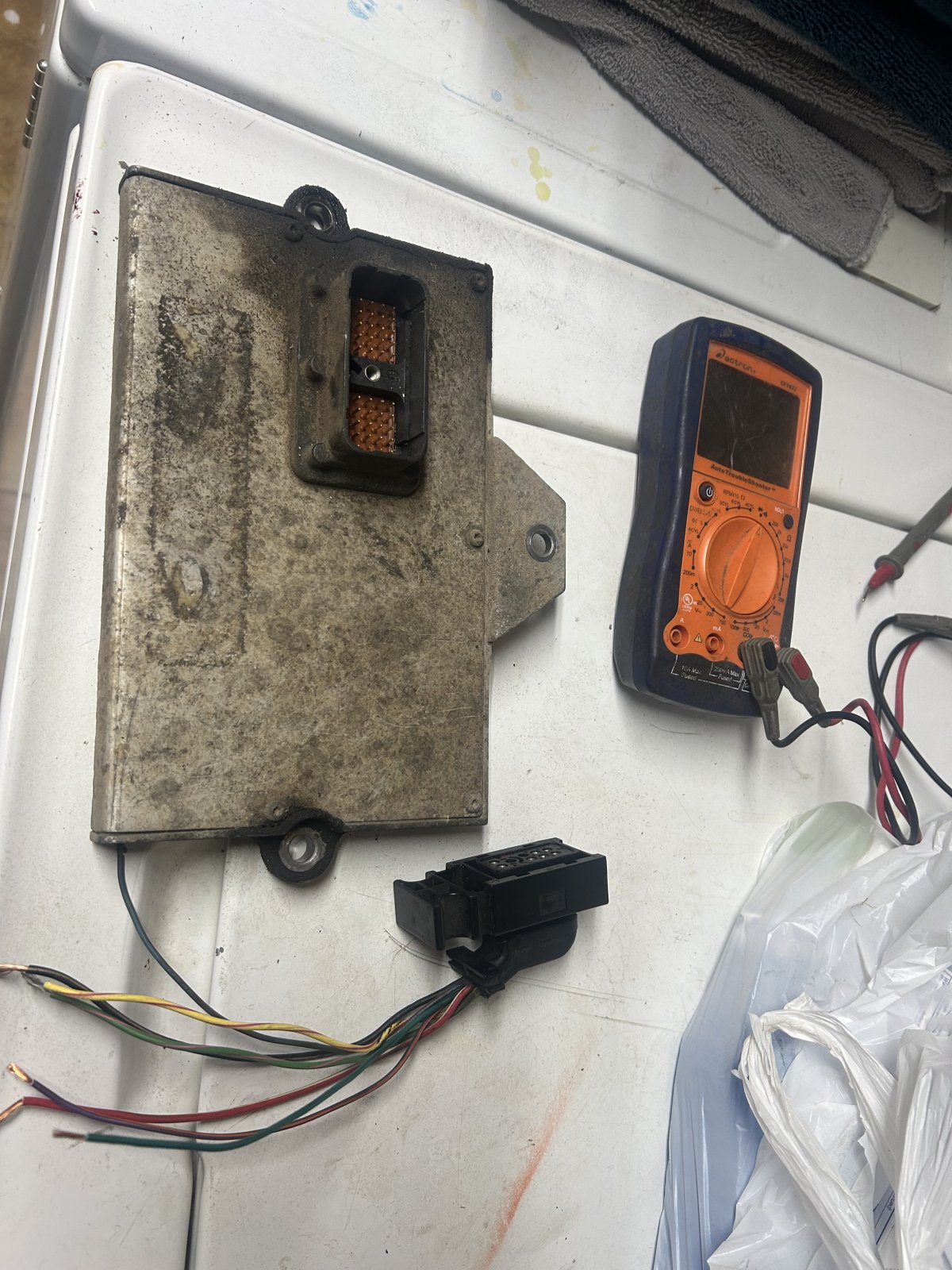

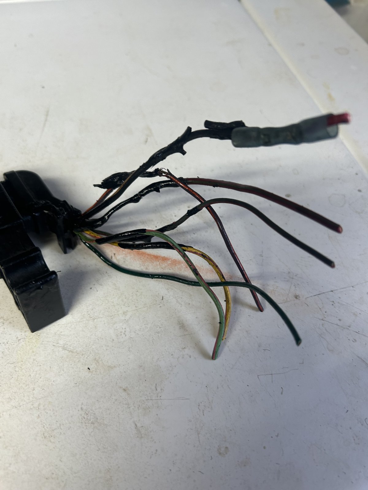

Why won’t this truck run 1999 3500 sport . Remanufactured pump from thoroughbred diesel no fuel at the number 1 cylinder and poor fuel delivery from the first 3 lines. Cylinder 1 2 3 . The cylinders 4 5 6 are spraying fuel . New fass ddrp pump 16 psi of fuel to the pump turn the key the pump runs a second then shuts off like it should . I have sent 12 volts and ground direct to the injection pump it still won’t run . Throughbred is sending me a breakout box What can it do that I haven’t done already ? I also checked the blue wire no power there just to be doubly sure I cut like I read to try on blue chips diagnostic pages . Not sure what else to do at this point . Injectors have been tested the original set out of the engine had one that wasn’t great I swapped them with another set I had tested and they were good . Power and fuel it should at least run according to what they tell me . Also removed the pump sent it back to thoroughbreds shop they say it’s perfect they say they could send me another but I don’t see any point in that
