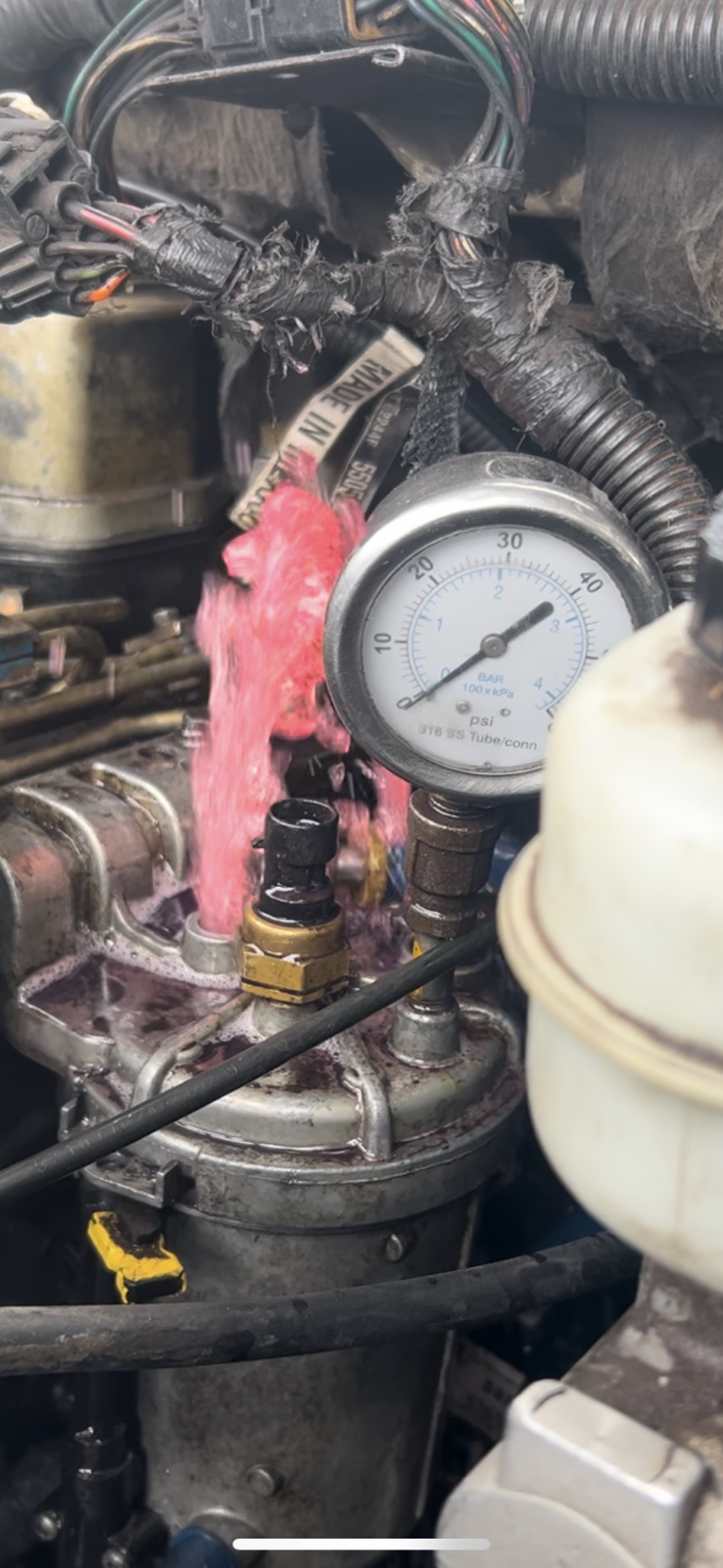

This was the fuel flow before I changed the dead intank pump looks like a lot of air to me . Next thing I need to check is if it still has air after the module change .

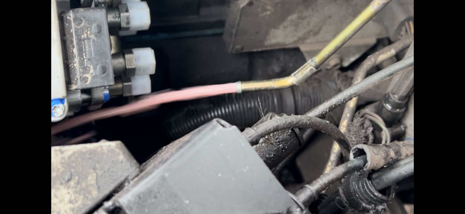

This should be enough fuel to idle a v16 emd i would think ? I replaced the ecm and the connector to the injection pump . This is the first time since this happened that I could fuel to all 6 cylinders , I’ve bled and tried to start so long I need a new starter now but I think I’ve got it figured
I still say I’m starving for fuel . Next step is blow back through the supply line . Or hook the lift pump to a five gallon bucket full of fuel
