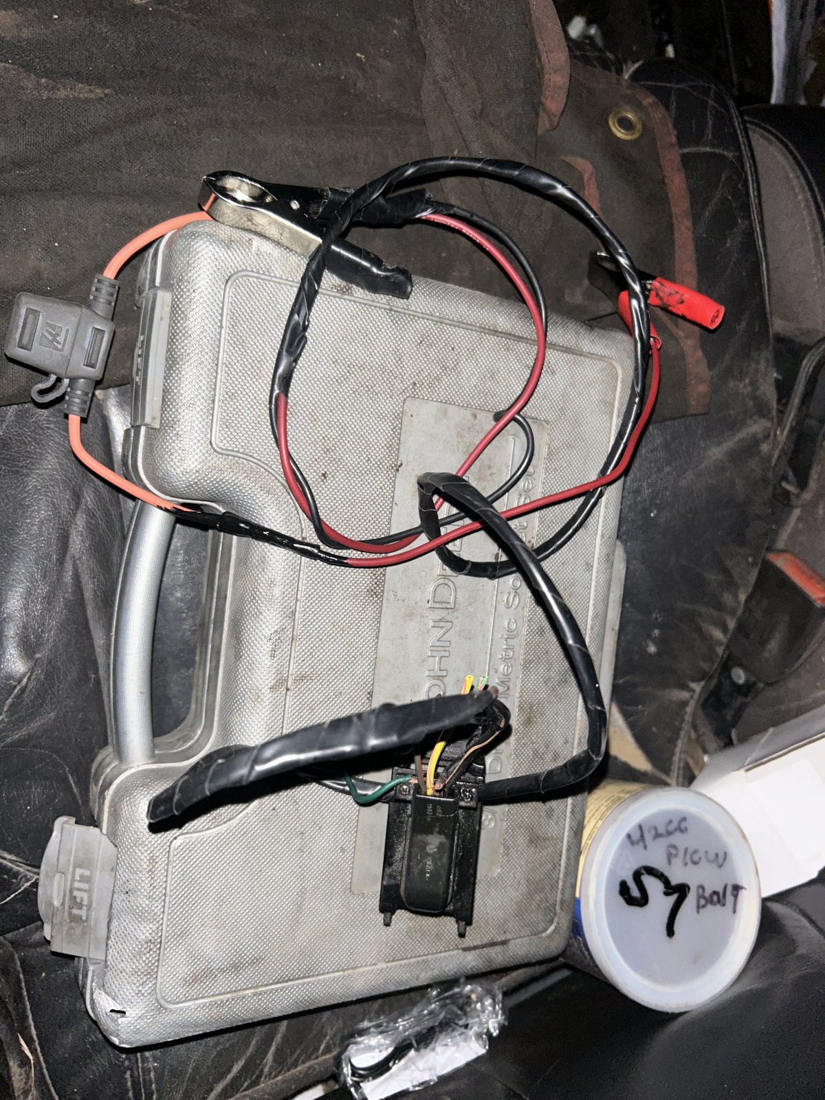

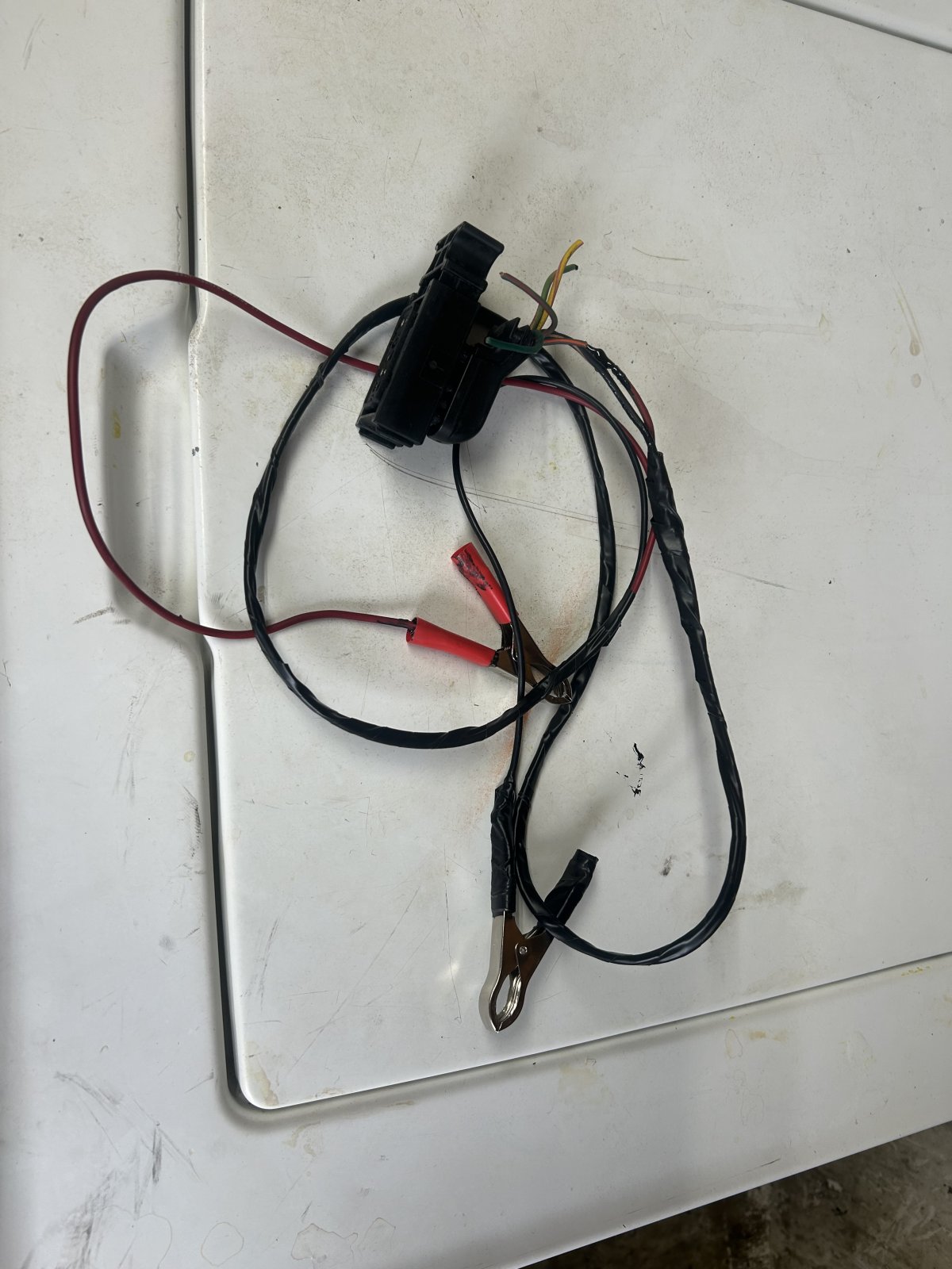

finally had to time to make a harness to supply power and ground only to the pump. The blue chip diagnostic book I printed off says that if it runs with power and ground but not with the harness hooked to the pump it’s a problem in the can buss wiring so now to reinstall the pump and see what happens

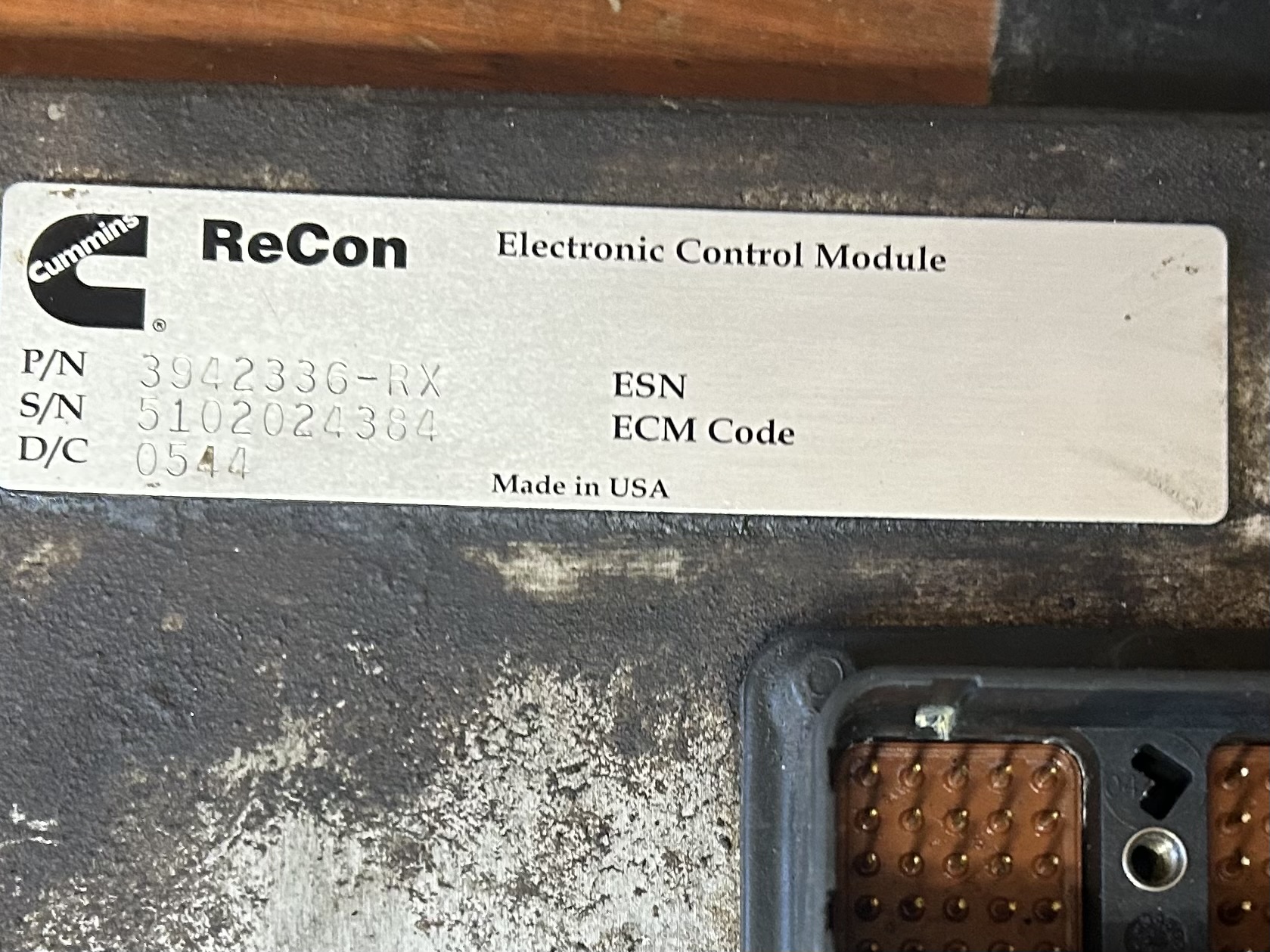

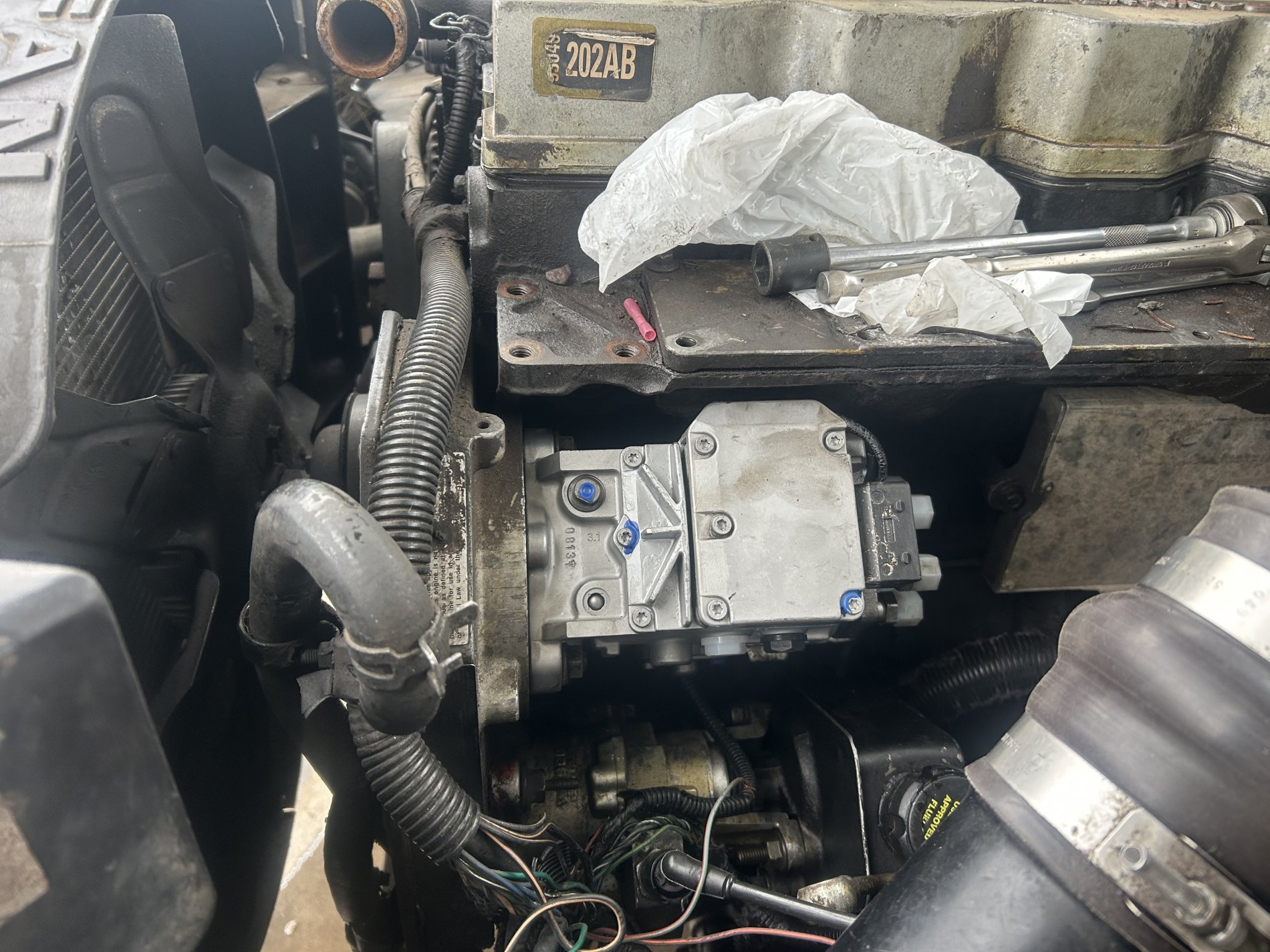

Got the pump reinstalled swapped the ecm with one from a running truck , decided might as well put a fuse in the hot wire of the test plug . Hopefully I can get back to the project and figure out something
View attachment 143093 View attachment 143092 I guess I’ve learned two things . Just because a pump won’t pump fuel doesn’t mean the pump is bad . The next thing is if you buy a pump buy one from someone who works on the trucks and knows the systems and has some background of the diagnostics on the pumps the cheapest price gets you just what you paid for .
